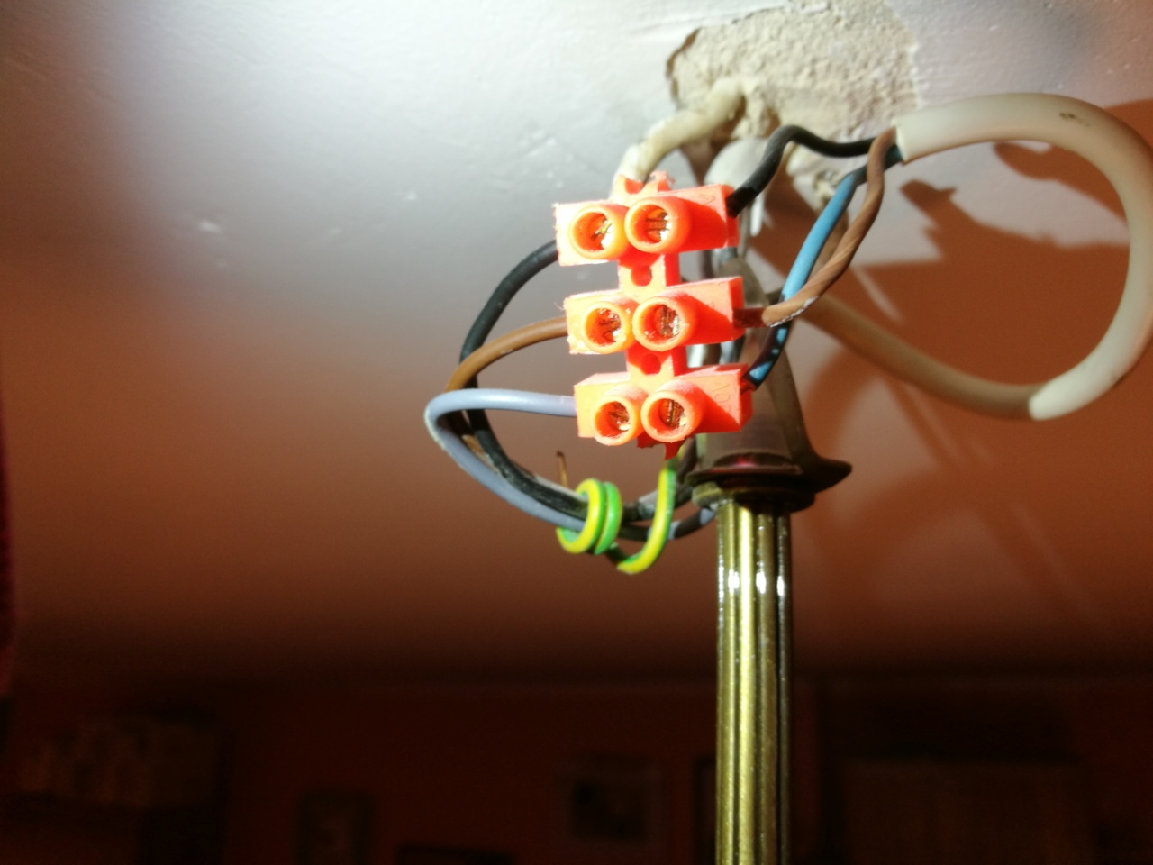

    Hello, I have a ceiling lamp for 3 bulbs. When I turn on the light, only two come on. Please write me what to do to make all 3. burn. How to connect the cables. Attached is the photo as it is connected so far. Thank you.

    See if I agree with the diagram? Connecting 3-Bulb Ceiling Lamp: Fixing Light Issues & Wiring (Photo Included)

    Do you want all 3 to be lit from a single switch? If so, leave the neutral wire (blue) as it is now, while the other 2 (black and brown) going to the lamp, e.g. under the brown protruding from the ceiling.

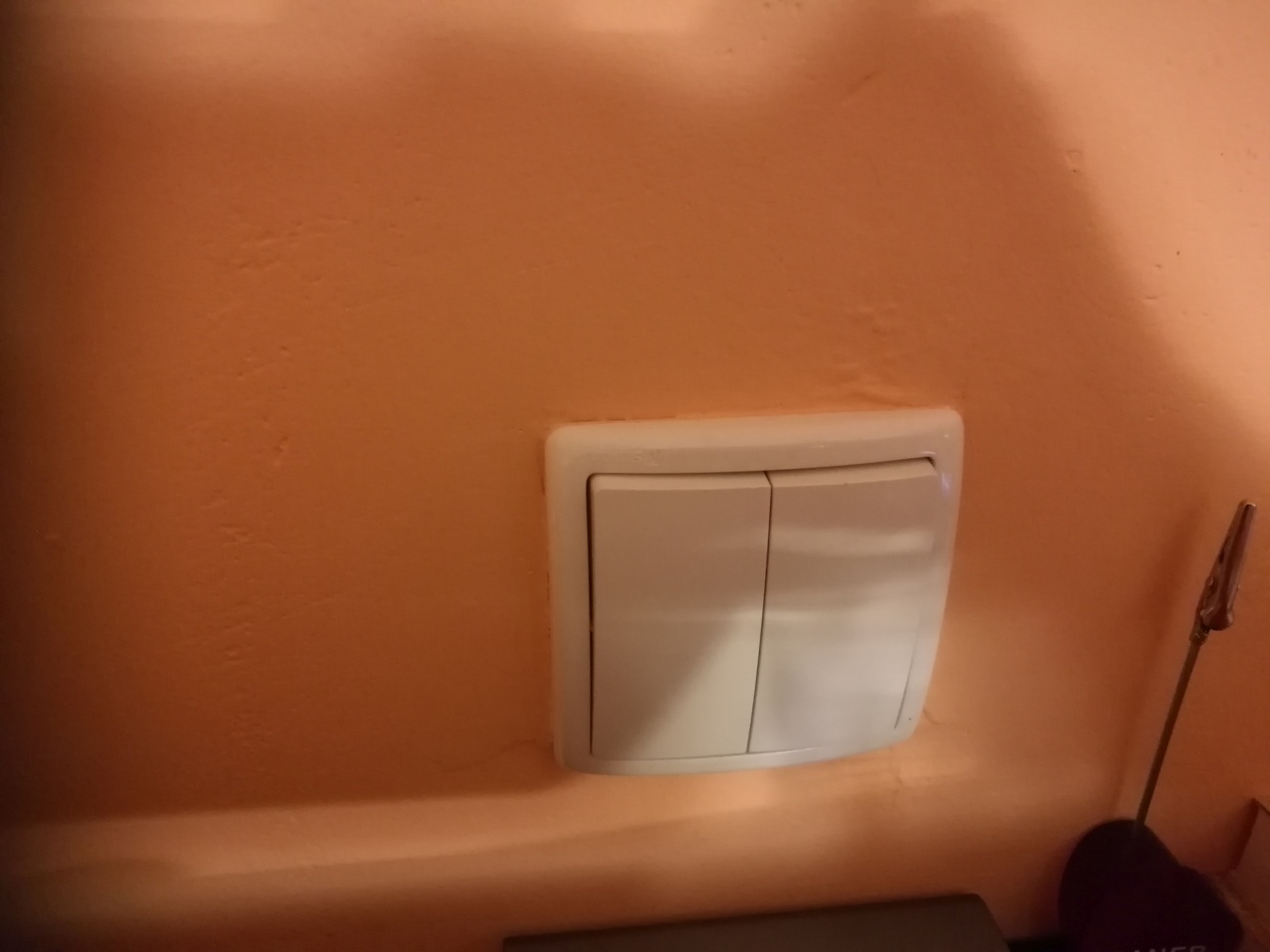

    What is the switch for this lamp. Take a photo.

    I have a double switch. At the moment, two bulbs turn on from one switch, while there is no reaction from the other. I would like one switch to be under one bulb and the other for two :)
    I'm sorry, but this pattern doesn't tell me much :)

    Is there a double switch just enough to check the color of the wires? Is that correct

    Check with a voltage tester whether the black and brown vein appear when both switch buttons are on.

    On black it appears on brown is gone

    The circuit breaker is probably defective, or it is connected incorrectly.

    Then take apart this double light switch and check its connection?

    Thanks to the fact that you wrote me to undress the switches, the problem is solved. One of the switches was not pressed and therefore one of the lamps did not light up. Thank you for your help. Greetings.
