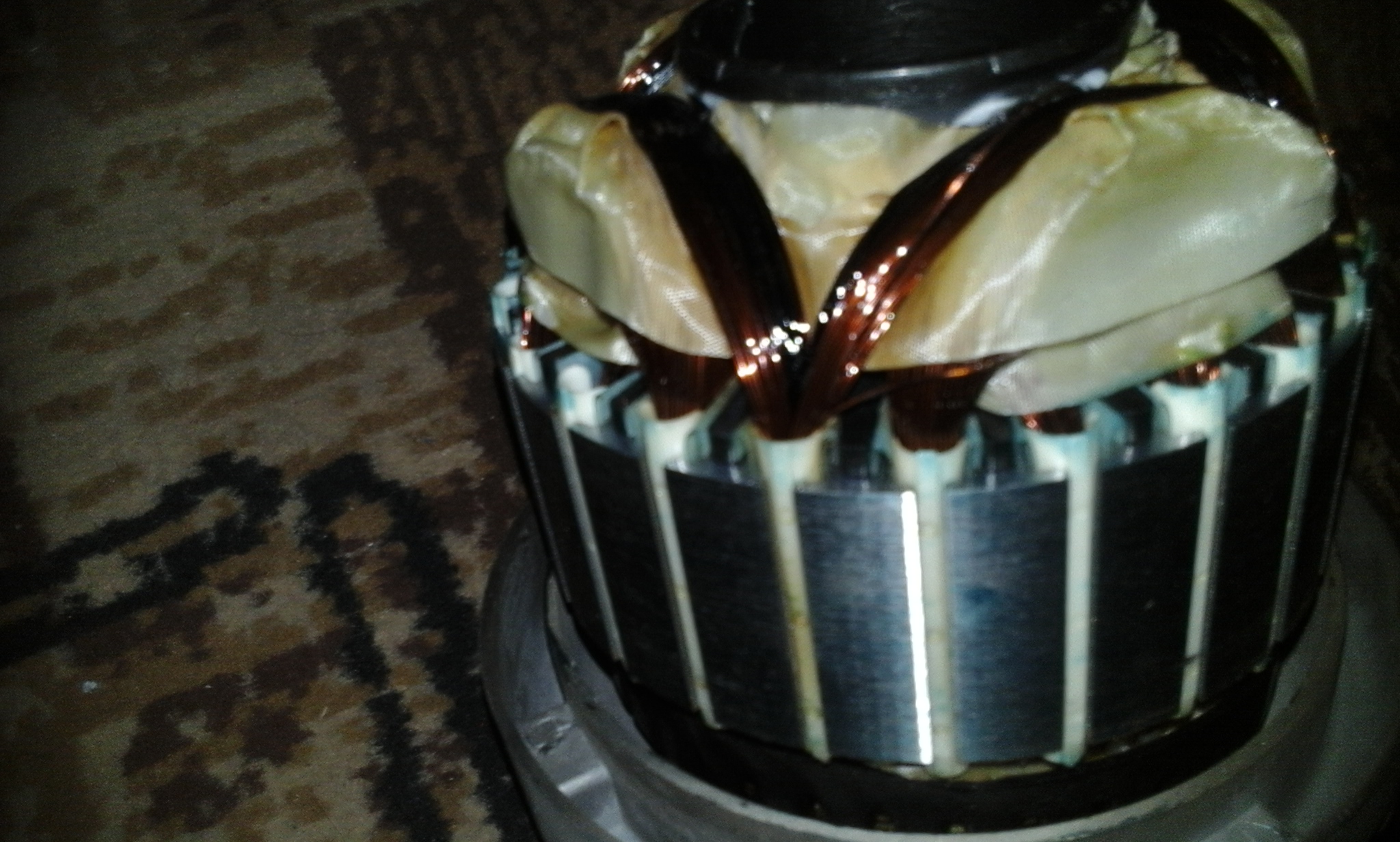

    Hello colleagues. Or maybe some of you had to deal with VTS Volcano heaters? The fan has a motor probably with a tapping winding (3 fan speeds). The engine works only at the highest speed. I am looking for the possibility of rewinding this engine, possibly a diagram, data. Please help. greetings

    the diagram does not show the windings themselves, only the connection method. There is resistance between the beginning (terminal N) and the first end (U1), the gap between the other ends (U1 - U2, U2 - U3). If the number of wires in the nursery could be counted, the problem may be in the photo of the winding diagram, because this burned "winding" is as if shifted in the nurseries. I will try to attach photos later. I was counting on the fact that someone from my colleagues used to such a miracle and had winding data. Followers want PLN 600 for such a repair, without guarantee that the number of turns can be counted in additional groups and thus the rotation speeds are the same as in the original

    Photos. It looks as if the main winding occupied 12 nurseries, and another 12 nurseries these additional windings, but I'm not sure. VTS Volcano VR3 Heater Fan Motor: Seeking Rewinding Methods and Diagrams VTS Volcano VR3 Heater Fan Motor: Seeking Rewinding Methods and Diagrams VTS Volcano VR3 Heater Fan Motor: Seeking Rewinding Methods and Diagrams VTS Volcano VR3 Heater Fan Motor: Seeking Rewinding Methods and Diagrams VTS Volcano VR3 Heater Fan Motor: Seeking Rewinding Methods and Diagrams VTS Volcano VR3 Heater Fan Motor: Seeking Rewinding Methods and Diagrams

    We also at this focus photos.

    This is what the winding looks like, as can be seen from under taping.
