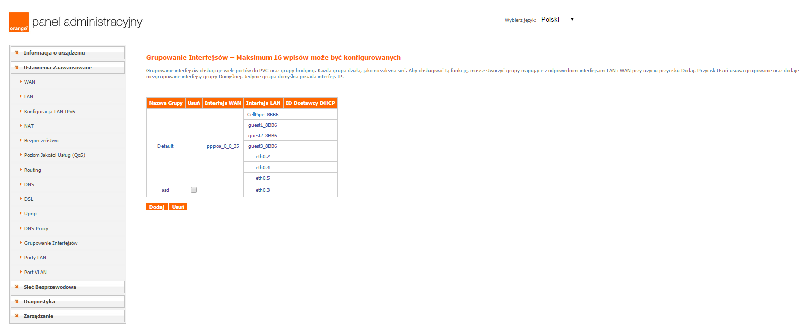

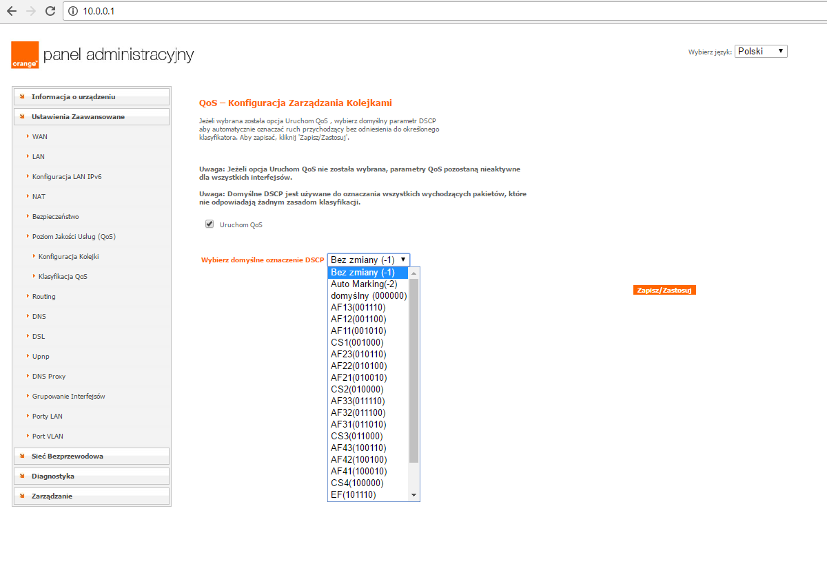

    I have a problem - I have a Cellpipie 7130 router from Orange, ADSL network. It is the main router in my home. Another Pentagram P6351 router is connected to it and my computer to it (due to the distance and the possibility of Wi-Fi network in my room). The problem is that I want to split the link so that the internet that "flies" over the cable to my router has a higher priority than for Wi-Fi from the Cellpipe router. It is very important to me. There is a QoS function in the router, which I can't comprehend for anything in the world, most of the parameter names are black magic to me. I put screenshots of settings in attachments and ask for help. I care about low ping in online games. best regards

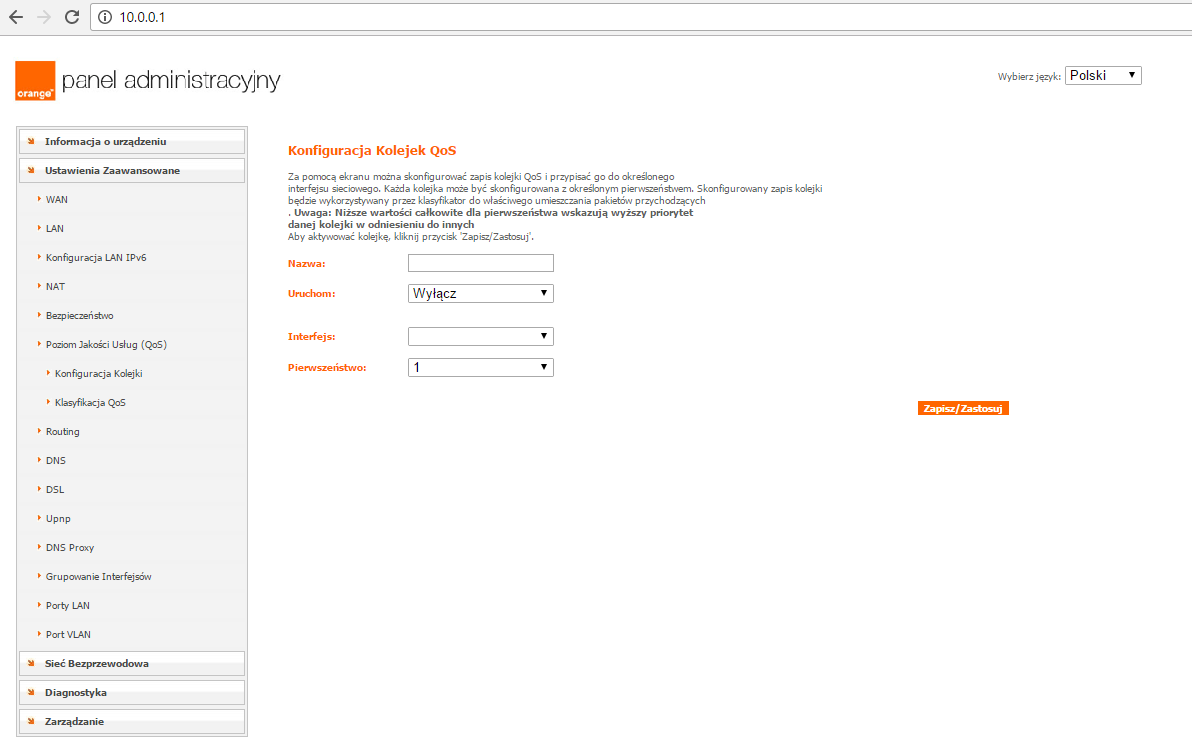

    I think you should focus on QoS queues. There you can set - from what I can see from the pictures - that it is possible to set priorities for specific interfaces, so try to give your cable priority 1, and for the wifi or other interface, a lower priority

    OK, I partially understand and thanks for the answer. The problem is that these interfaces are grouped into one. Should I create a new group and add only my LAN port there and mark the group in the queue based on that? Maximize Internet Priority on Wired Connection: Cellpipe 7130 & Pentagram P6351 Routers QoS Setup Maximize Internet Priority on Wired Connection: Cellpipe 7130 & Pentagram P6351 Routers QoS Setup

    You can create a new group of these interfaces and configure a rule for them.

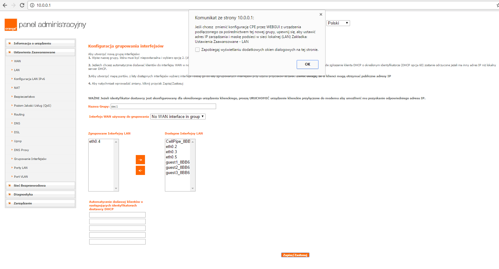

    I tried. This message pops up. Maximize Internet Priority on Wired Connection: Cellpipe 7130 & Pentagram P6351 Routers QoS Setup
    I added my LAN port and after disabling the message box, I disconnected the internet in only this LAN port. Everything else works. What is wrong?
