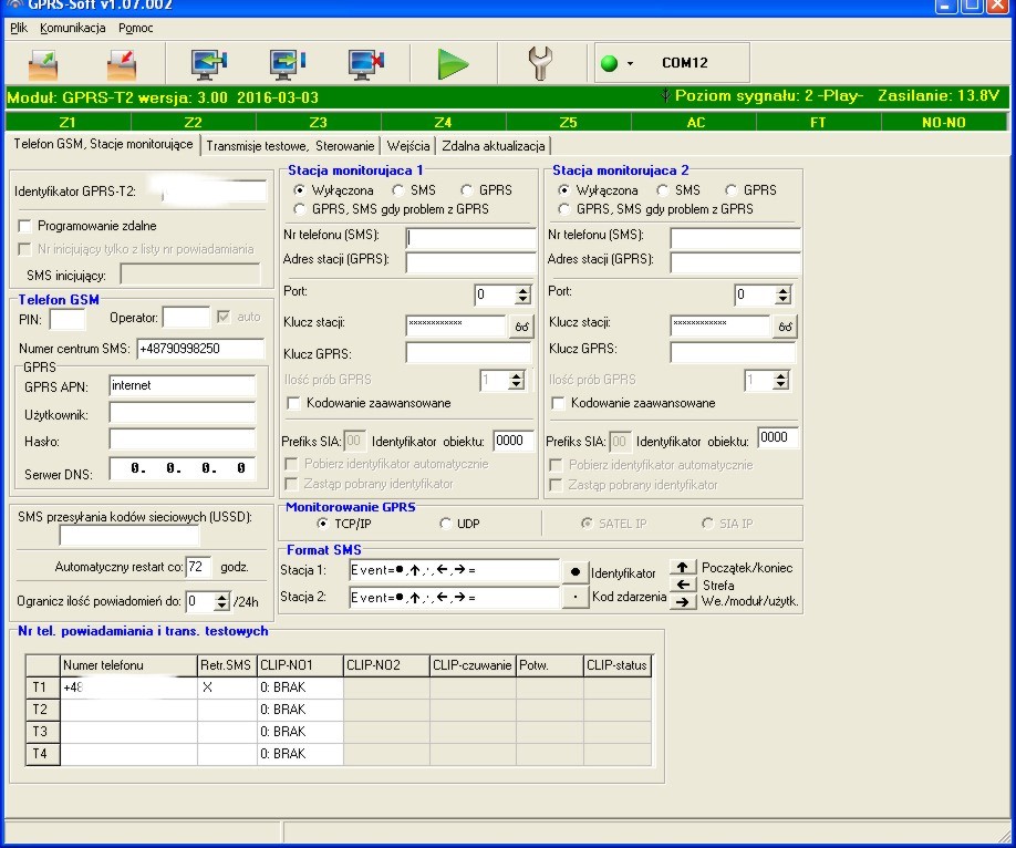

    Did any of your colleagues have a problem with the Virgin Moblie operator sim card in the #FREMIUM tariff?
    Well, the situation is that when setting the SMS center +4879099850 the module does not send SMSs, but only tries. The CLIP option works. Signal level 2.
    After inserting the borrowed card from PLUS GSM and changing the SMS center, everything works properly.
    Is Virgin Moblie not suitable for GPRS-T2 module?
    Alternatively, what operator do you recommend and with what fees?
    There should be 790 998 250.
    This is just my mistake in posting.
    That's the configuration. Could there be a coverage problem?
    Are prefixes possibly +48 or +048?

    And I have a question. Why do you put in the control panel the GSM virtual operator card, which always has the lowest priority in the BTS network?
    Buy an Orange card, send a text message START to the number 8002 (year of account validity), insert the card into the module and after trouble.
  • Virgin Mobile SMS center number corrected to +487909986222
    Subject taken care of. Problem with the SMS center. New cards are on the number:
    +487909986222
    It may also be useful to someone. Unfortunately, the VM service does not know that they have a different SMS number.
