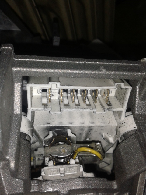

    I have a Bosch washing machine motor, I would like to connect it, but I don't know how.
    In the picture of the cube there are 6 pins from 2 to 7, the numbers in the cube 1 and 8 have no pins.
    Please write how to connect this motor.
    Handheld meter and you will find everything.
    What do you want to use it for?

    Stator windings in series with brush holders. Note the beginnings and ends of the windings. Note two, the engine without load will likely run wild and crash

    These types of engines have high RPMs (typically 13000-18000rpm). Without load, there is a risk of the engine spinning (jerking up dangerously high and destroying the engine).
    The manufacturer of the putty writes about stabilizing the turnover. Forget about it. The revolutions stabilize when the system reads the signal from the tachogenerator. And so the revolutions will depend on the supply voltage and load.
    This motor has 6 pins: 2 stator, 2 rotor and 2 tacho. You connect the rotor with the stator in series and power it up. You just need to use the meter to find what is what.
