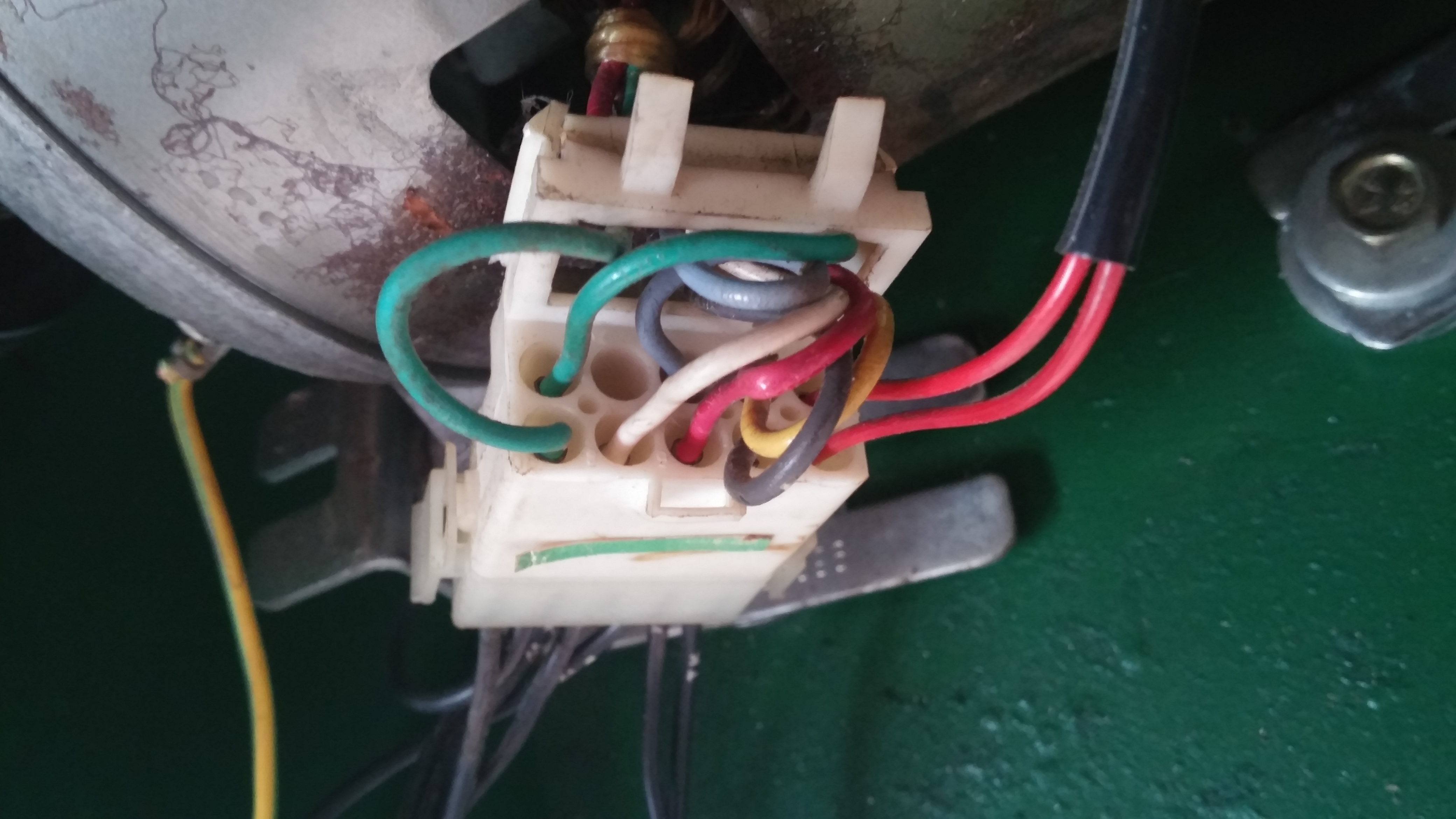

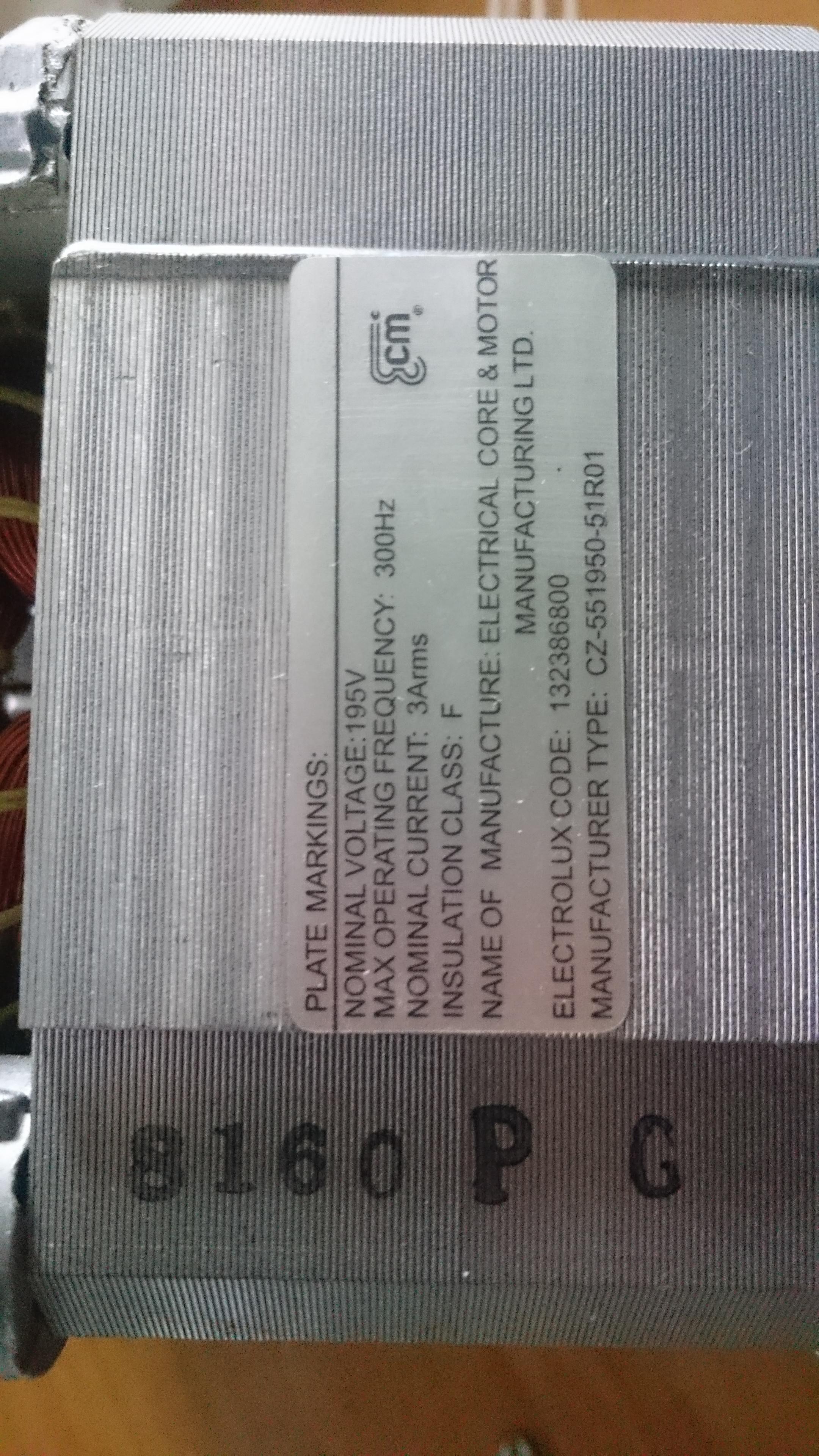

  • #3 16486428
    darkavvenger
    Here are the photos, the parts come from the electrolux washing machine production year 2008/9, as to the type of engine from the construction site, it is concluded that it is three-phase.

  • #4 16486444
  • #5 16486461
    darkavvenger
    The inverter itself is a white box next to it, 230V is connected to it, but the motor is controlled using 5 cables going to the programmer and here is the layout and what can be connected to to move the motor shaft

    #7 16486627
    #8 16486645
    jack63
    Posts: 11792
    Help: 851
    Rate: 2822
    Christophorus wrote:
    The fact that the motor has several cables led out does not necessarily mean that an inverter is needed to start it.
    I support.
    Most likely it is a BLDC motor. It cannot be started without the matching power supply. Giving power to 3f it will be burned.
    To be sure, look for information on the manufacturer's website. And the easiest way is to "open" it. If the rotor is a strong magnet, then BLDC.

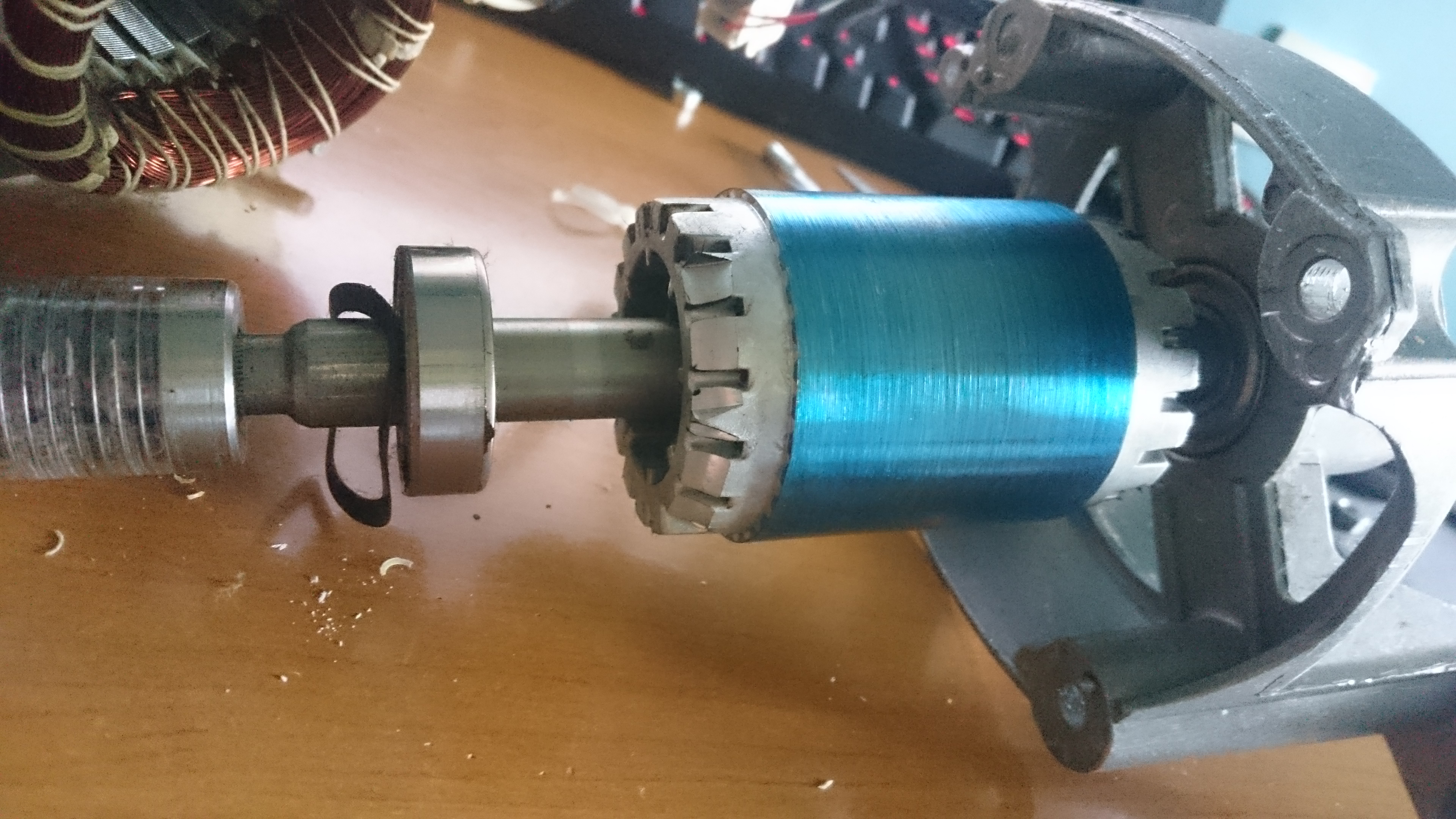

  • #9 16486657
    darkavvenger
    I will open it and let you know what came out :) As for the old woman, the cubes have not been cut, so the only thing left is to control the system
    Added after 13 [minutes]:
    disassembled very easily, the rotor looks like in the picture the winding too Starting Electrolux Washing Machine Motor Without Programmer: Cable Configuration? Starting Electrolux Washing Machine Motor Without Programmer: Cable Configuration?
  • #10 16491034
    jack63
    Posts: 11792
    Help: 851
    Rate: 2822
    It looks like an ordinary induction motor. There is something (?) Inside the stator that could be a rotor position sensor.
    You did not answer the question about a possible magnet in the rotor.
