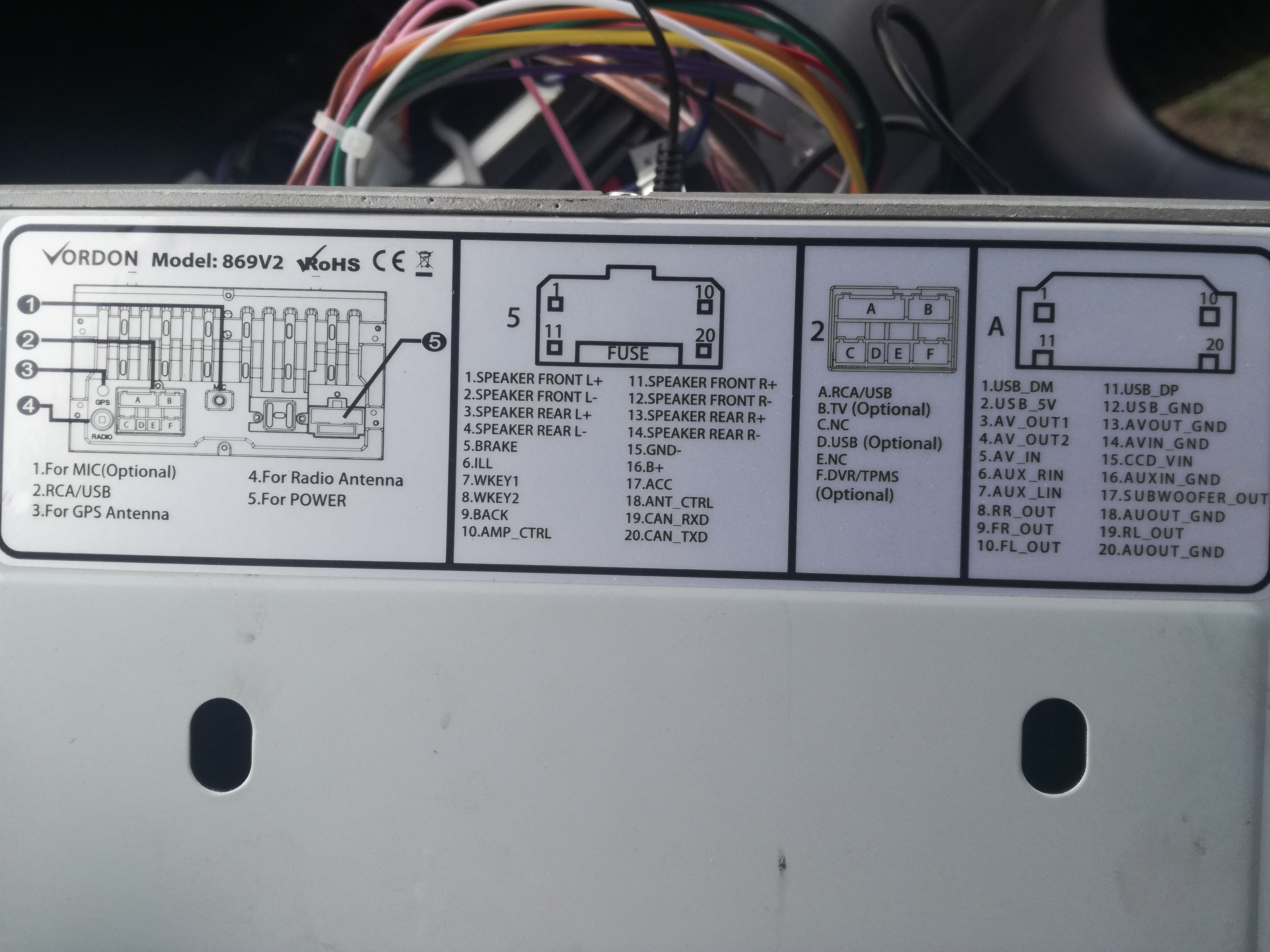

  • #6 17259986
    PanTera123
    Question for a million dollars where in the attached photo is the input for the signal from the reversing camera?

  • #7 17260022
    milejow
    Posts: 13083
    Help: 1560
    Rate: 5138
    Signal pin 15, ground pin 14 bones ,, A ,,

  • #8 17260112
    PanTera123
    I have already tried this option but the only thing that displays when throwing reverse gear is: no video input

    milejow
    Posts: 13083
    Help: 1560
    Rate: 5138
    If the radio switches itself to the signal from the camera after turning it back on, the problem lies with the camera, cables or the radio itself because there is no other input on the camera. Did you check the camera itself?

  • #10 17417972
    junnon67
    Camera power can be obtained from the reversing lamp.
    The video signal from the camera flies through the cinch to the CCD_VIN input (pin 15 in the white cube).
    When driving reverse into the Back input (pin 9 in the black cube), a positive signal must be given from the gearbox switch.
    I gave + 12V from the reversing lamp on the cable (not very aesthetic but works).
