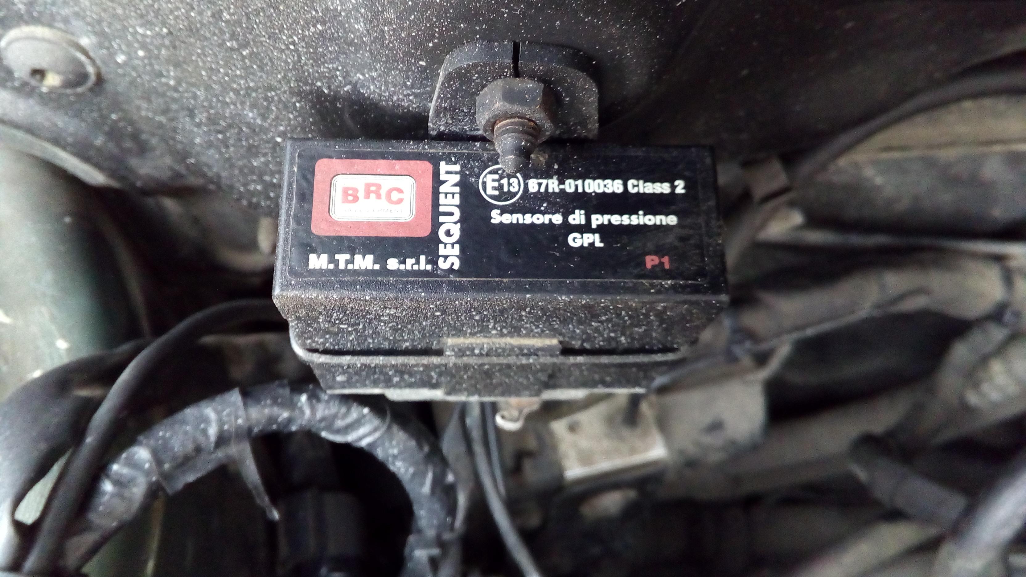

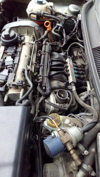

    Show what you have under the hood, show where the hose from the LPG gas reducer goes.
    The 4th generation of LPG should already be there, which is just such a possibility.

    The indicator showed a reserve for a long time, because as I wrote earlier when refueling the gasoline one time, the distributor bounced, so I thought I had a full tank, and the indicator shows badly and I just ran on gasoline, until at some point when I tried to start the car it did not could ignite. Then I thought that maybe the gauge shows the level of gasoline well, so I added a little bit and then it fired immediately, then I went to fill up and there was less than 50 liters of gasoline and now the gauge shows a full tank. I did 130 km on it yesterday and the needle did not move, even though I was overtaking a few times at high revs.
    Added after 2 [hours] 18 [minutes]:
    And this is what it looks like under the hood:
    Seat Ibiza 1.4 petrol + LPG - gasoline pointer dropping despite driving on gas Seat Ibiza 1.4 petrol + LPG - gasoline pointer dropping despite driving on gas Seat Ibiza 1.4 petrol + LPG - gasoline pointer dropping despite driving on gas Seat Ibiza 1.4 petrol + LPG - gasoline pointer dropping despite driving on gas Seat Ibiza 1.4 petrol + LPG - gasoline pointer dropping despite driving on gas

    It all depends on the ECU, there was no problem in the factory, perhaps there is already a correction of the amount of fuel from the mileage and you need a fuel level emulator. Each sequential installation can use gasoline, if the gas engine says it is not possible, it would have to be changed.
    It's nice that someone improved the manifold and the injection assembly - you can see the plugs.

    This is the equivalent of Fabia.
    I have not met yet so that it is like in the French here.
    He would mount a potentiometer, set it, ride it and it would be known.
