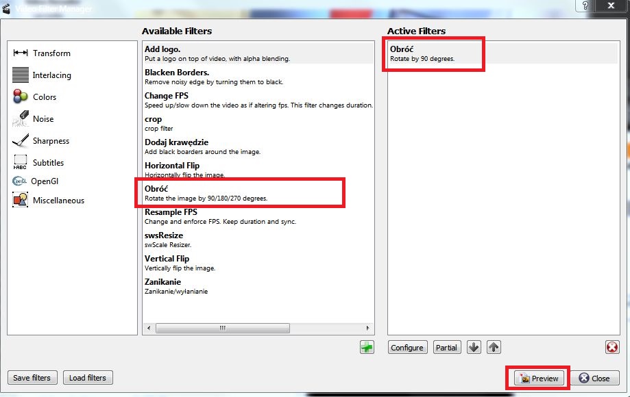

    Hello, this time I have a problem - I have films from a skiing trip in Austria, recorded by phone (mp4, 1280x720), and cool, I can watch them on the phone and on the computer, but after connecting to the TV, the image is inverted 90 degrees - what is this to convert to watch normally?

    Avidemux mastered?

    Why convert the whole movie as you can rotate it without conversion, e.g. with Free Video Flip And Rotate
