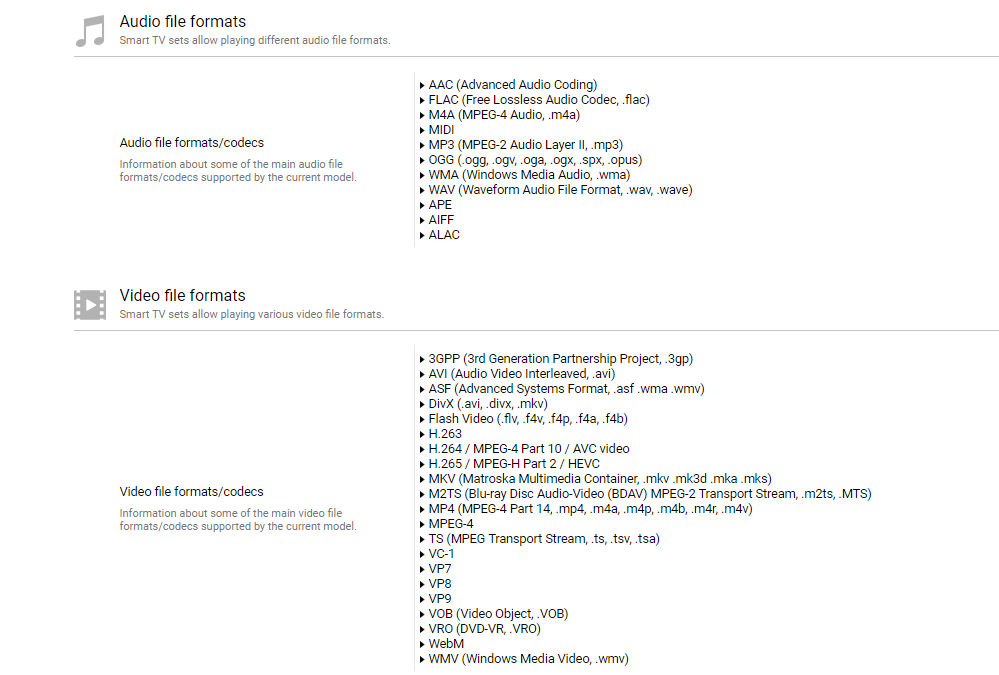

    Series 7 (7100/7122) supports
    Samsung UE43NU7122: Unable to Play Movies from USB - Unsupported File Formats & Solutions
    Built-in media_player supports
    AVI, MKV, H264 / MPEG-4 AVC, MPEG-1, MPEG-2, MPEG-4, WMV9 / VC1, AAC, AMR, LPCM, M4A, MP3, MPEG1, L1 / 2, WMA, JPEG, BMP, GIF , JPS, PNG, PNS
    3 x HDMI 2.0
    2 ? USB 2.0
