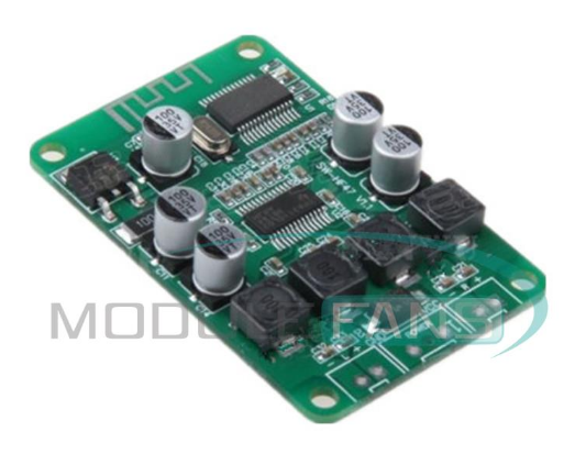

    Hello, I want to make a portable tube for music, I want it to have 2 speakers or one woofer and 2 tweeters, something like JBL Xtreme, I found the TPA3118 chip on aliexpress
    technical data:
    Audio input: Wireless Bluetooth
    Max. Receiving Distance: 10M
    Output power: two-channel 15 W + 15 W
    Application Speaker Impedance: 4/6/8/10 ohm
    Supply voltage: DC 10-25 V (More than 2A recommended)
    Power Interface: 2.54 * 3PIN
    Speaker Interface: 2.54 * 2PIN
    PCB Board Size: 58 * 38mm / 2.3 * 1.5in
    weight: 14g / 0.5oz.
    I do not know if I can handle such a tube with such a system, so I want to know what amplifier for such 4 speakers, I have not bought any speakers, I found old speakers from Logitech in the attic, so maybe they will be useful because they are tweets, they are not given anything so it is hard for me to specify how many ohms they are, I have no idea where I can embrace such 15 watt woofers for such portable equipment.
    Adds a photo of this layout from ali ;)
    • What amplifier with bluetooth to build your own wireless speaker 1231.png (265.89 KB) You must be logged in to download this attachment.

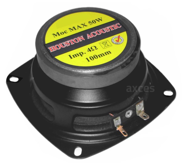

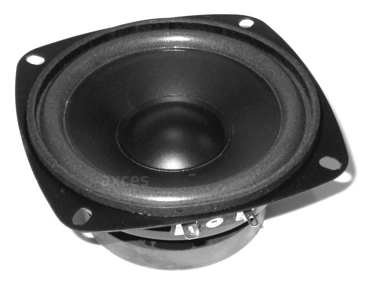

    Right, I'm going to buy cells so that I can charge such equipment at home, so that the cells reach about 22v and 10AH, I also found some 2 bass speakers 4 ohm 30w rms 50w max
  • #6 16275610
    szymon122
    Posts: 4094
    Help: 302
    Rate: 762
    Show them.
  • #7 16275631
    xerden10
    Posts: 20
    Something like this, found on the allegro
    • What amplifier with bluetooth to build your own wireless speaker ha4004-10cmb.jpg (64.4 KB) You must be logged in to download this attachment.
    • What amplifier with bluetooth to build your own wireless speaker ha4004-10cm.jpg (49.41 KB) You must be logged in to download this attachment.

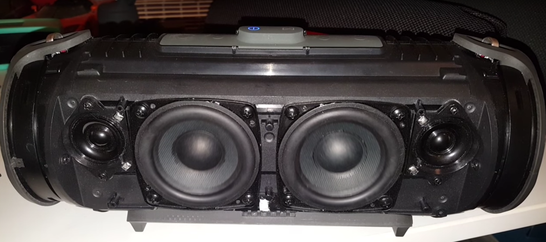

    I want such a tube to be easy to carry and look something like this jbl
    • What amplifier with bluetooth to build your own wireless speaker jblxtreme.png (2.27 MB) You must be logged in to download this attachment.

    As it has with 30 RMS it's a success. And the performance probably barely 80dB. Typical quinoline Not suitable. I told you to search for broadband.

    I watched this JBL, it has two loudspeakers, each has a good 10mm swing and two passive membranes on the sides, it works so well that the parameters of the mounted speakers are known and as a result the required housing could be calculated.

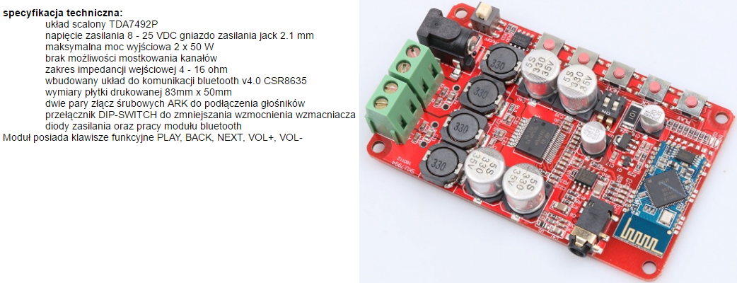

    I will think about this, I will probably use some pvc pipe to make a tube, I also found another decent bluetooth amplifier
    • What amplifier with bluetooth to build your own wireless speaker 33333333333333333.png (445.12 KB) You must be logged in to download this attachment.
  • #14 16275801
    Mac.Gyver
    Posts: 56
    And what is this module better than the previous one? The amplifier is not the most important element. The most important is the speaker and cabinet.
