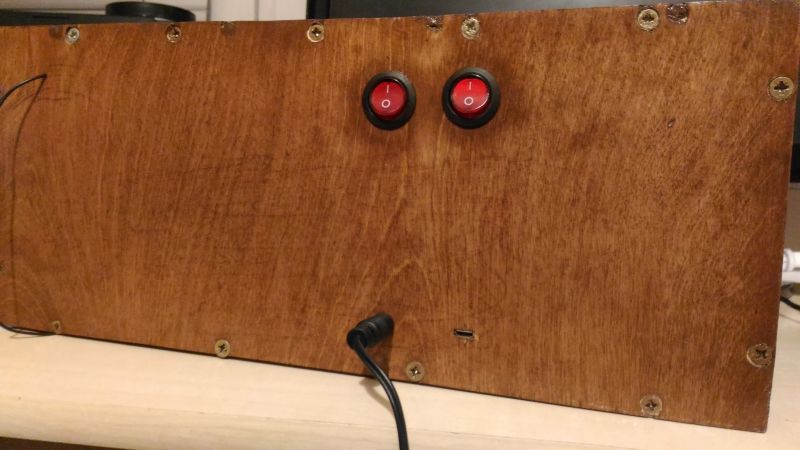

    - another thing is best to put all the electronics on the back of the speaker housing, after unscrewing we have everything on top and there is easy access to each module, I at first hid everything inside but finally mounted on the back (except for the battery),

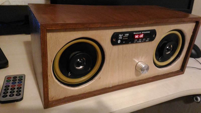

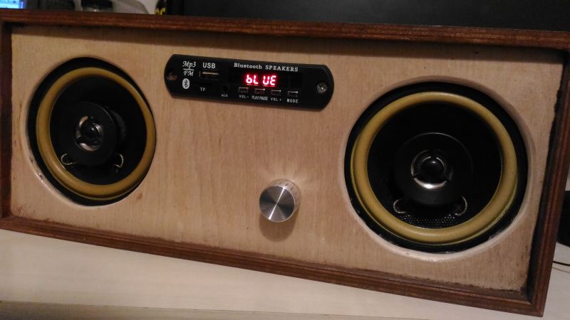

    And a few photos with the effect:
    Construction of a bluetooth speaker with mp3 player. Connection method. Construction of a bluetooth speaker with mp3 player. Connection method. Construction of a bluetooth speaker with mp3 player. Connection method.
