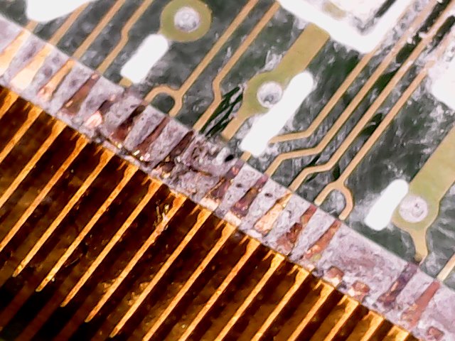

    Welcome to the TV, there is a voice, the matrix lights up but there is no picture content, there is nothing, the power supply voltage is all correct. When switching on, the LED blinks red twice, the backlight, voice and so on. Logic power supply 12V, fuse OK, which may be the reason for this behavior. Greetings!

    The matrix is HC390DUN-VCFP1-21XX. When the left tape is removed from the matrix, half the screen is white, the right one is the other half white and on the other side after pressing the menu for example colored vertical stripes appear. I measured the T-CON.
    VAA-17,7V
    VGH-20V
    VGL - (- 7,94V)
    STV-0,44V
    VCM CF-7.82V. VCMTFT the same
    V1V2-1,2V
    SDA 3.3V
    SCL-3.3V
    UP4-3,3V
    UP2-1,2V
  • #8 16281575

  • #11 16294749
    krzychu001
    Posts: 384
    Help: 11
    Rate: 204
    Ok, the matter is clear, the matrix for scrap metal, damaged tapes, by washing the matrix with some wonderful liquids, the tapes are from the bottom and everything that flows on the screen poured straight onto the tape and plate connection and ate everything nicely.
    The topic can be closed. Regards !!!
