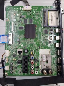

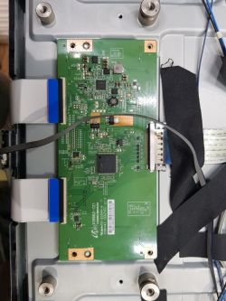

    Hello, as in the topic I have my TV set for repair with damaged backlight. After repairing the backlight, I regenerated the tape and it was ok.
    It worked for a few days and I do not know if it was an earlier or now defect, the backlight works and does not display the image.
    After correcting the tapes, at least I think so, he got up for one more day, I thought it would be ok, so I corrected the tapes, I folded it, it worked day and suddenly it died again.
    The backlight rises, the red diode blinks three times and then there is no image, startup logo or anything else in further work.
    The tested power supply looks ok. The boards respond to voltages, but we do not have a picture, I do not know where to look.
    The patient is waiting for your help
    What to measure to facilitate diagnosis.
    Just by eye?
    AdamQuatro wrote:
    the plates react to the voltage but
    What?

    The power supply gets up because the backlight works, the power LED blinks red 3 times and goes out but there is no picture.
    No bulging capacitors when it comes to eye checking, but I don't mean to prove who is the best, where to start the measurements and where to look for the fault.
    When I was young, this website worked in its further development, people blasphemed more than they helped.
    I am not a specialist, so I ask where to put the meter and what to check, what to pay attention to to find a solution to the problem.
    Thanks in advance with a serious reply.

    You have the voltage values on the laminate.
    If they are correct, check F1 first.
    And don't demonize, because you are probably still distracted.

    >>17005617 У меня было такое, возьми провер на маличие холодной пайки по шине 12 вольт в блоке питания. Проверь наличие 12 вольт в блоке питания на разьеме подключения шлейфа идущего на MB/
