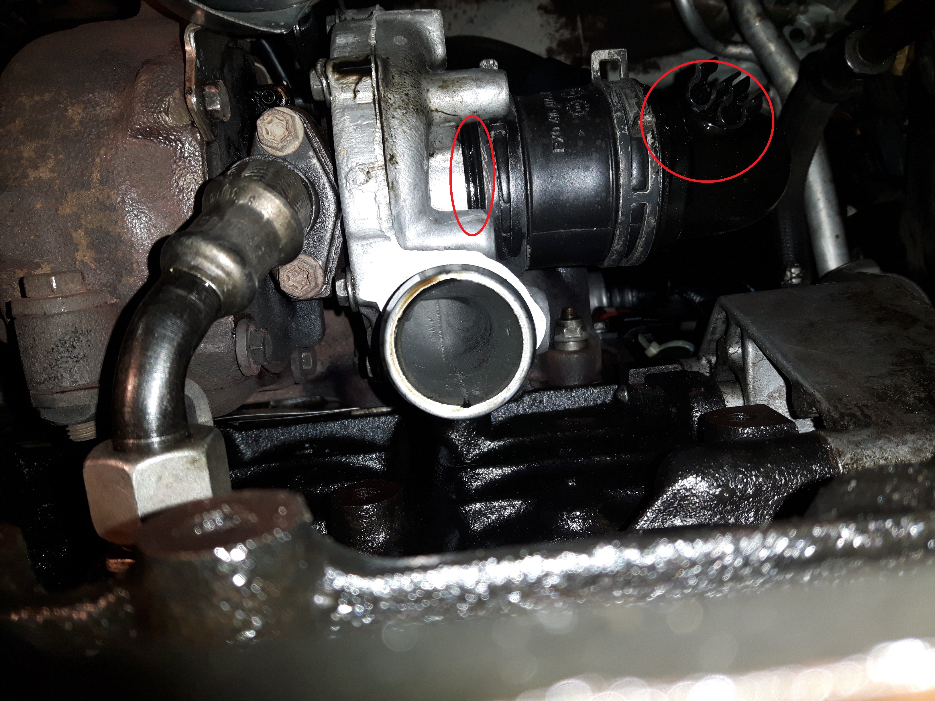

    I have an Audi A3 1.9TDI 74kw from 2001.
    I cleaned the variable geometry of the turbocharger because it went into service mode / seared steering wheels.
    In addition, it turned out that the turbine actuator was damaged, i.e. it did not hold the pressure.
    I managed to clean everything and fold them together.
    Impellers do not have any play.
    I replaced the actuator with a new one and set it with a vernier caliper in accordance with the previous one.
    After the operation the car does not enter the service mode and speeds up nicely.
    Unfortunately, I'm worried about her whistle that had not occurred before.
    After starting the engine occurs after about 8 seconds, then the steering wheels are certainly set to MAX.
    [Film: 53aeb3a3d6] https://filmy.elektroda.pl/12_1487190651.mp4 [/ film: 53aeb3a3d6]
    Can actuator regulation help?
    Possibly how to approach the subject and what may be the reason for excessive "howling".
    The car has no catalyst.
    The car started smoking blue
    [Film: 53aeb3a3d6] https://filmy.elektroda.pl/96_1488323176.mp4 [/ film: 53aeb3a3d6]

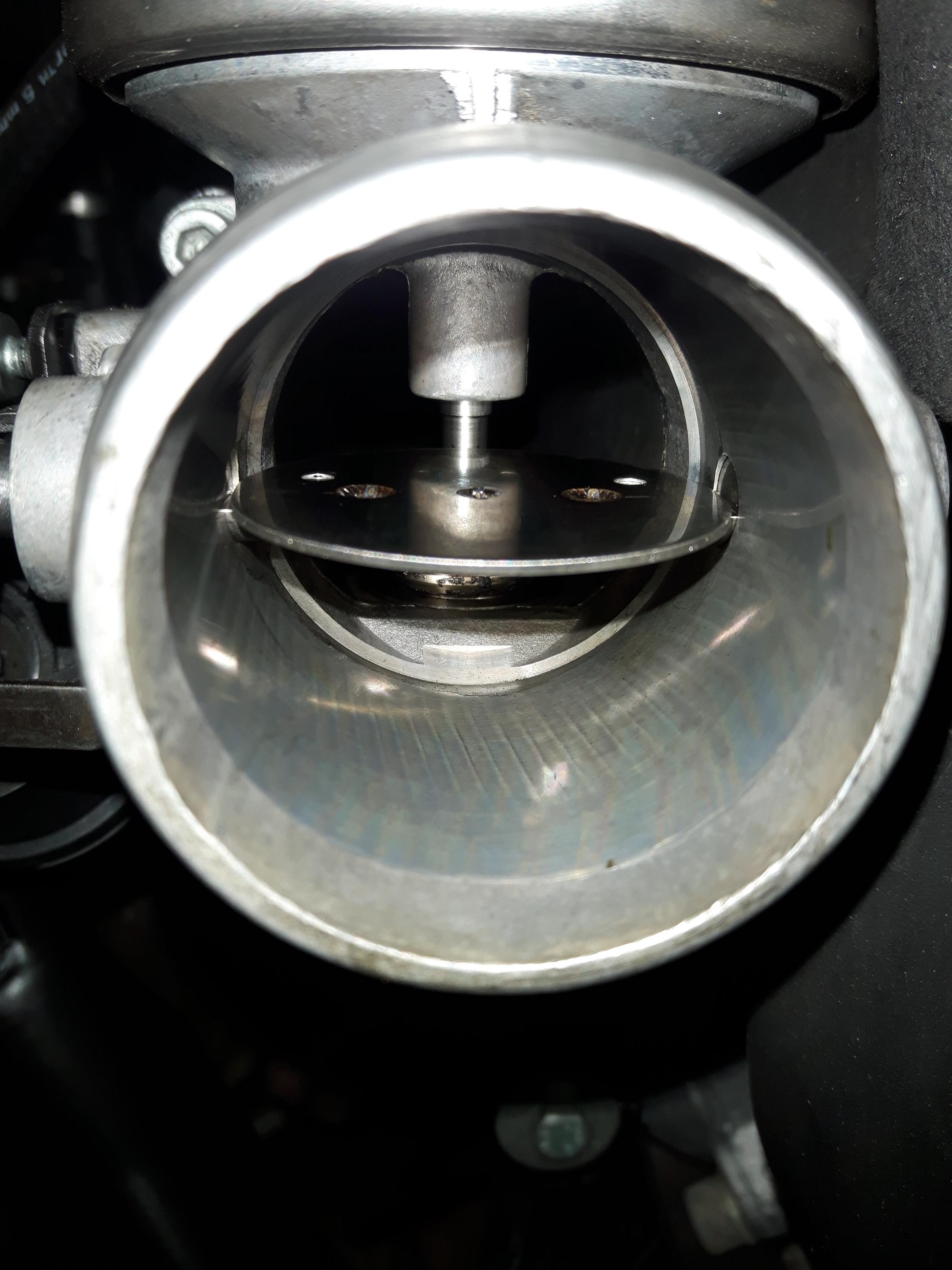

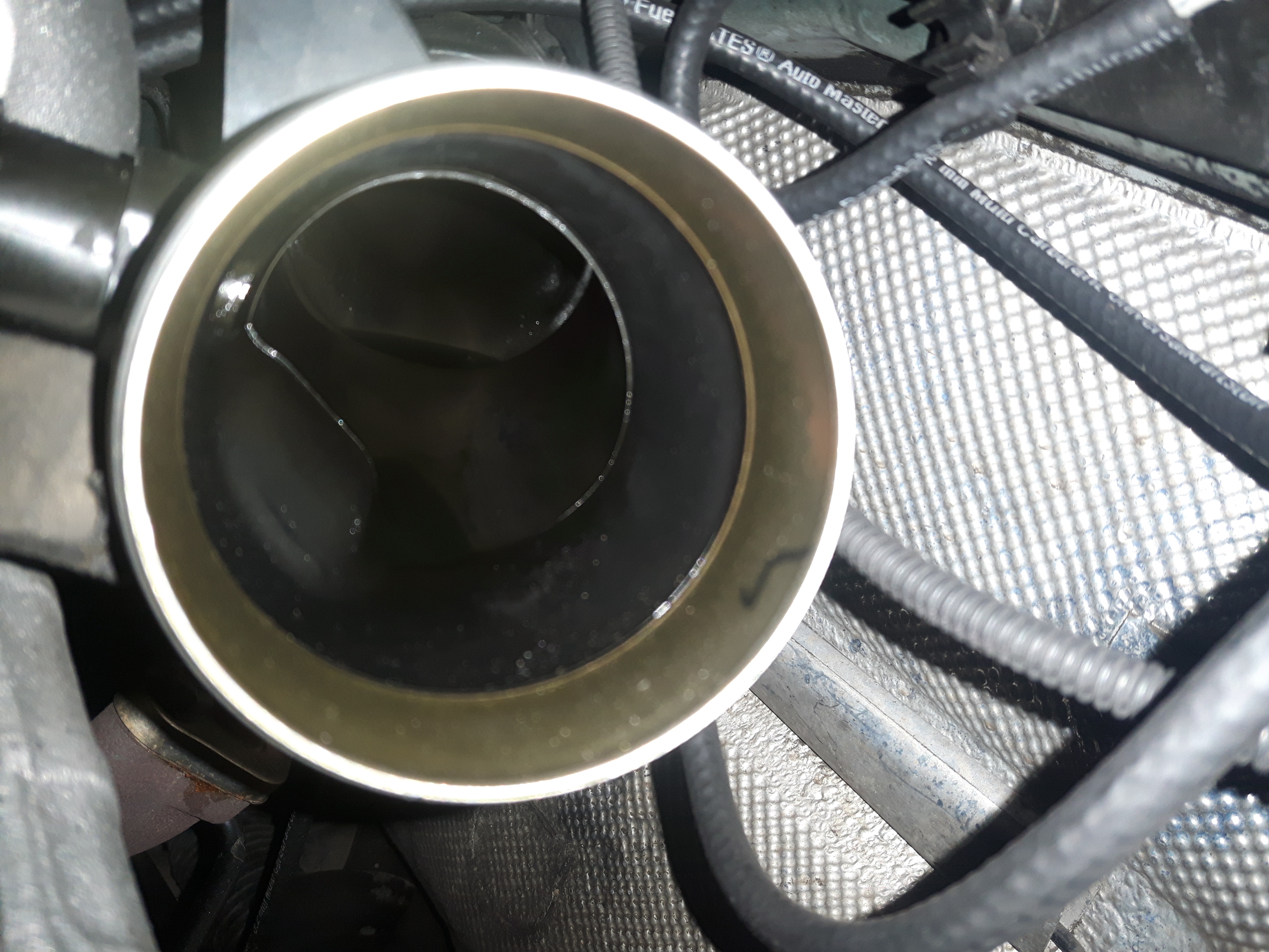

    I thought that it was letting the turbine through, however, after dismantling the EGR elbow
    Audi A3 1.9TDI - Disturbing whistling of the turbocharger at idle
    And a look at EGR

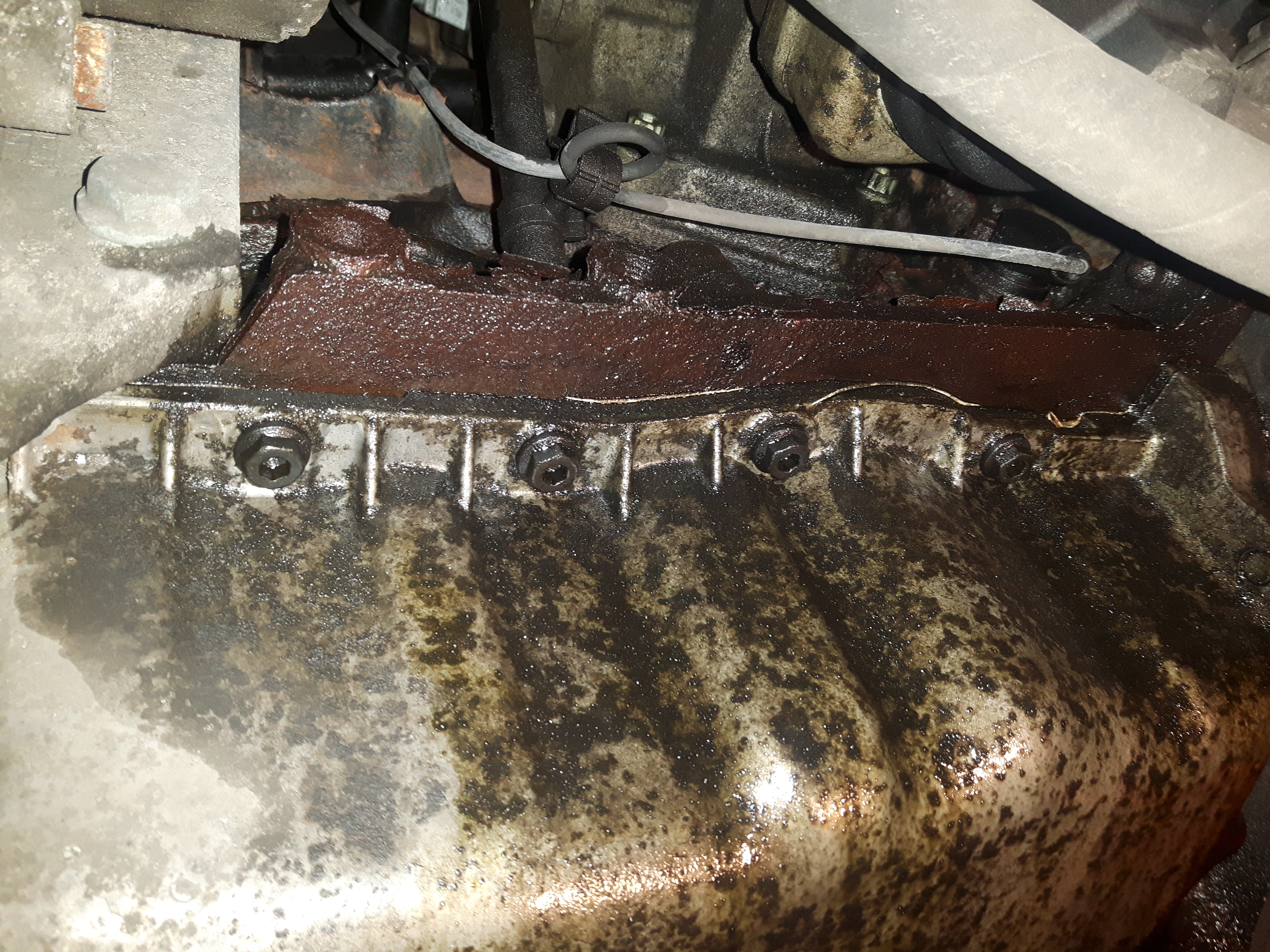

    Well, unplug the pipe that goes to the IC dry - only where I marked in red is oil
    Audi A3 1.9TDI - Disturbing whistling of the turbocharger at idle Audi A3 1.9TDI - Disturbing whistling of the turbocharger at idle
    Does Odma give such symptoms?

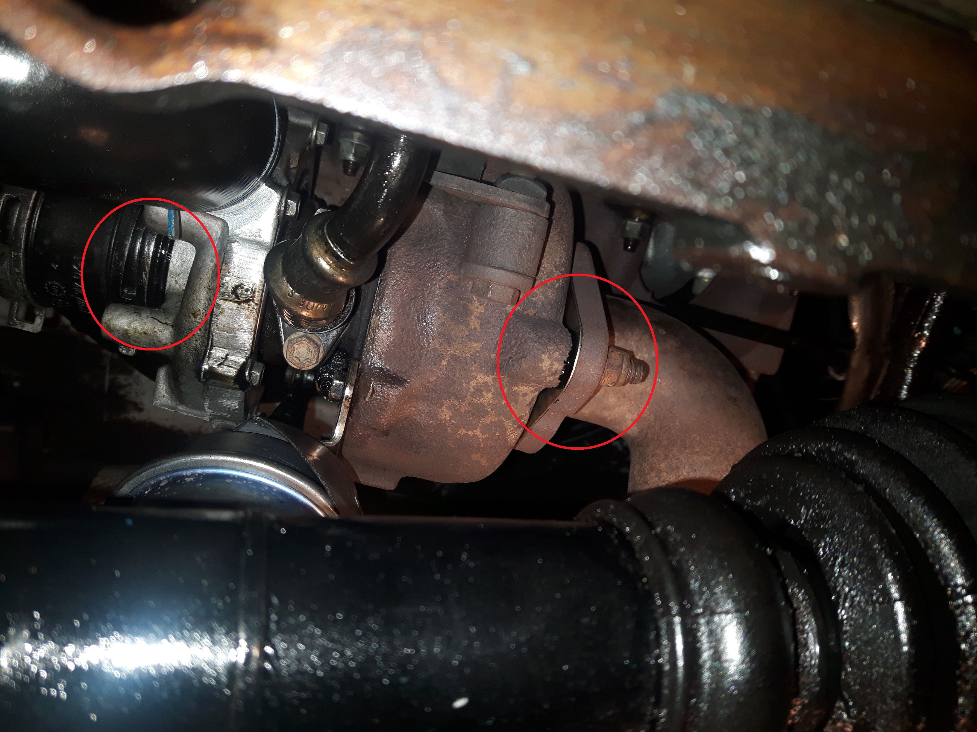

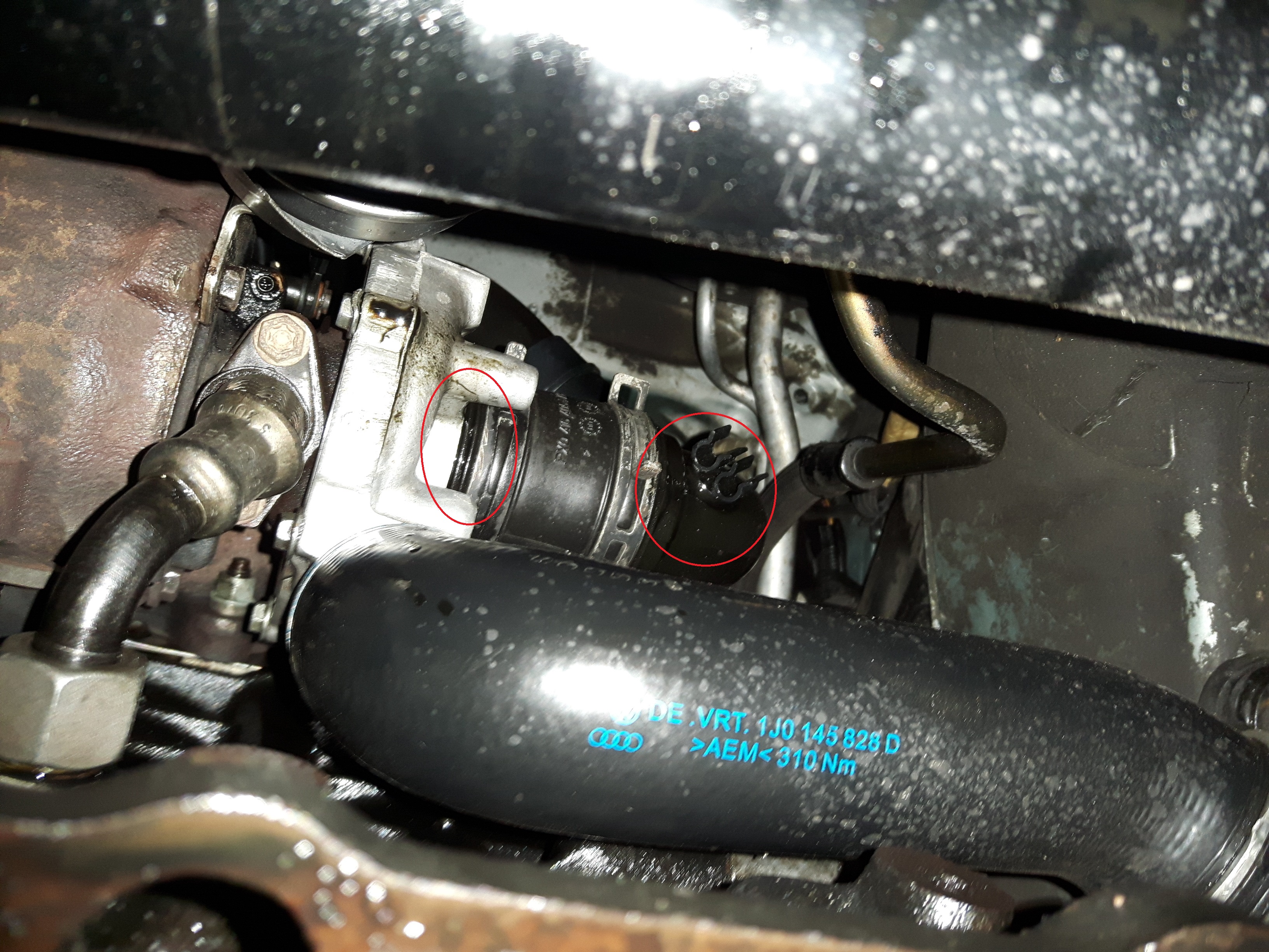

    I noticed that in the place where he was a catcher and currently the pipe appeared oil - as if leak from a leak.
    Currently, I leave clouds of blue smoke while driving - and the oil drains out.
    And I see that in the inflow, i.e. the broken pipe that goes from the air filter / connects with the refuse and zips on the part of the cold turbine - it is moist.

    Odma is not guilty of wind turbine cutting - this is one of the signs of its wear. The hoot is usually either a hole in the intake, or just destroyed turbine bearings and rotors start to whistle, losing balance.
    Rick69 wrote:
    But should not the oil be in the IC or in the pictures in this case?
    In the pictures, the circuit is probably sucked in so if it was a turbo, it would be wet?
    And if it lets go only the hot side, it all goes in the exhaust, the intake will be clean. Did not you hit the rotor when cleaning?

    Some time ago I cleaned the variable geometry of the turbocharger because the car caught the proverbial notlauf. It turned out that the pear was also a replacement. After cleaning the entire deposit, including the entire intake, Icek, EGR and all pipes and putting up to 300km was ok. Turbine began to operate in full range and whistle. Unfortunately, the car started to smoke and actually it is blue. I came back to the subject and what turned out .. I bought a car without a kata and in a place where it should be leaking oil .. So I suspected that the turbo lets go in the exhaust. After undressing the intake from ICek dry pepper but from the hot side I see oil on the connection, so I suspect that the turbo is passing from the other side. In the intake from the side of the pneumothorax as you can see puddles of oil. In addition, the sump begins to leak. I already have a fixed turbine regeneration, but if I do not catch the problem, regeneration will not do anything and I will slaughter a new one faster than later.
    I thought to do so ...
    - Check the pressure on the cylinders, i.e. in what condition is the engine that there is so much oil in the coke,
    - If the pressure is normal, install the "oil catch tank"
    - Clear the arrival time again,
    - Replace the oil pan / possibly clean because it can leak because the seal is unsealed,
    - Do not clean the exhalation because the oil will burn out and what I know washing can not do much.
    - And then only regenerate the turbo
