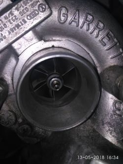

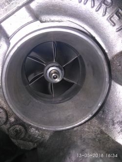

    I checked the intake again, connections, o-rings. There is no indication that there is any "fel" here. I looked in the turbine, the impeller has too much clearance in my eyes. It is known that it cannot be tightly folded, it must have some slack. Well, in my opinion, badly worn blades ... It is possible that a badly assembled / balanced turbine gave a whistling effect?

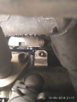

    As for the oil leak.
    After driving 1000-1200km, about 100ml was lost.
    I took off everything I could to see the manifolds, heads and engine block. I took a few pics:
    Persistent Whistle & Exhaust Fumes in Cabin: VW Caddy Skap 2008; 2.0Tdi; 140HP; BMM Engine Persistent Whistle & Exhaust Fumes in Cabin: VW Caddy Skap 2008; 2.0Tdi; 140HP; BMM Engine Persistent Whistle & Exhaust Fumes in Cabin: VW Caddy Skap 2008; 2.0Tdi; 140HP; BMM Engine Persistent Whistle & Exhaust Fumes in Cabin: VW Caddy Skap 2008; 2.0Tdi; 140HP; BMM Engine Persistent Whistle & Exhaust Fumes in Cabin: VW Caddy Skap 2008; 2.0Tdi; 140HP; BMM Engine Persistent Whistle & Exhaust Fumes in Cabin: VW Caddy Skap 2008; 2.0Tdi; 140HP; BMM Engine
    Then I washed everything thoroughly, folded it, rode back and forth under the car. Unfortunately, I was caught at night and without re-disassembling some parts, it is difficult to accurately determine the place of the leak. In one of the photos, I marked the area where fresh traces of oil appeared. Starting from the collector (unfortunately mostly covered) to the half of the block. I had no way to take pictures.
    In the meantime, my friend took the car to listen and possibly suggest something. He checked cylinder compression - book.
    After 2 days, he called that there was no leakage ?? Wtf. I did 350km and maybe a minimal drop appeared twice. Block slightly dirty, but not as tidy as before. And I ask witchcraft?

    Often the gasket leaks under the vacuum pump, then the oil is poured onto the back of the engine.
  • #8 17228209
    Tur31
    Posts: 28
    Rate: 7
    Right. Why hadn't it occurred to me before. After the first assembly, there was a slight diesel leak from under the pump. We changed the gasket a second time and peace of mind. If I get a new one immediately, I will do it and let me know the effects.
  • #9 17403061
    Tur31
    Posts: 28
    Rate: 7
    The leak has been eliminated.
    As a colleague T5 wrote - The leak was mainly from the Vacum Pumps, but also gently from the valve covers just above the pump. The seal was a bit lower than the factory seal.
