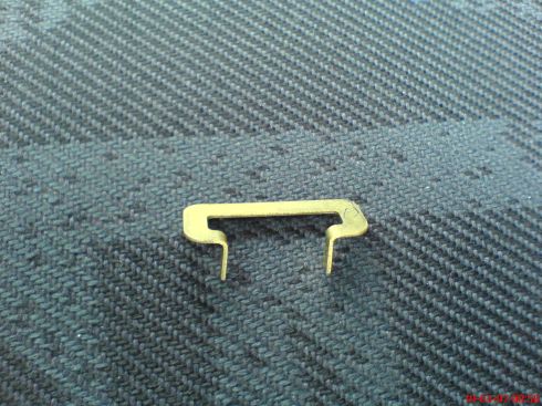

    Hello. I have a request, how to assemble the low and high beam lights in the Golf 3 so that they shine together when the road lights are turned on.
    #2 16283842
    lukasrsv
    Level 20  
    Posts: 591
    Help: 41
    Rate: 165
    You need to make a jumper in the relay slots in slot 10, between 2 and 6.

    There is a special jumper for this. I have one in my car myself.

    Sorry for the mistake. I myself have one jumper and another in the car and hence the mistake.

    This jumper is from the fog lights.

    Forgive my ignorance about the Golf 3, but how are the road lights made there - is it a separate bulb, or on a two-filament bulb with low beam?
  • #9 16294650
    ociz
    Posts: 15844
    Help: 1379
    Rate: 3487
    @tzok , there are two versions of the factory headlamps. On H4 or 2xH1. In those with H1 the road lights shine together with the low beam.
  • #10 16294657
    lukasrsv
    Level 20  
    Posts: 591
    Help: 41
    Rate: 165
    Exactly so and to make both bulbs shine at the same time you need to add a small jumper.

    However, if you have H4 lamps, do not install this jumper, because a longer inclusion of both bulb fibers will damage it.
