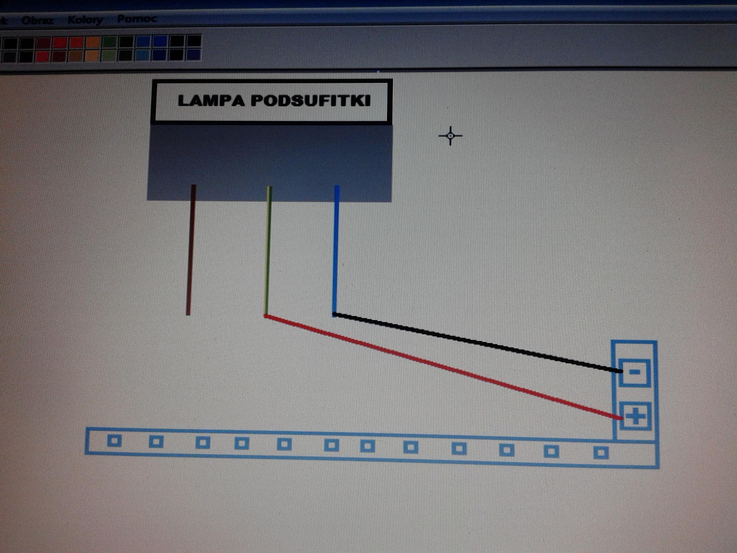

    Hello. Does anyone know where the dimmer of the vehicle interior lighting is located in the Golf 4?
    Or maybe I will describe what I want to achieve and there will be another solution to my problem. I want to connect the LED strip on the driver's and passenger's legs and the strip is to light up when opening the door and then dim at the same time as the cabin lighting.
    The cabin lighting dims by itself after closing the door and waiting about 25 seconds or after turning the key, so where could you connect to these LEDs to achieve such an effect?
    Once again: I open the car with the remote control and the cabin lights come on. Now I want the LED strip under my feet to glow and to dim at the same time as the cabin lighting, and now one more thing. I want to be able to turn on this LED strip with a button, for example while driving, as if something fell under your feet. Thank you all for the tips
    Btw. I thought to connect to the cables from the light in the ceiling lining, but will the dimming work then? And how in this case to make a switch which, after darkening, I can turn on such a strip

    The LEDs will not dim, because they work hard with dimmers, in any case you have to connect to the interior lamp and insert an ordinary switch between them. If you have ordinary LED lists, they will glow gently even when the door is closed, then you will turn them off with the switch because the LEDs have a different resistance than the light bulbs.

    Well, yes: I connected to the cube of the lamp in the headliner and there was a problem: 3 cables come out of the cube: brown blue and yellow green. One is probably a plus, another minus and the third I have no idea. In any case, the trial and error method I connected the led strip and it lights up normally when opening the door and dims when closed. How to do now so that when the door is closed, when the strip is off, I can light it with the ON / OFF switch? I thought then about the third cube cable, because I connected it like this: I connected the yellow green cube cable to the plus in leds, blue to the minus and everything is nice, but when I connected the third cube cable (brown) together with the blue one which is connected to the led cable the strip lights up, but all the lights in the cabin come on and I want the LEDs to glow without lighting the cabin. I attach a diagram, what did I do and it seemed to me that the switch in the closed position should close brown with blue and black? Because if I do, it's bad :( VW Golf 4: Interior Lighting Dimmer Location & LED Strip Connection for Synchronized Dimming20180403_1..358.jpg (943.68 kB)You must be logged in to download this attachment.

    mn997 wrote:
    LEdy will shine you just like the lighting. You can add a switch with a plus to the LED, with a rectifying diode as a check valve (protection against light bulbs)
    I am a complete layman and I did not understand what it was about hmm
    I thought more about whether there is an on / off switch which, for example, in the ON position will light up the leds even though the door is closed and the off switch will only light when the door is open. Something from my diagram that the ON position shortens me the BLACK and BLUE cable, and the BLACK and BROWN cable in the OFF position. There is such a thing?
    Maybe such a thing will do the trick?

    mn997 wrote:
    So that the voltage does not "go back" on the lighting lamps, you need to use a rectifying diode
    And on which section of my "diagram" this diode should be and where to buy such something

    mn997 probably for you it's a piece of cake, so could you draw my drawing, how is it supposed to look like? I would ask you very much. Thanks in advance

    I understood it like this: VW Golf 4: Interior Lighting Dimmer Location & LED Strip Connection for Synchronized Dimming20180403_2..605.jpg (988.72 kB)You must be logged in to download this attachment.
    Well? :)

    Something like this? VW Golf 4: Interior Lighting Dimmer Location & LED Strip Connection for Synchronized Dimming20180403_2..411.jpg (889.91 kB)You must be logged in to download this attachment.
    And it will work? Because I don't know if we understand each other.
    I open the door with the remote control: the cabin illumination and LED strips under my feet are lit. I open the door and it still has to shine.
    I close the door and the cabin lighting goes dark after 20 seconds of inactivity along with the led strip or it starts to darken after turning the key in the ignition switch (because that's how the lighting of the cabin to which I plugged in goes out).
    Now let's say something fell under my feet and I want to light the switch with the strip itself, so this switch is ok in this picture together with these LEDs?

    I found such a solution. I will buy such a switch:
    VW Golf 4: Interior Lighting Dimmer Location & LED Strip Connection for Synchronized Dimming0867a41d4a...8e7f80.jpg (21.34 kB)You must be logged in to download this attachment.
    And now there: a black cable from the LEDs is put on the middle pin, a brown cable on the left pin and a blue cable on the right.
    It seems that I should get the effect I want, that is: in the position on the left wire, the LEDs shine all the time, and in the position on the right wire, the LEDs shine when the door is open and after turning the key, they darken. In addition, it is possible to completely turn off the LEDs. I guess because I don't know if I think well
