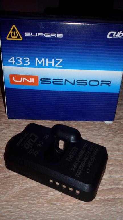

    maybe write what sensor it is, some data so that you know if it can be triggered several times or only once, etc ...

    Rather, it was about activating the sensor and adding it to the car. And the fact that if the key is removed and the system does not work then is another matter. Rather, you activate it once in the car's system. Read about TMPS encoding devices and understand how it works. And even how to check the battery level in the sensor. I understand that you have a sensor to test and you want to make such a device for excitation or coding / training for each car?
    Not all universal sensors work with reverse engineered cars than the sensor itself.
  • Universal TPMS sensors require programming before vehicle activation

    goreckidiy wrote:
    Sensors, I have a uni sensor company.
    As the manufacturer claims, they are universal.
    TPMS 125kHz Sensor Activation & 433MHz Receiver for RFID Antenna: Data & Filling Queries
    From what I understood from reading the various forums, all sensors activate through 125kHz or above 40km / h
    If it was a one-time activation, it wouldn't make sense a bit, because the 433MHz transmitter would quickly drain the battery - at least I think so.
    Maybe someone knows how it actually works, and what when the car is stationary and has the ignition key removed?
    Do the sensors then also transmit?
    Perhaps your problem with the activation in the car is that the sensor has not been programmed for your car model. Universal sensors require programming or configuration to be performed with a device compatible with the sensor manufacturer's requirements. Sensors that I know very well (Alligator sens.it, TECH T-Pro or Huf Intellisens) can be programmed e.g. with the ATEQ VT56 OBD2 device.
    Once programmed, they must be activated in the vehicle in accordance with the vehicle manufacturer's procedure. If it is a 2015 TOYOTA Rav4, it will be a procedure that requires the use of the vehicle's OBD2 link. The variety of activation procedures is great.

    The TPMS should also activate itself and send information in the event of a sudden loss of pressure. A sudden jump of about 0.5-1bar should excite him.
    At least the factory ones, and what the quinols have come up with, only they know ...
    While driving, the sensors are triggered all the time. Documentation for the HUMMER H3 car says that the sensor reads the tire pressure every 30 seconds and transmits it every 60 seconds.

    But we are not talking about a situation where we have a car, but how to trigger the sensor without the car, or with the car turned off ...
