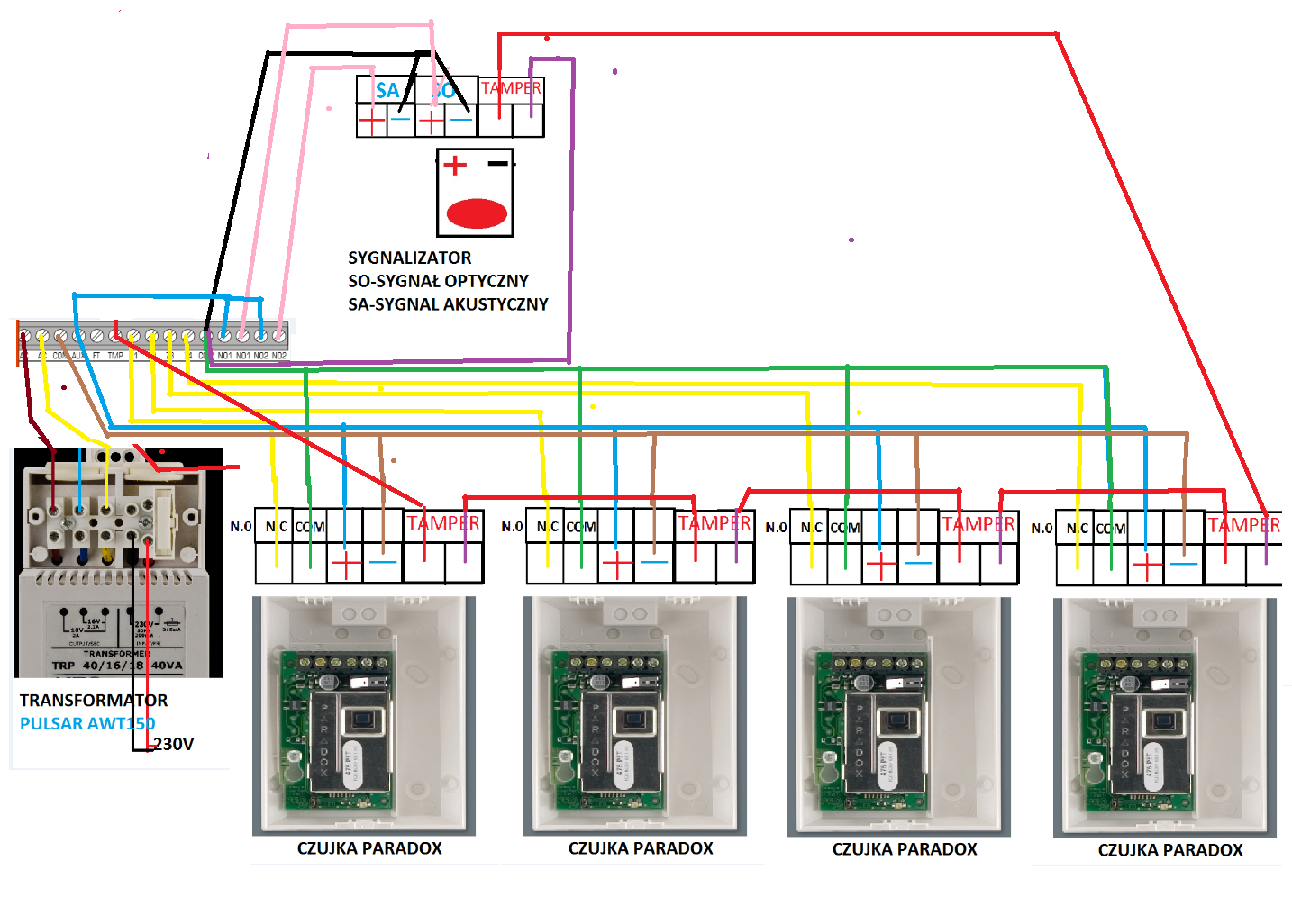

    I purchased the SATEL alarm module, model MICRA.
    In the set I had:
    - board, MICRA alarm control panel
    - PULSAR AWT150 18V / 16V transformer
    - TI700 external siren
    - PARADOX x4 detector
    I wanted to make sure if I connect the whole set as shown in the attachment, if everything will be fine (there is only 1 sensor in the drawing - the rest will be connected the same, only the yellow wire to the second sensor under Z2, the third Z3 etc.).

    So I have only 18V connect, and now the question is whether to connect both AC inputs on the control panel 18v or only one? In the drawing dallem bridge and connected to both.
    Should both TMP outputs on the detectors be connected in series?

    Ok, so I know how to connect the power supply.
    Are the outputs at the NC / COM / + / - sensors connected well? They do not need to be connected in series?
    So only two tamper outputs (TMP) should be connected in series? Is everything okay?
    And what happens if I don't connect them in series? After cutting the wires will not give a signal to the control panel?

    Request to check this diagram in the attachment.
    I followed the recommendations as above.

    Yes, thank you so much for your help!
