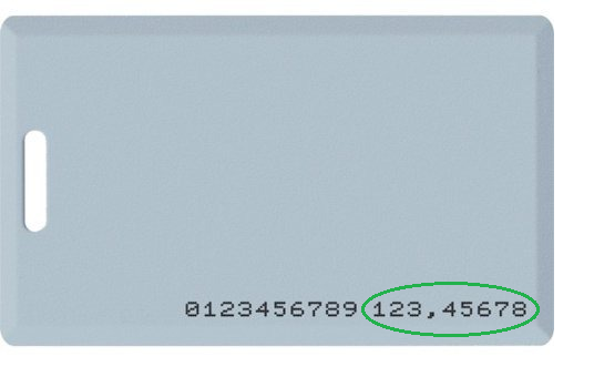

    I have been interested in RFID technology for a long time and today I would like to present the development of my old design, namely an RFID card reader with an integrated antenna on a PCB.
    Due to the complicated structure of the antenna (small distances between the paths), the board was ordered from an external company. The heart of the project is the Attiny13A microcontroller and the EM4095 transreceiver. I used the processor in a DIP housing, because I do not have an adapter for SMD programming. Except for one resistor, everything else is in the SMD 1206. The circuit is unusual because virtually all other projects are based on large processors, eg Atmega8, Atmega32, PIC16Fxx etc., but I couldn't find something on such a small circuit.
    The reader reads cards as standard UNIQUE at 125kHz . Cards are encoded with a 64-bit unique serial number.
    As I mentioned, the board was commissioned to an external company - XXXXX. I am very pleased with the performance - no short circuits, despite the small distance between the tracks. High-quality tin-plating, metallization and solder mask - does not come off when heated with a soldering iron. I think that the most interesting element of the board is the antenna - it has a range of about 8 cm with the Unique card. The board has a 3x godpin strip - Tx respectively - data transmission in the TTL, GND, VCC standard (5V, also checked 3.3V - works, but the range is visibly smaller).
    On the board, in addition to the processor and strip mentioned above, there is an LED signaling the card reading and the standard application of the EM4095 chip.

    The reader sends 9 bytes of data:
    1. # 7Eh - transmission start symbol
    2.1-byte card code data (MSB)
    3.2-byte card code data
    4. 3-byte card code data
    5. 4-byte card code data
    6.5-byte card code data (LSB)
    7. # 5Eh - symbol of transm. check totals
    8. Checksum - XOR checksum
    9. # 7Ch - symbol of end of transmission
    If the card is kept in the reader field continuously, such a frame is sent every 700ms. The reader informs that the card has been read by lighting the LED for 350ms.
