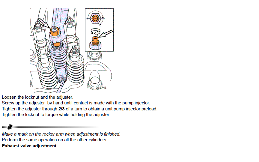

    Hi,
    I have to set the valve clearance and pump injection for 4 Premium DXI 450 tractors.
    Sample VIN VF624GPA000031668
    I found similar topics on the forum:
    https://www.elektroda.pl/rtvforum/topic2307633.html#10958191
    https://www.elektroda.pl/rtvforum/topic1974069.html
    However, I am not sure if the information contained therein is suitable for my vehicles.
    Please help

    This data is the most accurate, except that for you the injection pump regulation will be angular, as in the first link.
    • Renault Premium 450 DXI 2009 - valve clearances and pump injection settings reg renault premium dxi.png (66.81 KB) You must be logged in to download this attachment.
