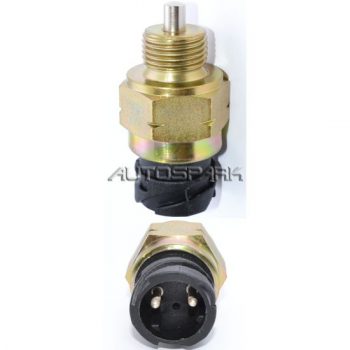

    Hello gentlemen, I have a problem with reverse gear in the Renault Premium dxi manual.
    A letter does not appear in the indicator and the reverse lamp does not light up.
    The relay does not react fuses both approx. Relay R08 fuses F59, F103.
    Where exactly is this sensor on the box because I can't find it, is it like that? Renault Premium DXI Manual - Reverse Gear Sensor Issue, Indicator & Lamp, Relay R08, Fuses F59/F103
    Thank you

    Your sensor is located in the gearbox selector, screwed in the last one from the right. Here you have the picture and number. original.
    • Renault Premium DXI Manual - Reverse Gear Sensor Issue, Indicator & Lamp, Relay R08, Fuses F59/F103 włącznik świateł cofania 5001845860.jpg (10.95 KB) You must be logged in to download this attachment.

    The sensor you showed is a pressure sensor for a Volvo cushion. replacement from DT:
    2.27150

    Maybe the wrong photo I gave but the rest of the back without changes, nowhere to look?

    Check if the current comes out of the relay, see if the current is on the sensor.
