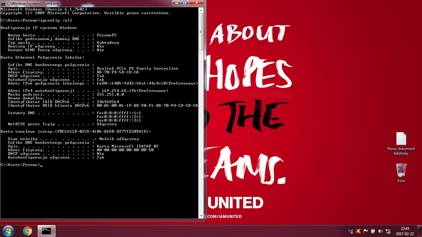

    Hello, I have an Orange Funbox 3.0 modem and I have a problem with the internet. Well ... I and my brother have 2 laptops, I have 7 wines and my brother has 10 wines, I don't want to go with a cable connection, and my brother works, there is a wireless network. When I wanted to enter the network center and diagnose the problem, something like this came to me: the local connection does not have the correct protocol configuration.

    What input do you connect to on Facebook? what is the output of the command on the "ipconfig / all" command line? On your computer, is the TCP / ipv4 protocol in the network card properties set to get the address automatically?

    Well connected. Show what ipconfig / all gives

    Orange Funbox 3.0 - the local connection does not have the correct protocol conf

    Are you sure you have Obtained IP address automatically and Obtain DNS server address automatically in the ipv4 properties in the network adapter properties ??
    DHCP works rather on the router as there is internet on other PCs ...
    Edit: Basically it shows that he is on the screen .....
