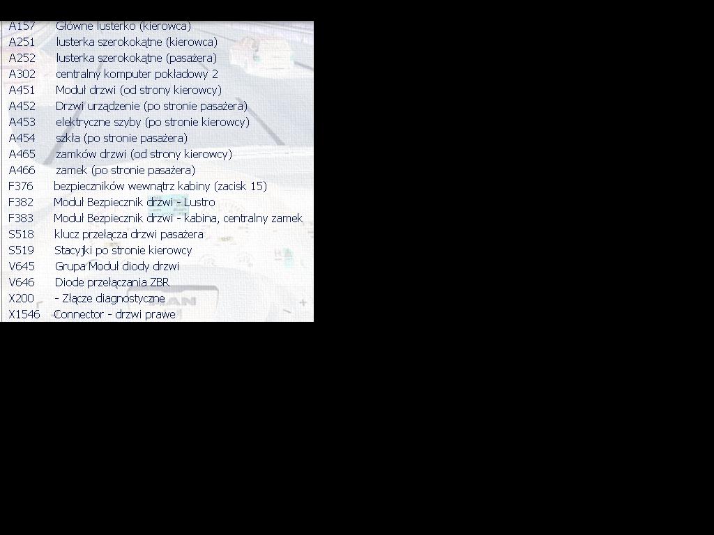

    Hello. Only opening the left window from the driver module and the right window from the passenger module and the switch near the gearshift lever works. The rest are completely dead: mrgreen:. I have had such a problem a few times, usually after big frosts, but when it got warm or warmed up in the cabin, the problem disappeared. Now everything seems to be gone because it is the second month and still does not work. Disconnecting the battery did nothing. I also replaced the left door module and it is the same and my module works in a different car. Where to look for a problem :?: There were a few errors on the display in EDC, GDK / PDF, but it was because of the rotting orange adblue cube. After exchanging everything Passiv. Where to look for a problem :?:

    #6 16306001
    Hart3
    Level 26  
    Posts: 630
    Help: 100
    Rate: 479
    It seems that the left-hand door harness is damaged. I recommend checking it manually and the attached file with the exactly described door module should be helpful. I add a door module diagram, sorry for the poor resolution.

  • #7 16492271
    sebotrucker
    Posts: 122
    Rate: 85
    Hello, the problem still occurs today I excluded modules because I replaced them with another car. No improvement and my modules work in a different car. Another thing I took down the driver's door, everything seemed ok, I tried to connect the module and, interestingly, everything started working, all functions came back. On the second day, again the same helped unplugging the module for 10 seconds and reconnecting. The next day everything died again. Tomorrow I will check passages or maybe somewhere there is a gap between the door and the cabin.
    #8 16492518
    Hektar Zahler
    Posts: 2333
    Help: 230
    Rate: 528
    The rubber on the door bundle under the wind deflector needs to be ripped off to see broken cables ...

  • #9 16494624

    Hello, it is something. Tonight I plugged in the driver, turned on the ignition and silence closed the door and suddenly everything came back. Of course, not for long and again dead nothing works behind the central lock in the left door and the left window.
  • #10 16515057
    sebotrucker
    Posts: 122
    Rate: 85
    The problem is solved, it turned out that the cable that went to the left mirrors has worn. Rubbed at the place where the cables come out of the door to the mirror after replacing the cable everything came back and works ;)
