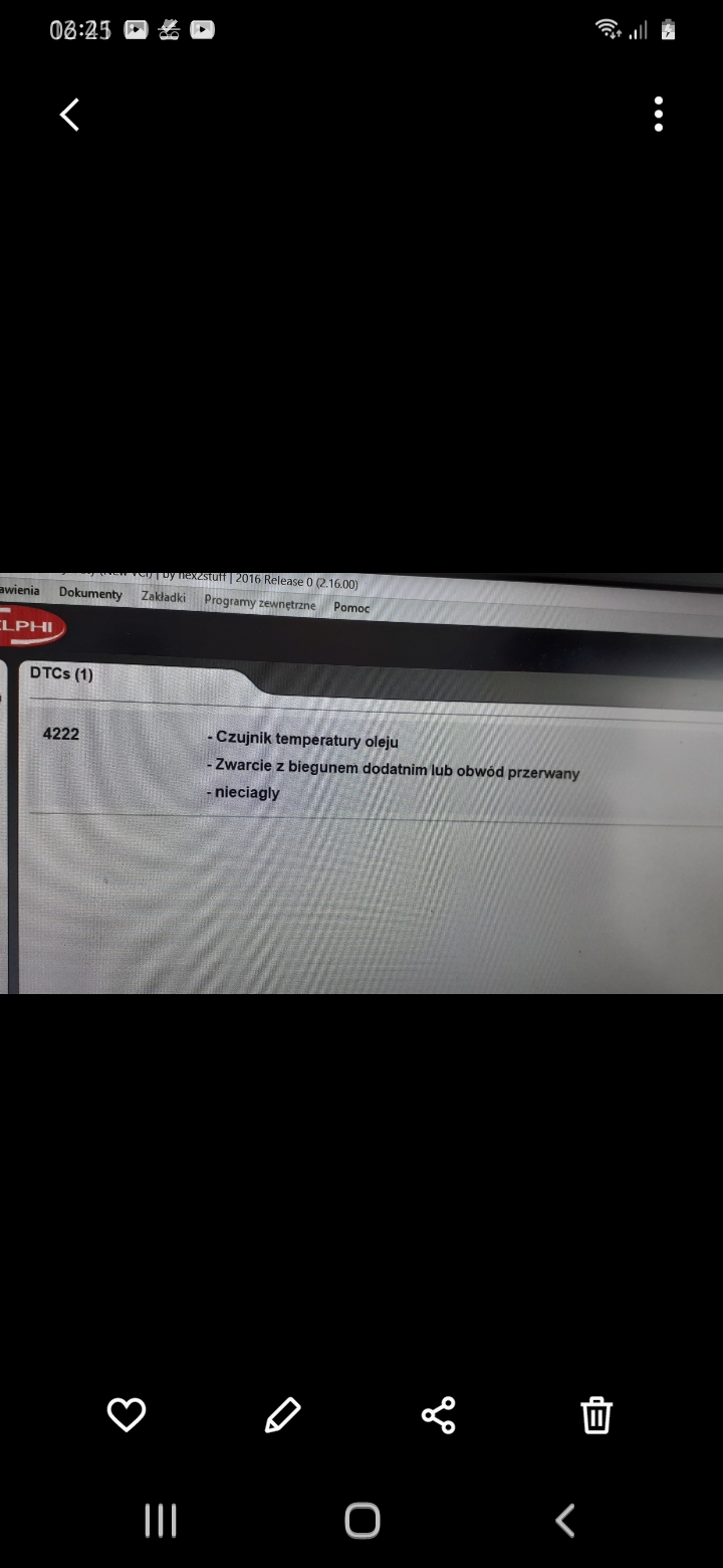

    I dug through the forum but I can't see because I found nothing matching. For some time the retarder has not worked for me, exactly the first 4 steps. 5i6 works but these probably suffocate the engine with exhaust gases. The car's computer in the diagnostics gives the error ret s 5 04219 -03. Do you have any ideas?
    MAN Tgx 18.440 2012 Astronic box with intarder

    Thank you all for your reply. There was a new error for a while ret s 5 04222-12 good that I stopped to save it because after a while this and previous error was gone and ret is still not working. Interestingly, by pressing the brake pedal or turning on the ret manually, the ret braking icon is displayed as if everything was fine. As for other bugs in this, apart from adblue is Diag 2 02016-08

    02016-08; CAN retarder bus distorted signal. 4222-12; oil temperature sensor, no error definition (error applies to retarder).

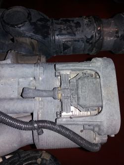

  • #14 19080853
    gumka18
    Posts: 12
    Hello, where is the oil temperature sensor located?
    Added after 3 [minutes]:
    Hello, where is the oil sensor and is it possible to buy it without a harness
    Added after 9 [minutes]:
  • #15 19081081
    kakibara
    Level 35  
    Posts: 2379
    Help: 202
    Rate: 1284
    We can't buy the whole thing. At the rear of the retarder.
  • #16 19081293
    gumka18
    Posts: 12
    Can you buddy send pictures of the harness and oil sensor location? I have such an error, the beam may rub
    • Man TGX 18.440 2012 Astronic Intarder Issue: Retarder Malfunction, Error Code 04219-03, 5 & 6 Steps Screenshot_20201201-062153_Gallery.jpg (254.63 KB) You must be logged in to download this attachment.

    It won't necessarily be a sensor.

    #21 19083332
    kakibara
    Level 35  
    Posts: 2379
    Help: 202
    Rate: 1284
    From this plug, start down, sometimes there is a problem / sensor / harness in the plug itself.
    Then the computer itself on the retarder - if you do not have a spare part, costs will be incurred.
    Connect the computer, move the plug and the cable, see if the error disappears - I had maybe 2 such cases.

    Transmission oil temperature sensor malfunction.
