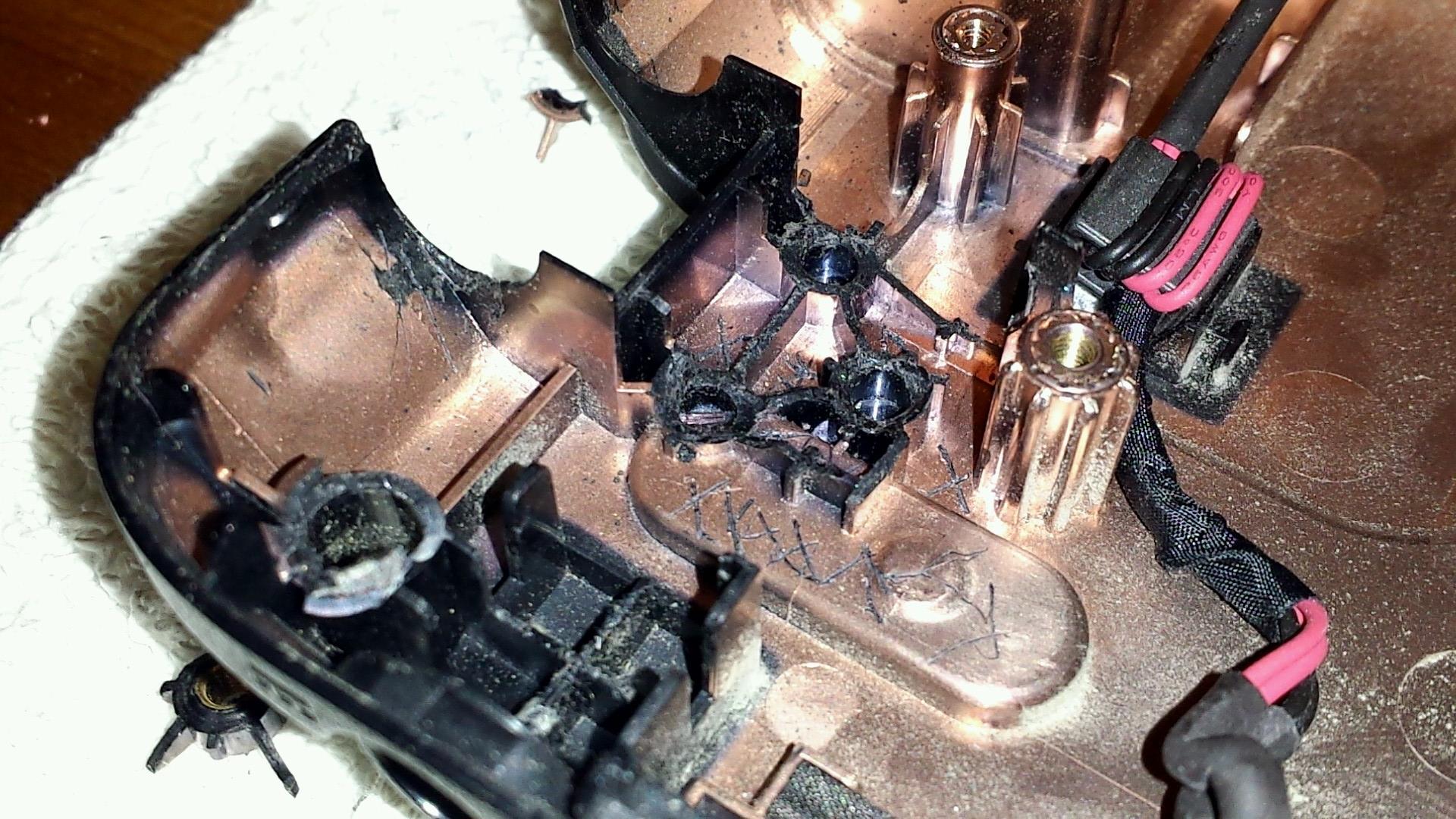

    There are nice adhesives, I saw thinner soniacs glued on them, but ... to replace later the matrix tape must be broken because you have to glue the whole thing, not just the threads - unfortunately I do not know what this great glue was because I do not use adhesives as the main repair element, I will show you How do I do it if the cost of a new hatch is beyond common sense, unfortunately you must have a large selection of screws, so you would have to have an additional 6 of those you have for the hinges now.
    It is true that I have photos on hand with Lenovo, but the principle is the same, I also do ultra-thin Samsungi and Sony.
    Sony Vaio SVE14: Seeking Guidance on Repairing Broken Matrix Flap Hinges
    In photo no.1, the threads are just deposited on the droplet so that they are stable during assembly, you can also put them on a poksipol as long as you don't drip everything, you can also put some poksipol on it for stability as shown in no.2.

    For such things I use a two-component adhesive with the graceful name "liquid metal" by Dragon [EAN: 5903649017543]. I bought it in some DIY store, probably in Obi, but I'm not sure.
    In fact, I use it to stick metal sleeves into broken sockets, if a piece of the socket is missing - then I position the sleeve on the remaining remnants and use the same glue to fill the gaps. The glue is for the patient (it dries for a long time, I give it even 24 hours for it to dry well). The result is a block that can be ground and drilled with a fairly high strength.
    I found sample photos of Gateway, in which it looked much worse than in Soniak Kolegi. It is true that I glued the bottom, but the top can also be done, the more so that a lot of the original sockets have remained with my colleague. A few souvenir photos from Gateway:
    Sony Vaio SVE14: Seeking Guidance on Repairing Broken Matrix Flap Hinges Sony Vaio SVE14: Seeking Guidance on Repairing Broken Matrix Flap Hinges Sony Vaio SVE14: Seeking Guidance on Repairing Broken Matrix Flap Hinges Sony Vaio SVE14: Seeking Guidance on Repairing Broken Matrix Flap Hinges Sony Vaio SVE14: Seeking Guidance on Repairing Broken Matrix Flap Hinges Sony Vaio SVE14: Seeking Guidance on Repairing Broken Matrix Flap Hinges Sony Vaio SVE14: Seeking Guidance on Repairing Broken Matrix Flap Hinges Sony Vaio SVE14: Seeking Guidance on Repairing Broken Matrix Flap Hinges
    The broken debris, which usually rattles in the laptop before unscrewing, is positioned with a droplet before being poured with glue, so that it will hold on until the proper glue dries.
    The glue is thin (the consistency is similar to honey), so I set limits (it is worth trying the hinge mounting to see where this glue can be poured with impunity). It is also worth checking if there is an LCD cable passing somewhere, or some other coming out of the matrix box. Adhesive restraints are made of double-sided foam tape. It does not have to be perfectly tight, the glue does not flow through very small holes. It is also a good idea to cover the bottom of the sleeves with tape (I use a paper - repair one) so that the glue does not flow into the screw hole.
    If it is possible, it is worth loosening the screw on the hinge axis a bit (the hatch moves more loosely and rocks a little more, but there is less risk of it breaking out). If the hinge cannot be adjusted and it moves hard (it is jammed), it is worth replacing it (along with the hinge on the other side, it is best to replace the whole pair). If we install a worn hinge, the situation will probably repeat itself soon.
    The laptop from the photos above has been working for half a year and nothing breaks, the hatch works nicely, the housing does not crack, does not come apart, so the repair can be considered successful. Earlier, I glued several other models on this principle, the glue works quite well.
