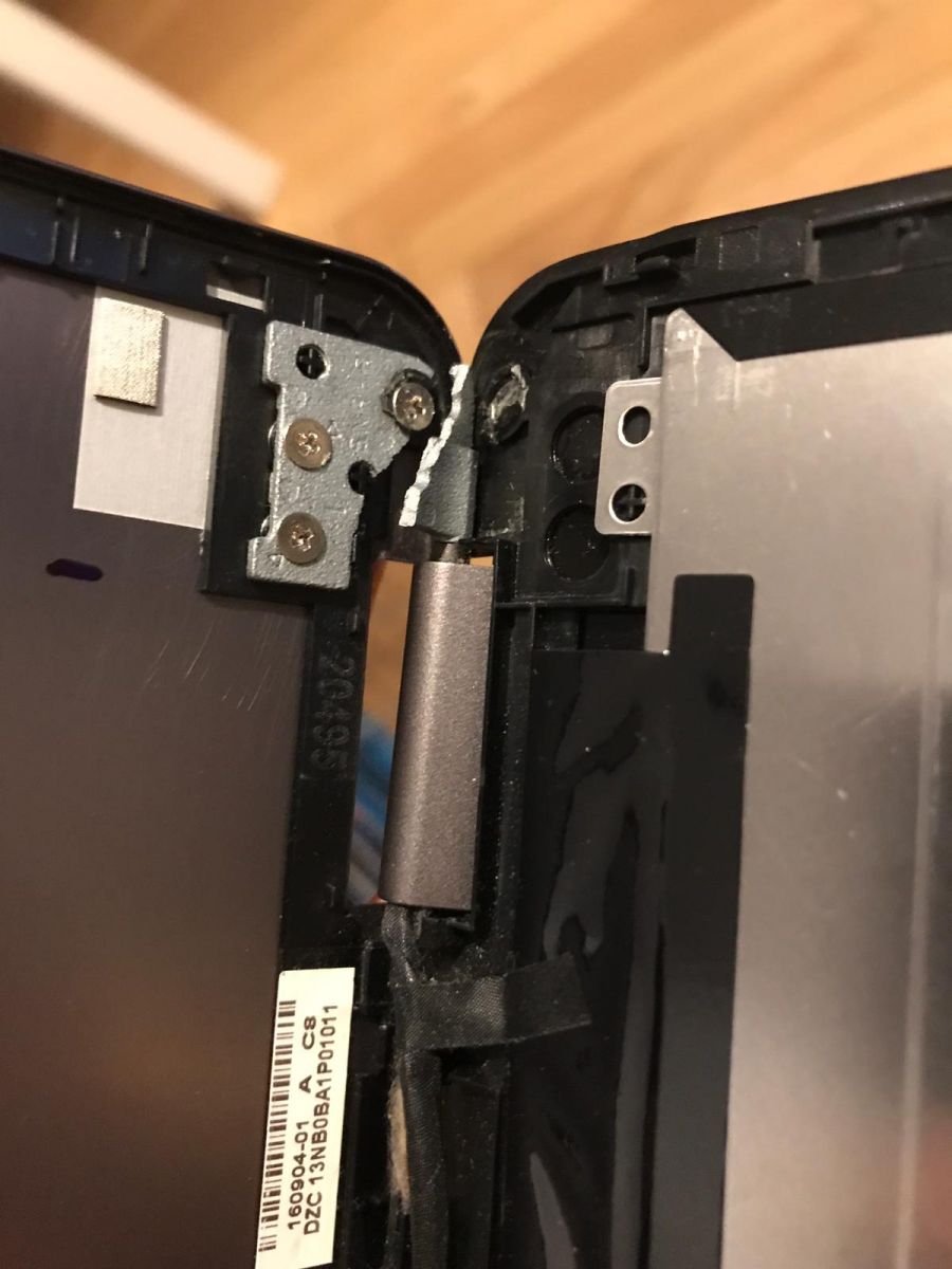

    I have a problem with the hinge in Asus since yesterday. The warranty expired 2 months ago and I am forced to look for other smile.gif solutions
    The left hinge has become stationary at the base, only the swing of the flap works - however, it does not hold the die properly. When closing the laptop, the hinge does not move and the top and bottom do not match. Have any of you encountered a similar problem? I contacted Asus, but their answer was unequivocal - after warranty and we do not sell part, and the nearest official store is in Sweden or France. They do exist, but shipping them to Poland is not profitable. I put a photo to illustrate the problem ... Asus Zenbook UX360C: Damaged Hinge Issue, Repair Options & Seeking Part in Poland

    Disassemble the laptop just be careful, take out the matrix part with the hinges, the hinges themselves are definitely demonstrable
    After all, there is nothing to break, possibly in the extreme position, cut and amen, it should be dismantled and checked.

    Yesterday I undressed the whole thing, which was definitely not difficult. 10 screws under the laptop + two under the rear 'feet' + another two behind the black screen reflectors. The hinge itself is held on six screws, three per side, one of which is behind the aforementioned buffers. Two tapes from the keyboard and touch pad that can be easily peeled off and two connectors from the screen itself.
    In my opinion, this small gear is blocked due to dirt, which caused a lot more pressure on the silver element, in which the cutters finally worn out and there is nothing to hold on to the spindle.

    Everything fit and the exchange itself took 20 minutes. Laptop closes like new :) ..but we had to wait almost 3 months for the parts.

    The topic of hinges is still valid because, unfortunately, this laptop has a badly solved hinge. I wanted to share my experiences with ASUS UX 360 hinges because I have already made them three times. The first time I knew nothing about it, I took the laptop to a company that replaced the hinges with new ones. They charged me for about PLN 350 and the hinges were working, but of course after some time it was exactly the same. I decided to disassemble everything myself and it turned out that the new hinges are not needed at all and the existing ones can be started by yourself.
    The hinges are designed in such a way that, inter alia, inhibited the movement of the cover. The mini gears inside the housing were almost completely dry (without any grease) causing the gears and brake to seize up. If the resistance increases sufficiently high, the connection of the bright element of the hinges (probably galvanized) with the pivot pin, which is inserted into the hole, is released. The hinge stops working. I suspect that this is a kind of protection against the complete breakage of the laptop. Perhaps this connection is too delicate.
    Such a hinge can be easily improved. I omit the dismantling of the laptop itself because it has already been described, although it does not have to peel off the tape or any wires. I placed the keyboard at an angle to ensure access to the screws that hold the hinges.
    After removing the hinges, two screws are unscrewed from the face of the mini gear and the plastic housing slides off. Then you can loosen the two nuts (do not unscrew it completely because there will be a problem with assembly), put a drop of oil on it and try to start the gear. The entire hinge can be rinsed in gasoline if it is particularly dirty. After "starting" the gear to the bright element of the hinges, the connection of which was broken earlier, the free hinge pin is glued to the epidian. Of course, I do not have to write about the rules of gluing, degreasing, matting the surface, etc. I personally glued it with poxipol.
    The most important thing when gluing is to lay the elements glued flat. Both the dark element of the hinges, the mini gear housing and the glued bright element should be placed flat, in planes parallel to each other. After the glue has set (for poxipol it is a dozen or so minutes), you can start adjusting the brake. The two nuts should now be gently tightened until, taking the two elements of the hinge (light and dark), you will be able to move your fingers with difficulty. Unfortunately, if the braking is incorrectly adjusted, the cover may fall off or move too heavily. Then you have to do a correction. It is good to coat the inside of the gear with a drop of oil or grease that will not leak out.
    Buying new hinges is pointless (unless they are broken) because then we install an identical element with the same defect.
    A few months will pass and the problem returns.
    Good luck
    Additional explanation.
    The mechanism of this damage is as follows. The hinge, and strictly its gear, becomes blurred with time, it works harder and harder, but the user does not feel it well due to the large arm when opening the cover. At high loads, the connection of the "light" element with the hinge pin is broken and then the screen begins to open more easily and falls down because it is only braked by the second, still good hinge. In this situation, the screen can be tilted, but only by about 180 degrees and usually it is skewed to the housing. The hinges in this condition can be repaired using the method described above and then there is no need to buy new ones. When opening a little more than 180 degrees, the tilt screen locks and you cannot turn it further. If someone does not notice this defect and wants to forcefully and forcefully rotate the screen 360 degrees into the tablet position, then it breaks the hinges and damages the laptop casing.

Three-step teardown:
  1. Remove 10 bottom screws and 2 under rear feet; pry off base.
  2. Unclip two keyboard ribbons and unplug two screen cables.
  3. Unscrew 6 hinge bolts (3 per side) and lift the display module [Elektroda, Kikus_, post #18262257]
Is lubrication alone enough to fix a stiff hinge?
Lubrication frees a stiff gear but will not reattach a pulled-out pin. Combine oil with epoxy pin bonding for a complete fix [Elektroda, kartok, post #19598948]
Why do brand-new hinges seize again within months?
They ship almost dry. Without grease, wear builds quickly. Adding light grease before installation cuts friction and extends life by an estimated 50 % [Elektroda, kartok, post #19598948]
Which adhesive works best for the loose hinge pin?
Technicians favour Poxipol or any two-part metal epoxy. "Glue only after degreasing and laying all parts perfectly flat" [Elektroda, kartok, post #19598948]
What happens if I force the lid past 180° on a locked hinge?
The hinge anchor tears out, cracking the plastic rear cover and sometimes the aluminium palm-rest—a costly edge-case failure [Elektroda, kartok, post #19598948]
How long will shipping from Zandparts or Allegro take?
Successful Zandparts orders arrived in 2–3 days once shipped but took 2.5–12 weeks in processing. Allegro stock ships within Poland in 48 hours [Elektroda, Kikus_, #18435663; rakamora, #20815000].
