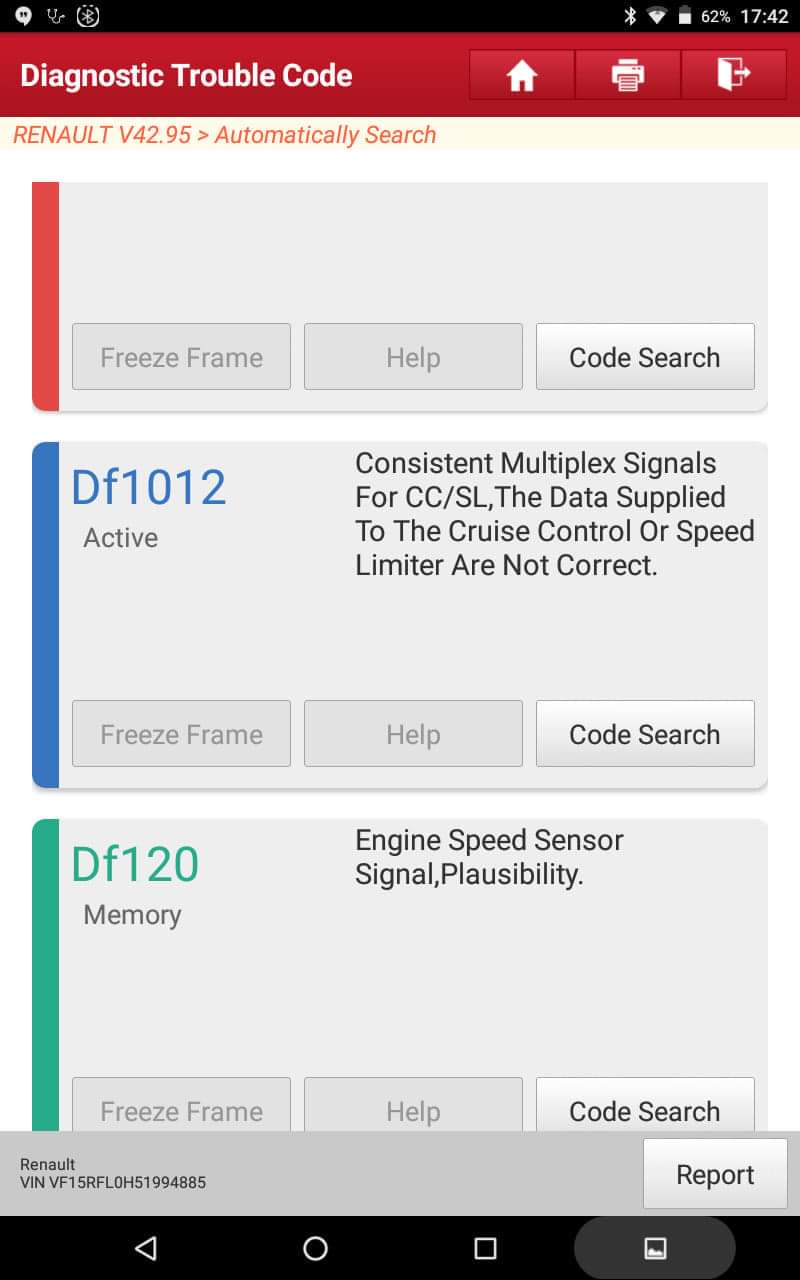

    I have a similar problem only with clio 4 from 2014. But this does not smoke at all. The strangest of errors can not be deleted at all.
    Someone will help?

    A few associated with the discharge flow. Steady with candle module. Occasional ignition relay. One constant from the Cc / sl multiplexer whatever that means.
    I think you have pasted errors not from this car because I see a GMP sensor error here - it's like how to light up :| :?:
    This means that you need to give the car for repair to someone who knows you :cry:

    Genek1000 I see you don't know each other so don't take a voice.
    Bcm with another vin and therefore doesn't smoke. How to make him virgin or at least change vin? Clip does not go.

    I was able to clean the UCH. I entered vin and card. I have ignition and some errors have disappeared. It still doesn't smoke and there is no possibility to delete permanent and non-permanent errors.
    A great request for a diagram, especially with ecu and where is it going?
    the only systems that signal a multiplex problem are radio, communication module and multimedia.

    Gentlemen, massacre. I have a diagram. Everything checked. I even dismantled the board. Nothing seen on the front. All can cables seem ok.
    Where is the can communication module? According to the pattern above the radio. The board was removed and nothing is there.

    Car made!
    After 5 weeks of fighting. One clever guy from this forum. One expensive equipment was successful. BCM virgin, card, ECU virgin, encoding everything again and launched.
