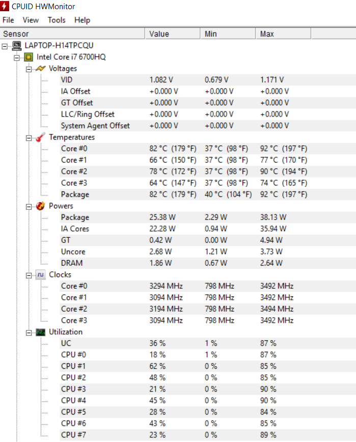

    a few days ago I bought a new HP Omen laptop: i7 6700hq, 12gb RAM, 128 SSD, 1 TB HDD, GTX 965M. In general, everything is OK, but when I start a game, there is a problem:
    1. Fast heating of the processor (also motherboard according to SpeedFan). Almost immediately at a higher load, the temperature jumps up to 90 degrees C. Both Speed Fan and HW Monitor indicate that the problem concerns only the processor - the graphics card and disk have normal temperatures.
    2. When the temperature goes up, the windmills start, which work incredibly loud - I have never encountered anything like that, but they sound like a vacuum cleaner. I note that I have not dealt with gaming laptops so far, so maybe that's why I feel such discomfort.
    When I play Football Manager, the temperature jumps from time to time, when the game had more data - then it drops to 40-50 degrees. When I play, for example, Fifa or demos of some shooters, it's worse because the temperature is still above 70 degrees and often reaches 95 degrees.
    I will also add that when I check in the task manager - the processor never exceeds 40% of the load, and yet the temperature goes crazy.
    The above symptoms do not occur when the laptop is running on battery - then it works quietly and the temperatures do not jump. I didn't get the impression that it worked much slower / weaker. There is of course no problem during normal use - internet, youtube, e-mail etc. The computer works quite quietly, it doesn't heat up (temperatures below 40 degrees).

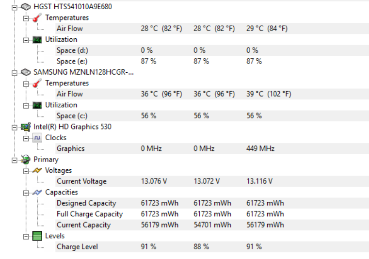

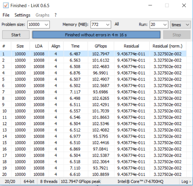

    Thank you for your answer. Here are the screenshots:
    Linx test:
    HP Omen 15 i7 6700hq - CPU Temperature Reaching 90°C During Gaming, Loud Fan Noise & Solutions

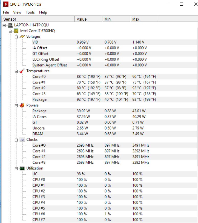

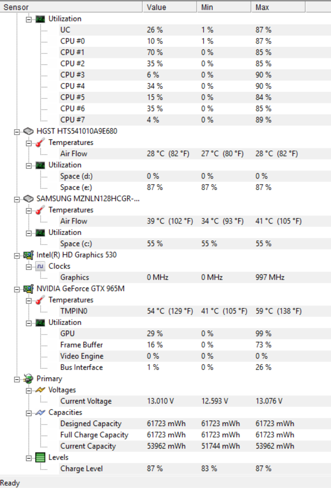

    Screenshot from HWMonitor during the test:
    HP Omen 15 i7 6700hq - CPU Temperature Reaching 90°C During Gaming, Loud Fan Noise & Solutions HP Omen 15 i7 6700hq - CPU Temperature Reaching 90°C During Gaming, Loud Fan Noise & Solutions
    screenshot from HWMonitor after running the Fify 17 demo (after about 20 seconds):
    What do you think Service or normal for this equipment?
    #4 16327257
    rtj71
    IT specialist
    Posts: 4983
    Help: 474
    Rate: 353
    For the second time: service :) 88 degrees on one core and 65 on the other - something is wrong here. It's best to post these dumps when reporting a bug.
