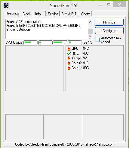

    Recently, I noticed that my laptop is overheating while gaming. Temperatures are sometimes over 90 degrees. What could be causing this :) The laptop is Acer brand, if you need more information, please ask ;)
    Greetings.
    • Acer laptop overheating during gaming - temperatures exceeding 90 degrees xddxdxdxdxdxdxxdxddxxd.png (16.18 KB) You must be logged in to download this attachment.

    Anivka wrote:
    laptop overheats terribly while gaming. Temperatures are sometimes over 90 degrees. What could be causing this
    This type of equipment is usually not suitable for long-term loads. To put it simply - laptops are usually not suitable for games.
    In addition to the cooling system, which is unable to remove the amount of heat generated under constant high load, there is also dust - if the cooling is clogged with dust, its ability to dissipate heat drops significantly. If the laptop is not the newest (and judging by the 3rd generation of the processor - it is not) - it is worth taking it apart and cleaning the cooling system from dust. If the thermally conductive paste has worked long at such temperatures, it is also worth replacing it. After replacing the paste and getting rid of dust, the cooling efficiency should increase, i.e. the temperatures should lower.

  • HWMonitor recommended over SpeedFan for laptops

    Would you kindly give a model of this Acer laptop ...
    SpeedFan is not a very good laptop temperature monitoring program. HWMonitor will do better.

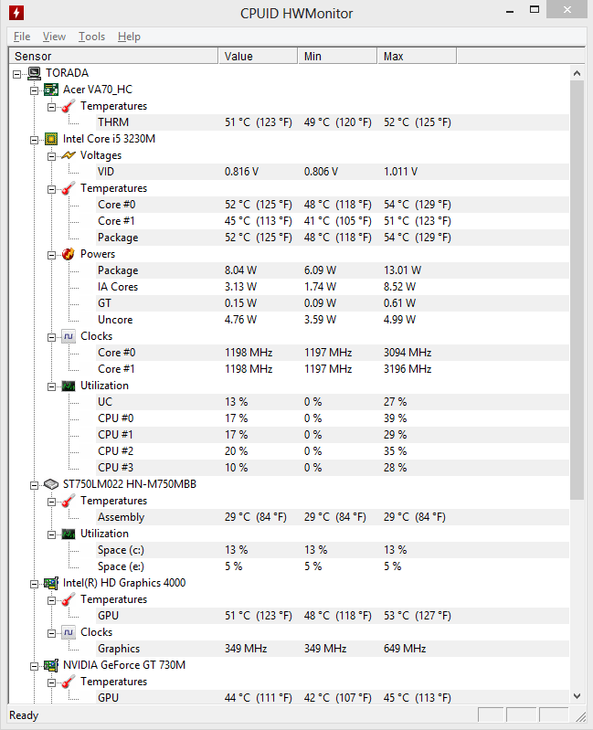

  • #6 16586949
    Anivka
    Posts: 25
    Model:
    V3-771G-53238G 75Ma
    Added after 10 [minutes]:
    SS with HMWMonitor without any load
    • Acer laptop overheating during gaming - temperatures exceeding 90 degrees xsaxaxaxaxsxasxasxas.png (43.57 KB) You must be logged in to download this attachment.

    Measuring the temperatures without load does not make sense, although this measurement already shows that it is definitely too warm. Clean the cooling system, clean the old paste and apply a new one, if it has previously withstood the load of games and did not cut - after such maintenance it should return to this state.
    The laptop components emit about 70W of heat at maximum load, and the cooling in it does not knock your knees down (but as a consolation - you could have found much worse).
