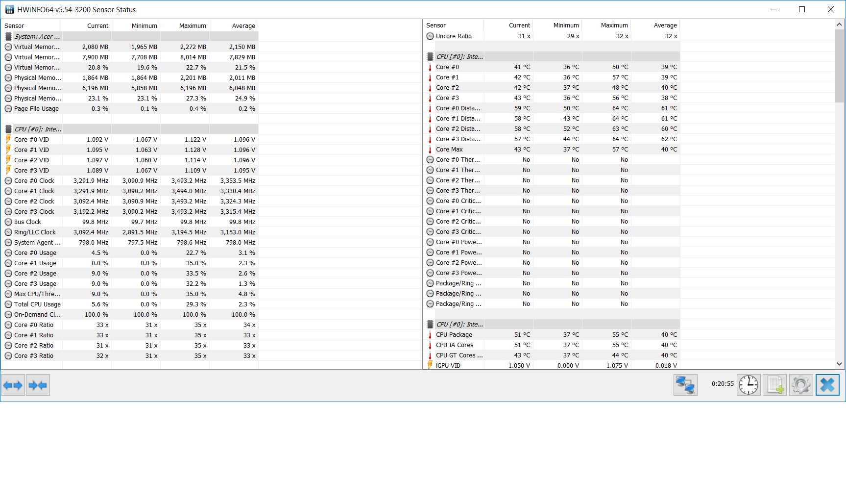

    I have a new Acer VX 15 laptop for several days. Components:
    Intel(R) Core (TM) i5-7300HQ - 4 cores
    GTX 1050 4GB
    8GB RAM
    Windiws 10
    1TB disk
    -I use windows defender (I got rid of Norton)
    When playing in Hearthstone and the open browser Opera with Twitch (I play and watch / listen) processor usage once is 60-70% and lasts a moment, then jumps to 100% and so stays a few minutes, then drops to 80% and returns in a moment down 95-100% - this is how it lasts most of the time
    Acer VX 15 Laptop: 100% CPU Usage While Playing Hearthstone & Using Opera Browser
    I do not want to believe that the browser and so old / poor game are able to use 100% Prock processor. Especially that when playing CS: GO I have 100-170 FPS using 60-70% Prock processor. EDIT: Although I don't know if playing Procek the processor does not jump higher. I can't exclude fps drops either.
    As for temperatures, they are great (low). After playing for one hour in CS Procek the processor reaches ~ max 70 degrees C. During HS +, the browser also does not heat up.
    Can you help me with these spikes in CPU usage and general high usage?

  • Need to run the stress test with all programs closed
    #8 16634132
    sztylet077
    Posts: 193
    safbot1st wrote:
    Depends on the card. Will I get a stress test result?
    How to use this program? I downloaded, installed, launched, time has arrived, 20 minutes have passed, and what next? I gave it to save and leave and nothing happened. Do I have something more to click there?
    Added after 47 [minutes]:
    Oh! That's what you meant ?
    I had all programs shut down.

    And the rest of the table?
    Provide SMART disk.

    Should I move down and do some screenshots? (I have to turn it on again and wait 20 minutes)
    I also have a LOG saved, it won't do anything?

    safbot1st
    Posts: 21951
    Help: 2719
    Rate: 1585
    Don't be misled by the resource monitor. The screen shows a real load of 35%, and the program reports proportions frequency - as can be seen in the mode of its saving - up to the maximum frequency he noted, that's why rubbish comes out.
