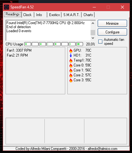

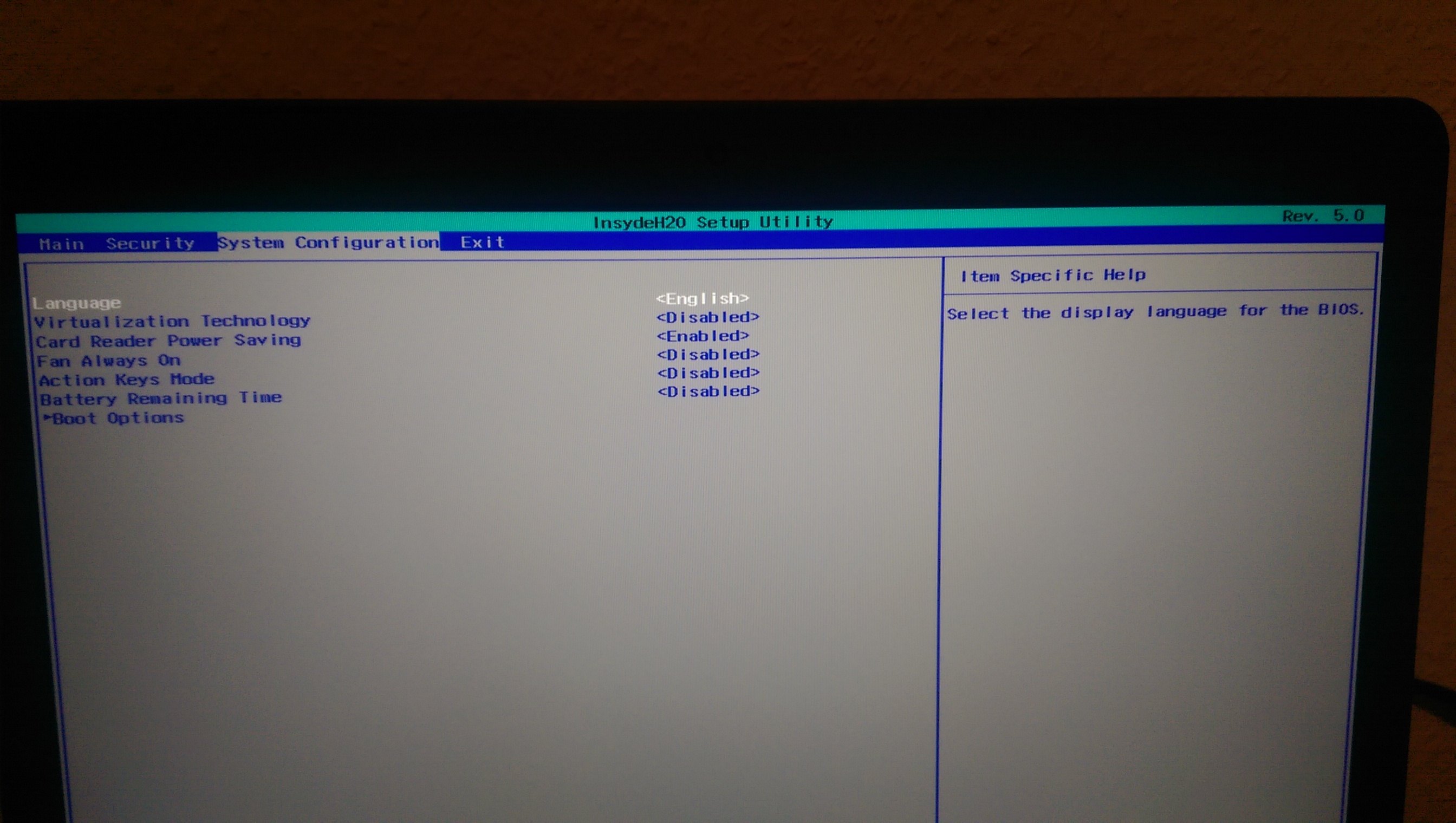

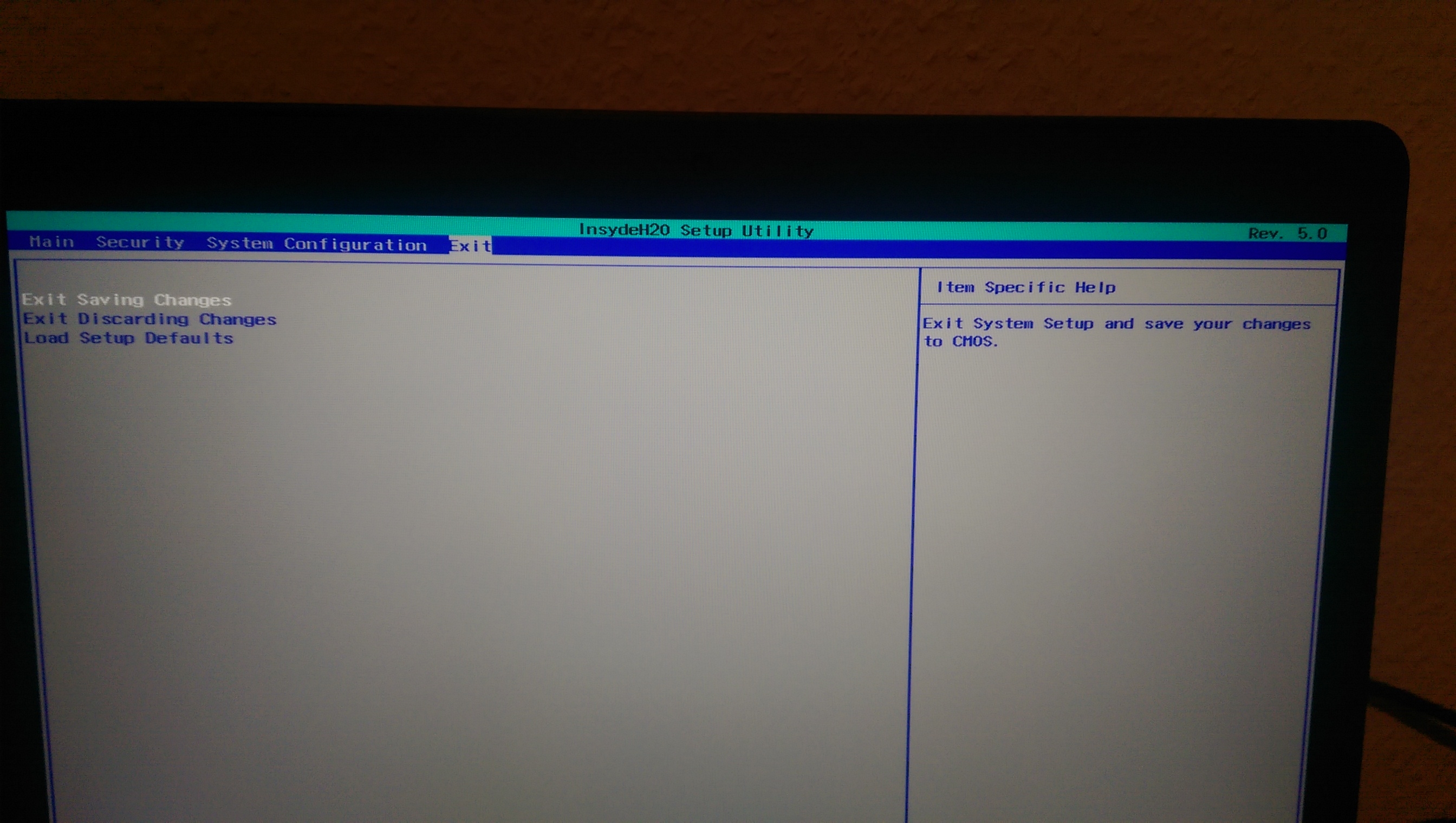

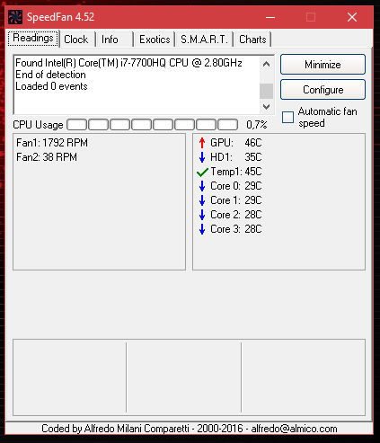

  • #11 16671773
    konraduch
    Posts: 146
    In the background, nothing works, on the desktop itself the situation looks like this:
    HP OMEN 17-w211ng Laptop: How to Reduce Fan Noise & Speed on Desktop or While Gaming
    I tried to remove and install new graphics drivers, nothing has changed, and maybe even unnecessary. I removed the HP CoolSense program, so I didn't install anything.
    My BIOS looks like this:
    HP OMEN 17-w211ng Laptop: How to Reduce Fan Noise & Speed on Desktop or While Gaming HP OMEN 17-w211ng Laptop: How to Reduce Fan Noise & Speed on Desktop or While Gaming HP OMEN 17-w211ng Laptop: How to Reduce Fan Noise & Speed on Desktop or While Gaming HP OMEN 17-w211ng Laptop: How to Reduce Fan Noise & Speed on Desktop or While Gaming
    By changing Fan Olways On to Disabled or Enabled nothing happens either.

    Temp. in Idle as normal as possible.
    Post a screen from Process Explorer, say after 30 minutes. from turning on the laptop and immediately from HWiNFO64 (sensors only).
  • #14 16672087
    Kasek21
    Posts: 45667
    Help: 4981
    Rate: 3548
    Everything is OK when it comes to temperatures.

    So I understand that there is nothing to worry about this one fan where it shows 20RPM?
  • #16 16672123
    Kasek21
    Posts: 45667
    Help: 4981
    Rate: 3548
    No.
