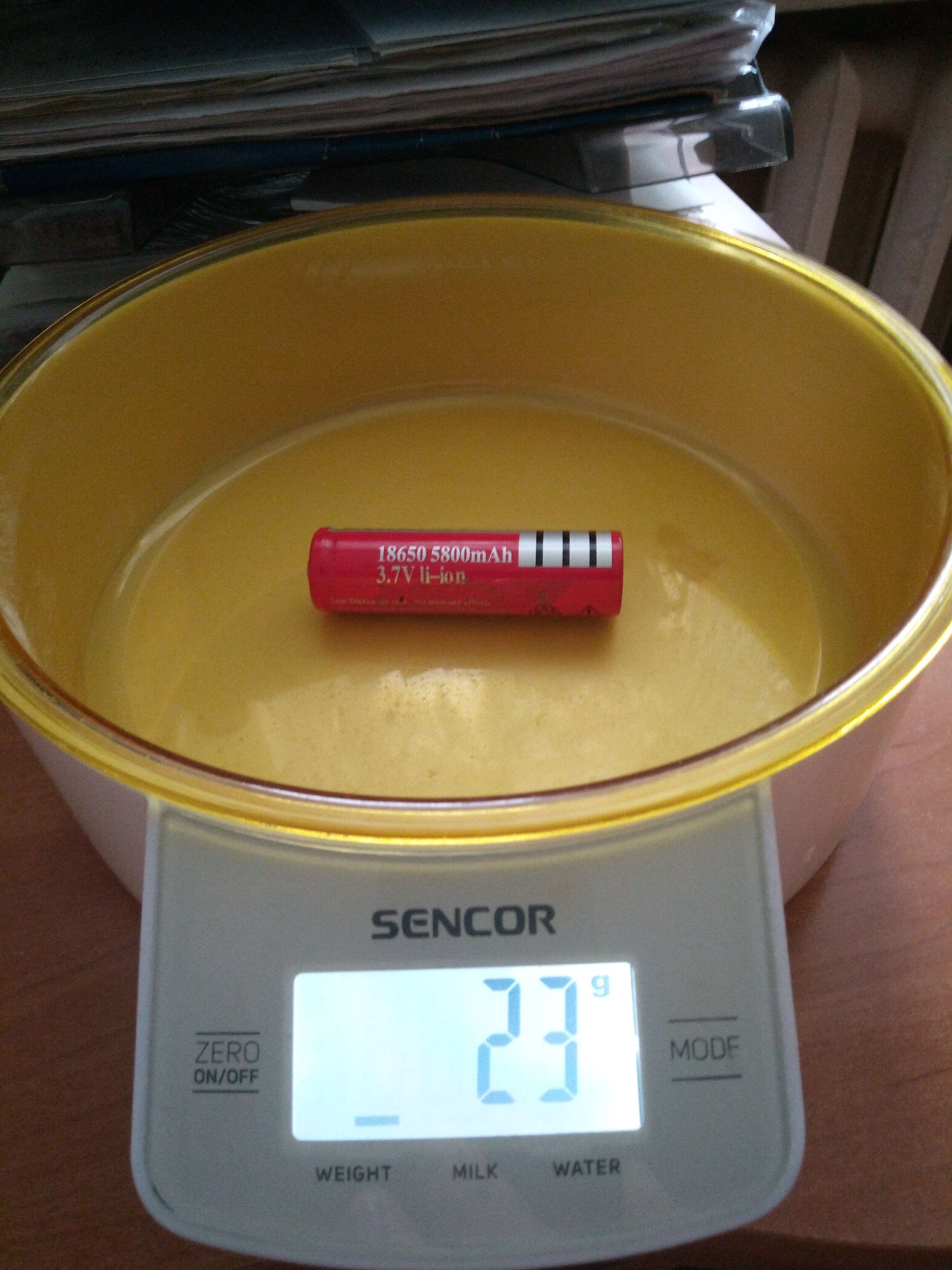

  • #19 17733261
    slanes
    Posts: 22
    Rate: 13
    6800mAh battery, where is the power? It's more of a curiosity not to be fooled by nicely decorated crap.

    A colleague dismantled the "Chinese"?
  • #21 17733852
    slanes
    Posts: 22
    Rate: 13
    Yes, exactly Chinese, and the sad thing is that our native sellers continue to sell this kit and do not react to the opinions of distorted customers about the incredible capacity of such a battery.
    When buying a battery, I suggest the weight (if it is honestly stated), maybe it is not a sophisticated way, but it works for me, for example:
    UltraFire 5800mAh, which is almost what I undressed weighs 23g, and the three-year-old "tired of life" Panasonic 3400mAh 46g

  • #22 17733900
    yogi009
    Posts: 14697
    Help: 848
    Rate: 2655
    Yes, it's an old method. For now, it works, until the Chinese handles start adding weight to the links :-)
  • #23 17742052
    Piotrek#G
    Posts: 1163
    Help: 83
    Rate: 303
    They started a long time ago, you can meet versions supplemented with sand.
