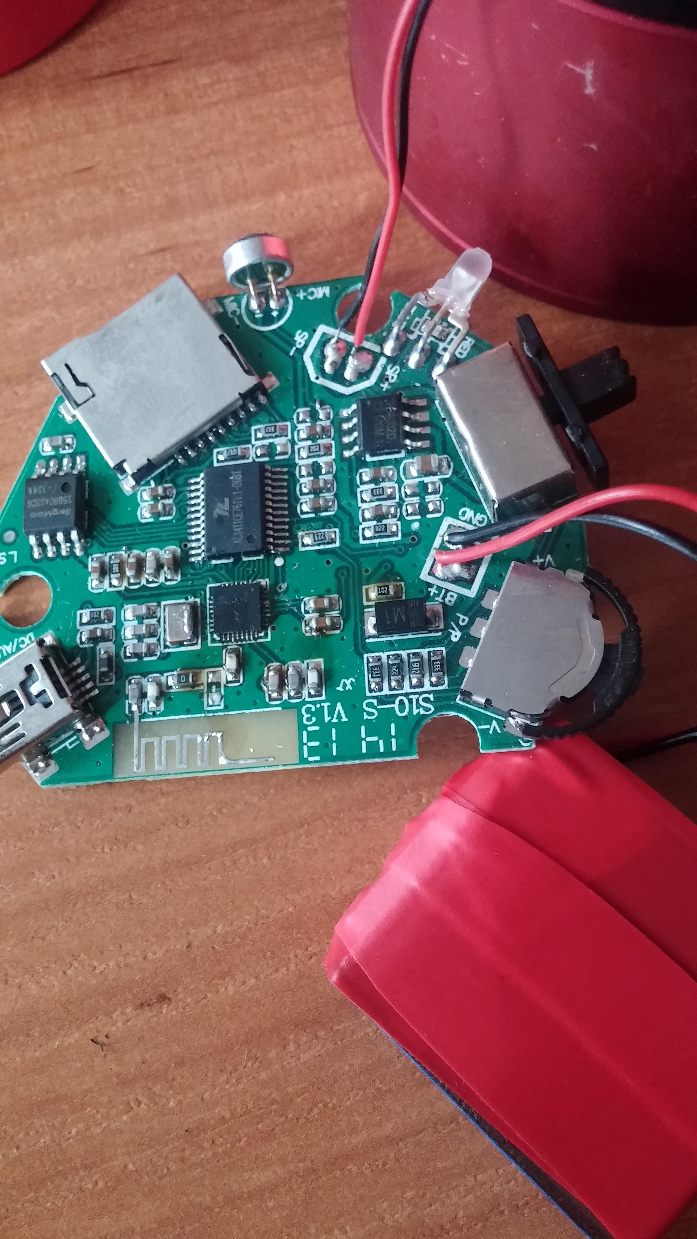

    I have a bluetooth speaker with chon but the battery is already weak ...
    I would mention it, but there are no markings of what type it is.
    The voltage on the battery pins is 3.87V
    Charging via mini usb port
    1W power
    The battery in it has electronics.
    I have Ni-MH batteries or Li-ion batteries at my disposal. Possibly a smartphone rechargeable battery with its own electronics.
    Can I plug in the factory akku to load normally?

    Originally there is a Li-Ion or Li-Po battery, so only such are available during replacement, Ni-MH is out of the question because there will be a problem with its charging in the system.

    A simple Li-ion battery from the phone (one without built-in electronics) will do. Alternatively, you can use another low-capacity Li-ion cell (e.g. 14650), but you may have trouble placing it in the housing because these are usually cylindrical.

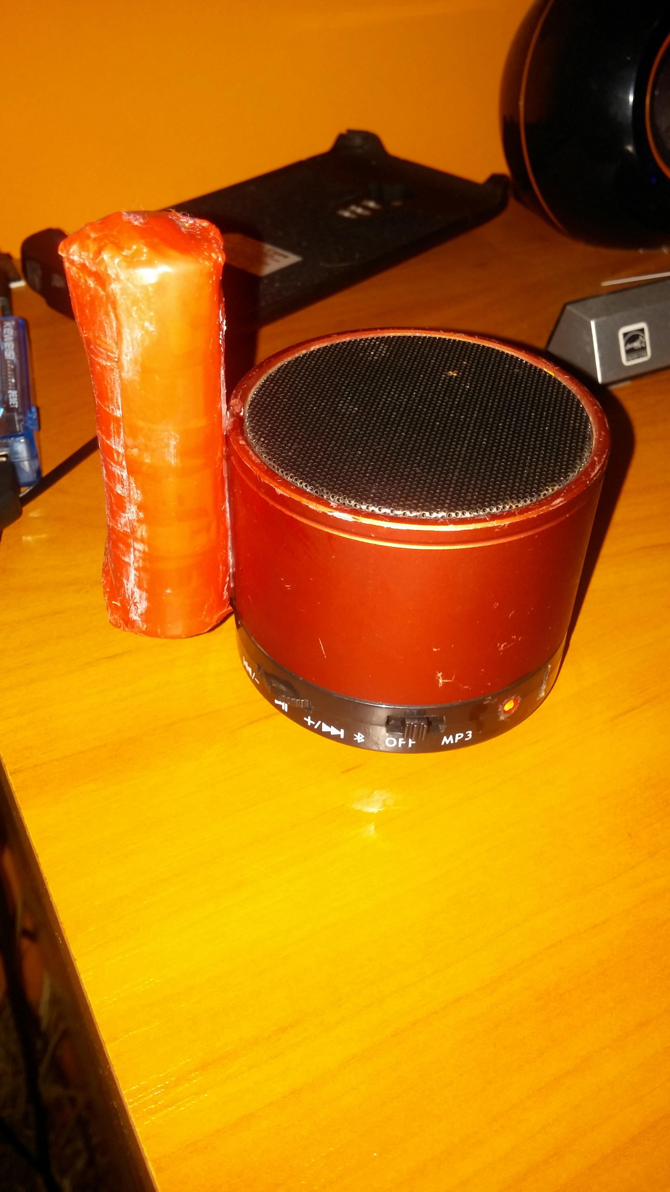

    Put outside, can there be a 18650 li-ion 1200mAh battery?

    If outside, any 18650 will be fine.

    Cool, that's what I also installed ;)
