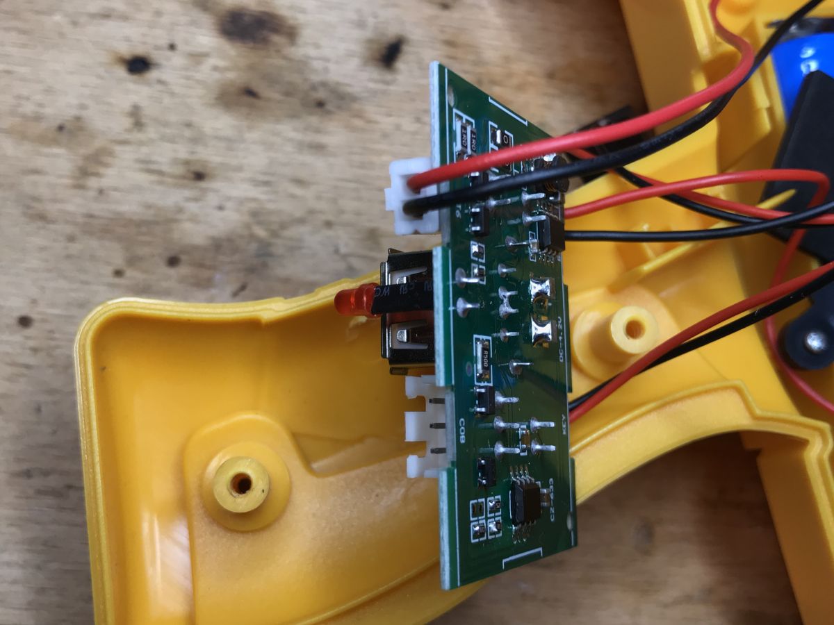

    There is one electronics board inside, everything is connected to it via connectors:
    Plastic flashlight-powerbank from China for 18650 cells, "800W" Plastic flashlight-powerbank from China for 18650 cells, "800W"
    It is strange that the manufacturer allowed himself to buy connectors. Probably the only advantage of this product. Wouldn't it be cheaper to solder the cables to the PCB?

    Tile on the inside
    I put the most important information and connections on the photo of the plate. I think this is enough to understand how the system works.
    The system consists of:
    - an unsigned element in the SOIC8 housing that looks like a microcontroller (a button is connected to it, it turns on the transistors mentioned)
    - transistor Y2 (actually: SS8550; to turn on the side red light)
    - MOSFET with P channel A1SHB (actually: HM2301B, Si2301DS; for switching the side white light)
    - two MOSFETs with N channel A2SHB (actually: SI2302DS, GMS2302AL; connected with leads, to switch on the main LED).
    - an unsigned element in the SOIC8 housing that looks like a charge controller / step up converter, through it the current goes from VIN to the battery, and from the battery to 5V (there is a larger 2R2 choke, which suggests that it is a step up converter, of course you also need a rectifying diode and a keying transistor, but they are probably integrated in this system)
    From the smallest detail, I can see that a capacitor was used here to eliminate the vibration of the main button contacts, and I think that's it.
    I do not like this system a bit, I do not see any protection against over-discharge of the cell here ... unless this microcontroller does something in this direction, or maybe the Chinese assumed that the voltage drop on the diodes will not allow the cell to discharge? I have the impression that the LEDs here have to be current-controlled, which is also evidenced by the presence1? shunt resistors, which are used to measure the current (by measuring the voltage drop across them) using the ADC from the flashlight controller. If this is the case, then until a certain point we will not see that the flashlight shines darker with the discharge of the cells, because the current flowing through the LEDs is constant - unless the cell is just discharged excessively ...
    The system could be analyzed more deeply, measurements could be taken, but I decided that it was enough for me to satisfy my curiosity.

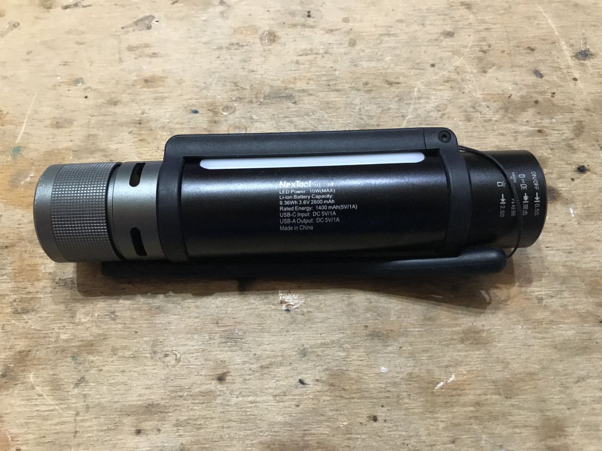

    Of course, yes - some time ago I bought a NexTool NE20030 flashlight which I really appreciate .
    When I was buying it, it was shipping from the Czech Republic and it was a bit cheaper ...

    Initially, I even wanted to do a test and a photo gallery from inside to this section, but ... I am not able to disassemble it (no screws, hooks, anything?), It's a pity to destroy it:
    Plastic flashlight-powerbank from China for 18650 cells, "800W" Plastic flashlight-powerbank from China for 18650 cells, "800W" Plastic flashlight-powerbank from China for 18650 cells, "800W"
    Here, of course, the housing is made of metal and solid. Magnets for putting away the flashlight too, I keep it always "glued" to the metal leg of the table.
    This flashlight is really strong, it still serves me when I go to the basement or the attic. The beam of light is so strong that when you spend a moment in one place, it heats up.

  • Lack of over-discharge protection in cheap 18650 powerbank

    I do not like this system a bit, I do not see any protection against over-discharge of the cell here.
    Maybe they are based on a security built into the cell.
    Thanks for such a teardown, it opens your eyes to the crap they're offering. If the housing were decent, it could be used as a base for building your own flashlight. And so it only adds to the amount of garbage on the planet.

  • Suspected HT4921 charge and boost controller
    #10 19864553
    E8600
    Posts: 8984
    Help: 529
    Rate: 2520
    an unsigned element in the SOIC8 housing that looks like a charge controller / step up converter, then the current goes through it from VIN to the battery, and from the battery to 5V (there is a larger 2R2 choke, which suggests that it is a step up converter, of course you have to also a rectifier and a keying transistor, but they are probably integrated in this circuit)
    It could be a deal HT4921
    I would stick to the measurement of the current / voltage on the battery, unfortunately these converters do not sin efficiently and it would be useful to measure how much goes directly from the LED converter, in my opinion much less.

Does the PCB protect against over-discharge or over-charge?
The teardown shows no dedicated protection IC; safety may rely solely on weak converter cut-off or cell-integrated PTC, both unreliable for deep discharge below 2.5 V [Elektroda, p.kaczmarek2, post #19863146]

Which budget Chinese flashlights are worth buying?
Forum members recommend the Convoy S2+ (SST40 diode) at ~PLN 60 and the NexTool NE20030 for stronger output and magnetic tailcap [Elektroda, Jawi_P, #19864668; Elektroda, p.kaczmarek2, #19863146].
