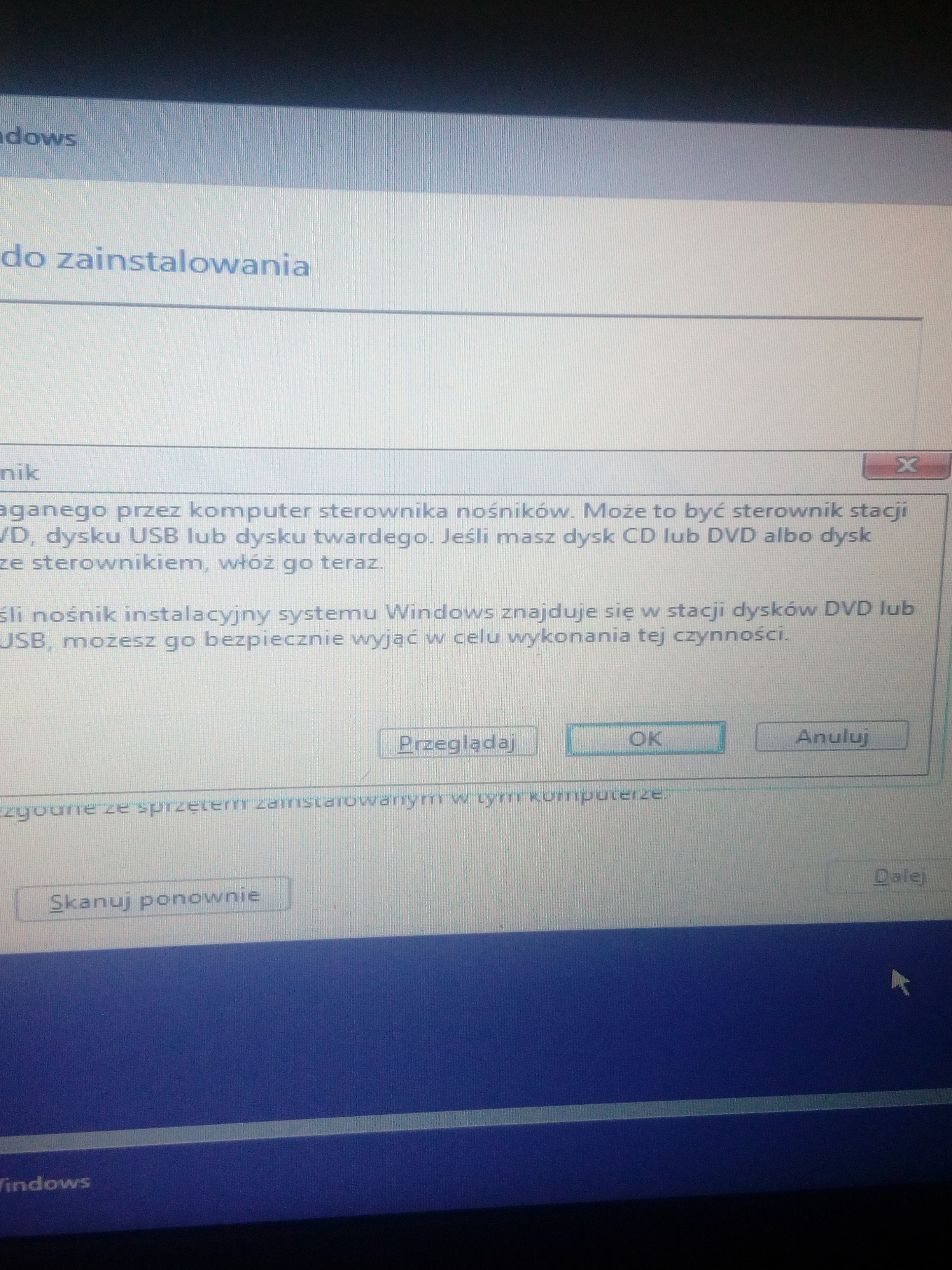

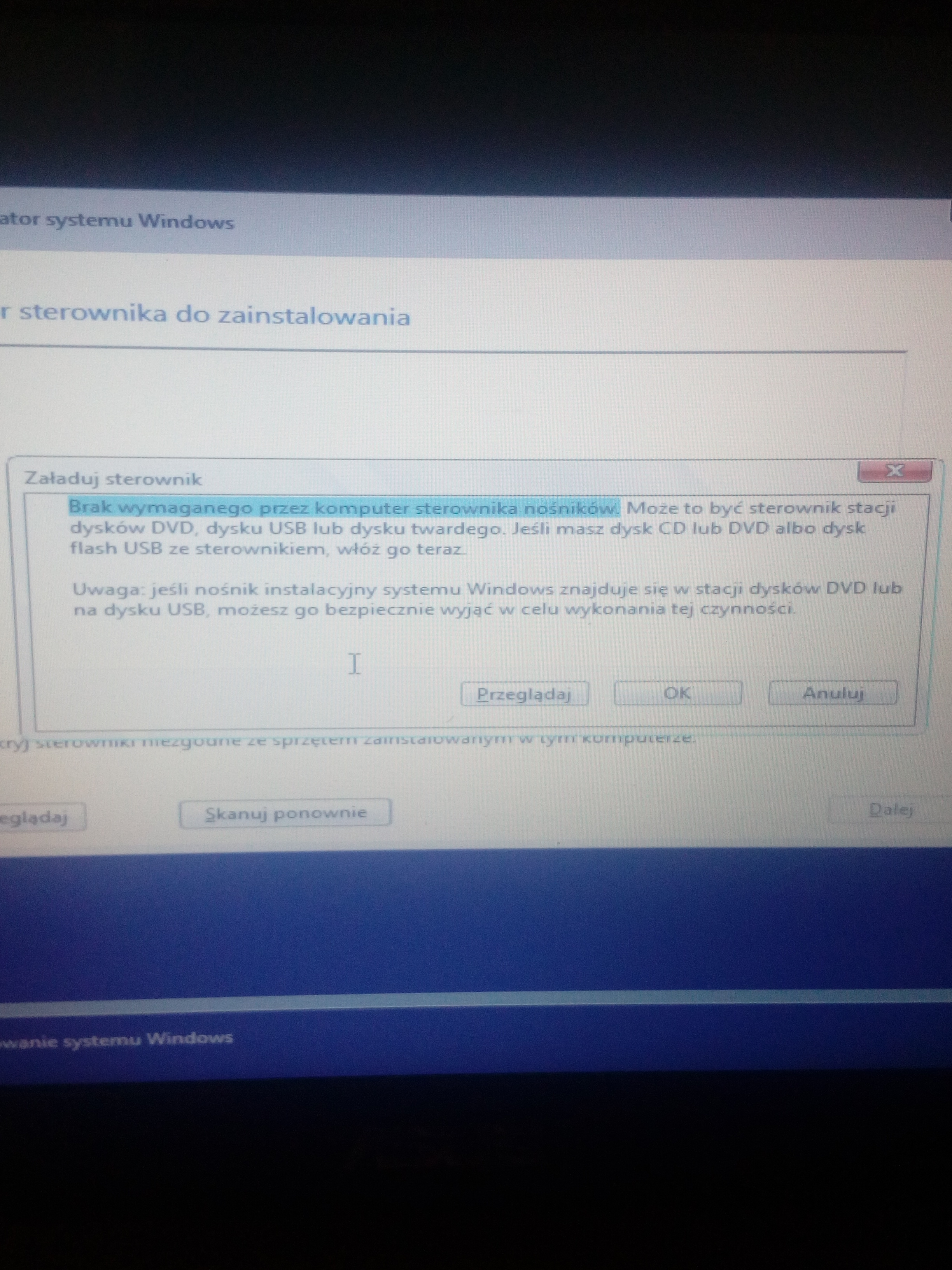

    Maybe you would write some details about the computer, is it a laptop? stationary? Are we supposed to come to this telepathically?
    After what you can see, there is simply no driver for the disk controller on the installation CD. Nobody would help here more, because there is no information that you could relate to.

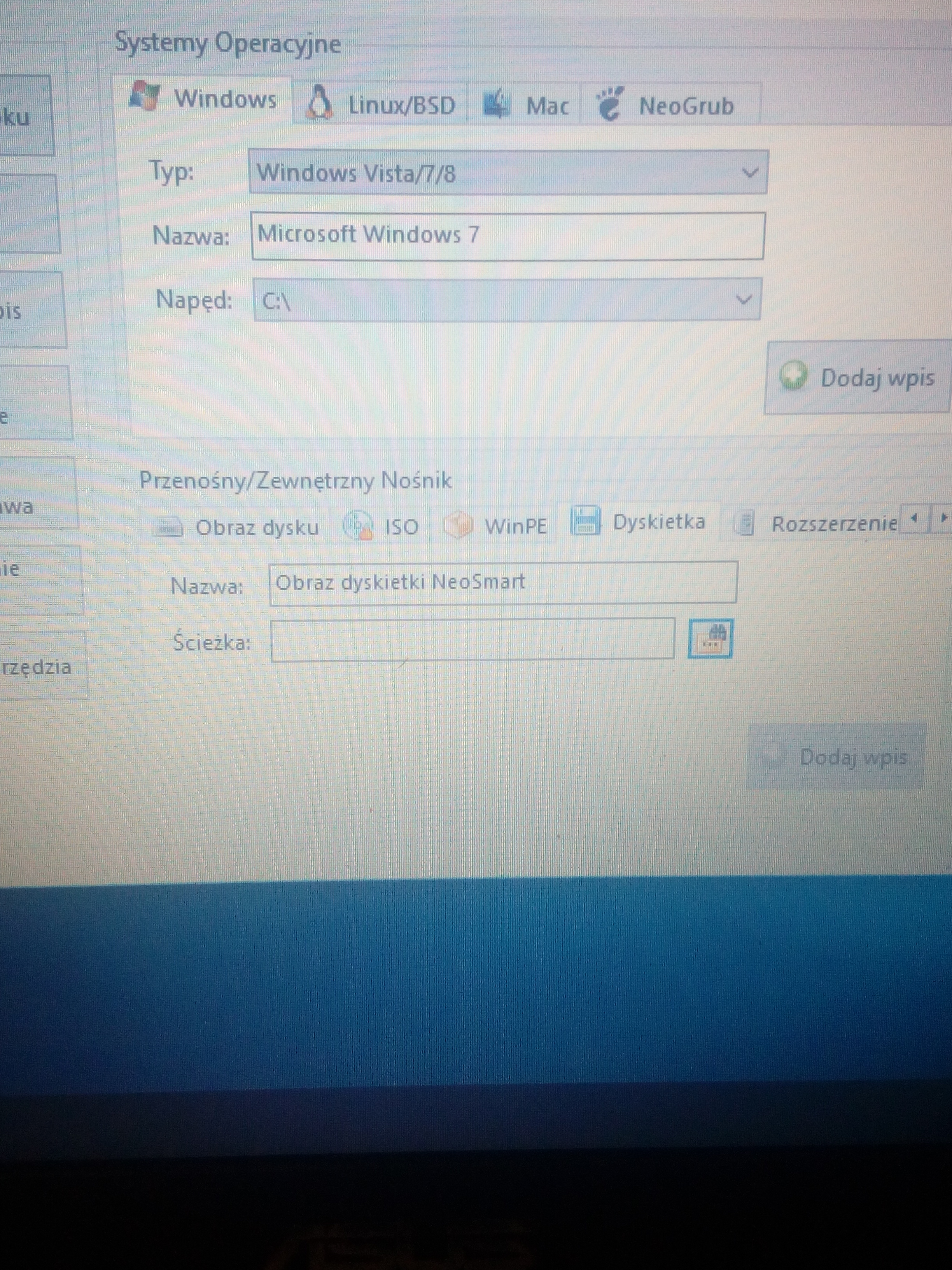

    kolmar3 wrote:
    I copied the iso CD from win 10 to files and folders and saved it to the recovery partition using the easyBCD program.
    And this is probably a mistake. Recovery is not so. What you did was try to install the system from the hard drive instead of the optical medium and do something wrong. Install the system on a clean disk. If you have a DVD drive, install it normally from the CD or here you have instructions on how to do it without a disc:
    How to Install Windows 7 or Windows Vista on Physical Machine Without DVD Media .
    Special programs such as Acronis True Image are used to create recovery. The program can do a partition image to a file or to a hidden partition from which you can later start the computer with a specific key and restore the system.
    Personally, I do not prefer such combinations, it's better to simply image the installed system to a file that can be easily copied to other media (pendrive, portable disk)

    Why do you need to run the restore from the Windows menu? Do it this way:
    [*: 592add8b11] install Windows on one large partition without 100MB partition - Shift + F10 during installation, program diskpart and create the primary partition active on the system and the second or several partitions depending on how big you have the disk
    [*: 592add8b11] start Windows and format the partitions you created in NTFS
    [*: 592add8b11] make a bootable flash drive with an image capture program, eg this EasyUS
    [*: 592add8b11] start the computer from this USB and make a system image to the file by placing it somewhere on the D partition: e.g. obraz.img is the extension used by the program [/ list: u: 592add8b11] Now if you want to restore the system then you start the computer from this pen, you start EasyUS and restore the system from the file D: \ obraz.img on partition C:
    I do not think it's easier.
    And if not then try this Acronis - it will add support for the MBR button and not the BIOS. If you want, test the program in the virtual machine first.
