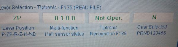

    Hello, I have a problem with the car as in the subject. Quite often, usually after a short drive, after turning off the car and when trying to start again, you can not start the engine. The chest after switching to P and N cannot see this position. On a board it looks like this:
    Audi a4 b6 2003 automatic - automatic gearbox, does not start, does not see P an
    After switching to R or D on the meter, these positions light up, so they probably work.
    In the parameters when the engine cannot be started and P and N are not selected, it looks like this:
    For the Parking position, the "lever position" and "gear selected" parameters do not match, ZP-N (if everything is ok, these parameters are the same, i.e. PP):
    For the Neutral position the same situation, the parameters ZN-N respectively, as everything is ok, the parameters are the same NN:
    It is usually helpful to turn the ignition off and "rock" the car in the P position. After this operation, you can usually start the car and select P and N.
    There are no fault codes stored in the gearbox controller.
    What can the above symptoms indicate?

    On the selector ...

    The selector plate with sensors was disassembled, corrected in February, checked that the magnets are in place, everything looks ok. Unless something deeper can be damaged.

    And the gearbox driver is dry ....
