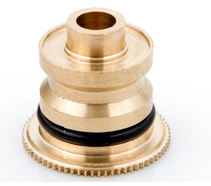

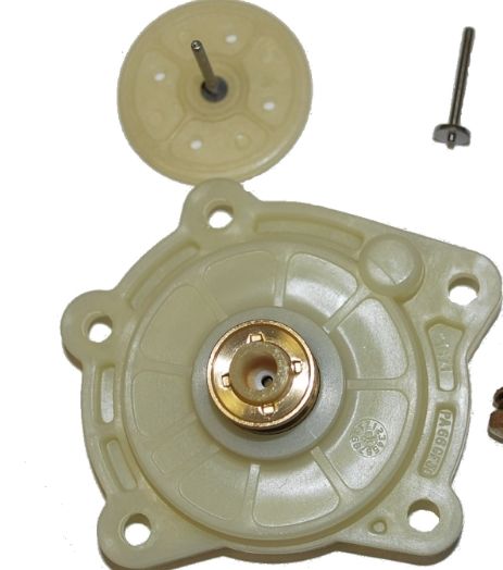

    Hello . I have Junkers Maxipower 2 Wrdp 11-2B. Once a familiar technician told me to clean it every two years. Well, I undressed the copper inserts which heats the water (rinsed it with water), and the nozzles I blew out with air. After folding, EA did not light up and you could hear the igniter trying to smoke and nothing. I called my friend, he said I could smash the membrane. I got to the membrane but it's all in. I folded it and now I get an error F0. After pressing the on off button, listen to the spark once and it lights up F0. I am asking for help, I have called the service technicians in my area and they can do it on Monday at the earliest.

    Replace the battery. Moisture no contact. Set the micro switch. Coils do not shut off the gas Ultimately the controller.

    It works :) )) Thank you very much for helpful and quick statements. After the pictures found on the internet and of course hints I came to the point that I had mounted the electrode incorrectly (not in my place just too high) and probably that was the reason for the EA error. As for the error F0, I have replaced the batteries according to the suggestion of serwisszulborski.pl and have adjusted the microswitch.
    I have one more question, one of the technicians pulled out a circular net between the upper coil and the nozzle, which is together with the electrode, saying that this grid creates only problems.
    Honestly, I checked now and with the net was only about 4-5 leaps over the spark, and how I pulled it in. What is your opinion? greetings

    I have a stove with a mesh, there was never a problem (my stove is just a stronger version - WRDP 14-2B). The grid should be. Maybe it was clogged, and so there was too little air in the candle (these stoves have a candle that only lights up for igniting the main burner - Vaillanty does not have a candle at all). The grid should be.

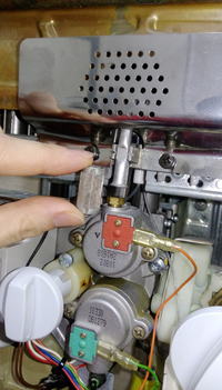

    Hello, can you tell me how to adjust the microswitch on which you write above? I have such a symptom with a heater: it normally fires but during work it can 2-3 times go out and start again later automatically. It looks to me like the water flow is too small and the stove goes out. This does not happen every time you start, it works more often all the time as the water is unscrewed. I'm not a professional, but it looks to me like the microswitch setting on the border of maximum water flow.

    I'm not a specialist but from what I remember, I first undressed the micro switch to see how it is built (no policy) and the regulation is in the middle on such cloves. I unscrewed the switch and held my fingers from the top with a small screwdriver in the place marked with the arrow RED in the picture. You will hear a click while setting up. On the turned off junker let go water watching micro in the place of NIEBIEJKIEJ arrows switch if you do not hear clicks, that is, you have to move it slightly on the cloves. For me, this click can be heard practically immediately while letting go of water.

    Clicks MAY BE HEARING immediately after letting go of water. If you hear a delay, it means that the "microbrew" is wrong (wrong adjustment, bad installation, wear). The assembly / disassembly of the micrusa is almost trivial, except that the screw that secures it to the stove is bad access.

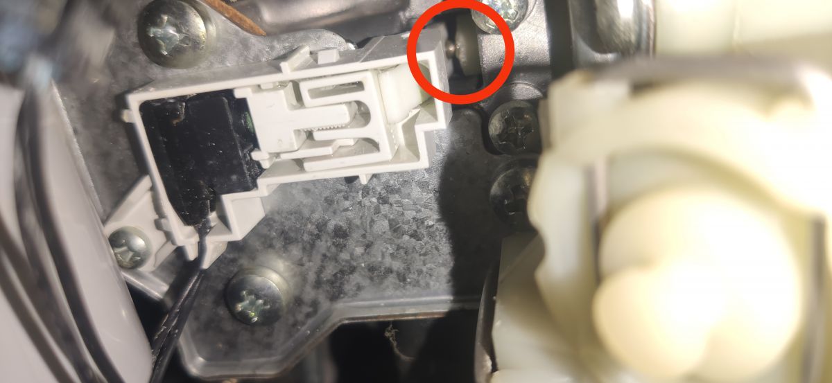

    The cooker doesn't start either, even the spark doesn't go out when the tap is turned on. Only a gentle rubbing of the microstroke starts the cooker up.
    What could be the cause? It is obvious that the microstick needs to be readjusted, but what about the dripping water? Image of a Junkers heater component with the water leakage point highlighted.
