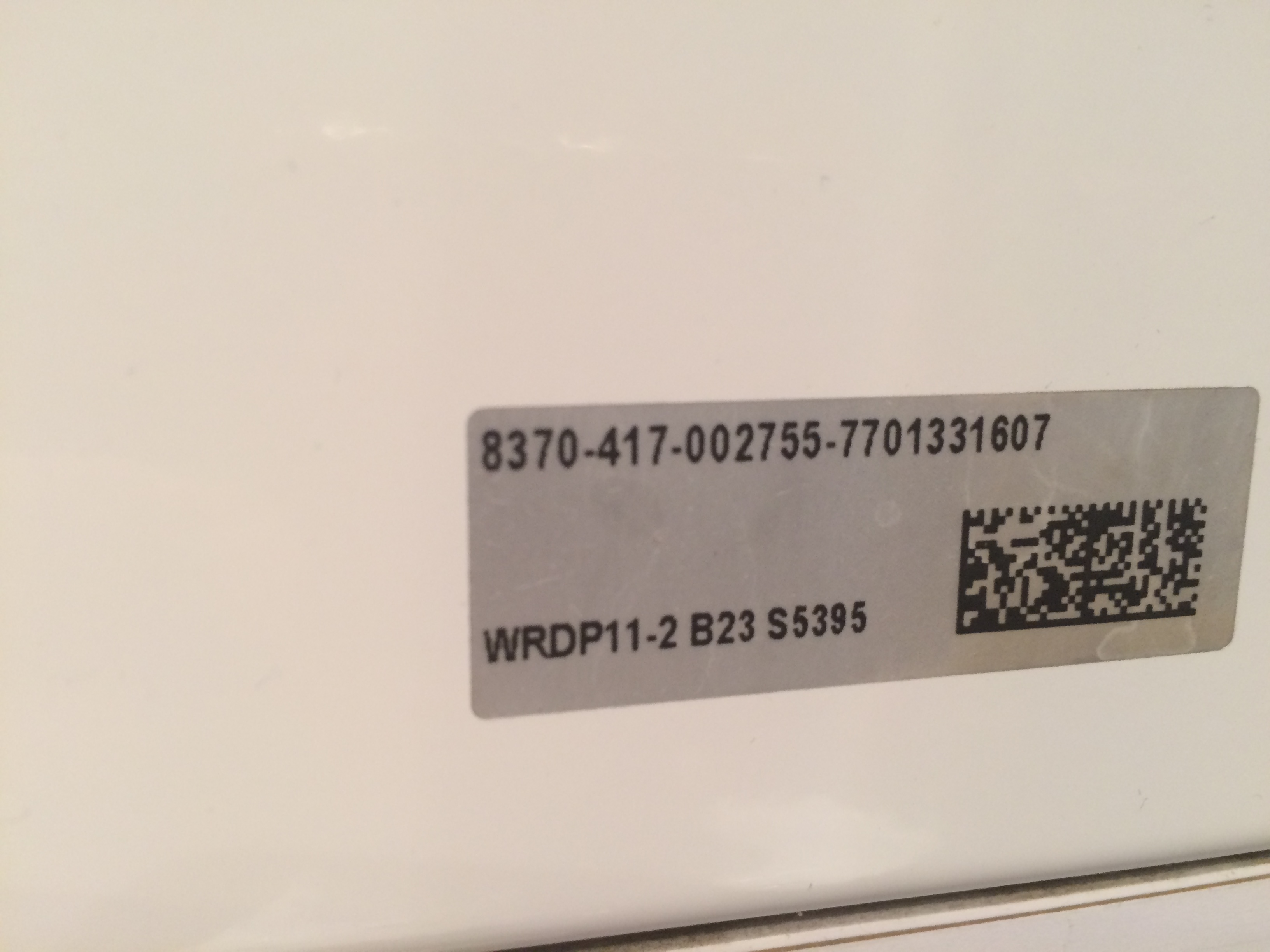

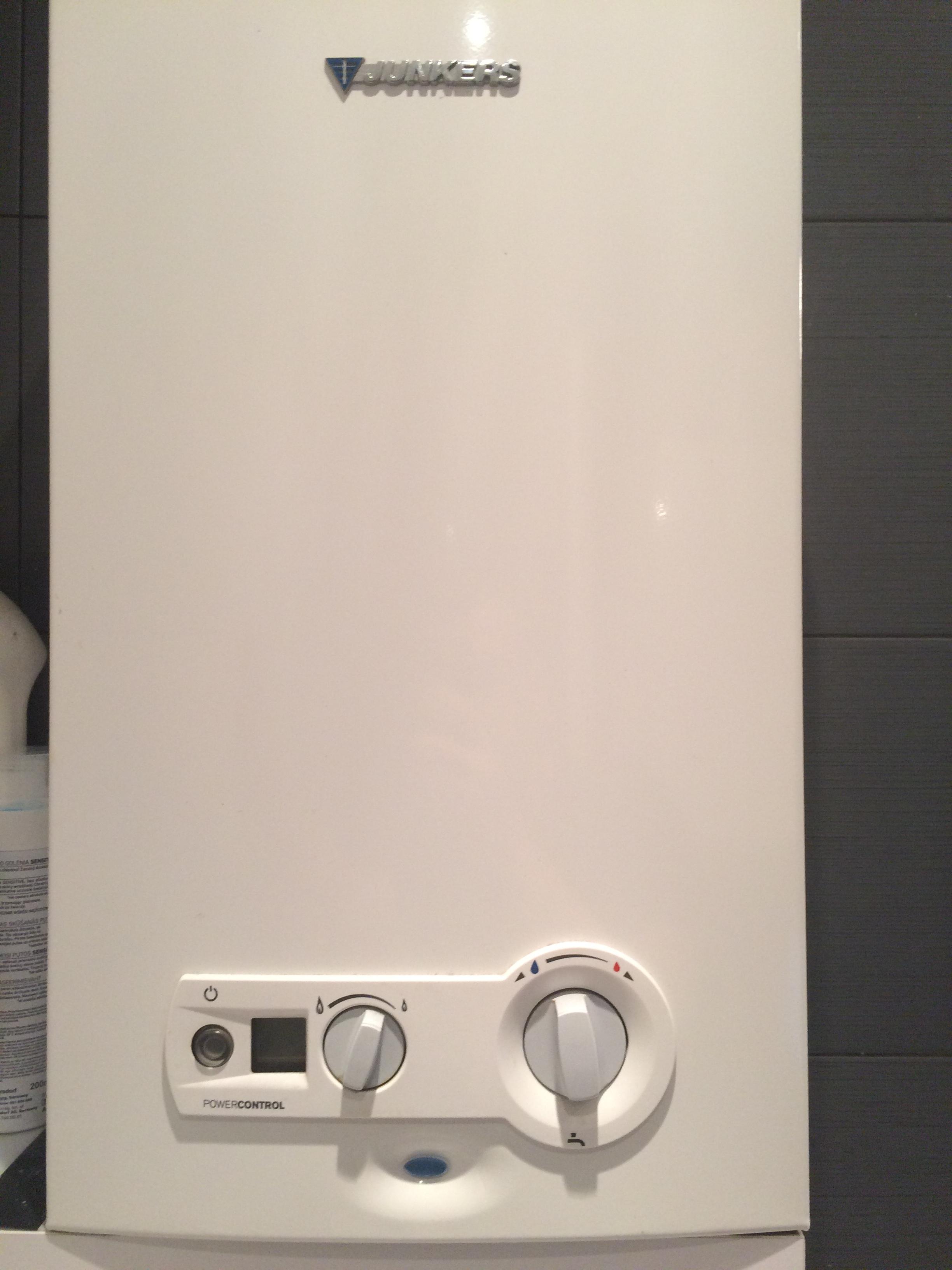

    I have had it for over 3 years Junkers WRDP 11 - 2 B23 with display.
    Junkers generally works without problem, ignites quickly and heats the water.
    The problem arises, however, when you do not want to use the junker.
    Namely, usually after a fairly long time from turning off the water and the junker goes out, after about 2-3 hours, there is a problem that when the water is not turned on, the junkers seem to turn on by itself - first you hear some kind of knocking or slight crackling, then a gentle squeak, the display turns on in turn - the temperature rises - from 20 to 40 degrees, then the red light under the display lights up, the EA error appears on it and everything turns off and goes away - the EA error remains. I note that it happens completely arbitrarily, without turning on the water.
    If after that, for example, I turn on the tap normally - the junkers lights up normally and quickly and heats the water.
    Thus, the junkers fulfill their task all the time, because it works and heats the water, but its kind of turning on and tapping is annoying - which usually happens late in the evening or at night.
    Does anyone have any advice on what it can be and tips on how to remedy it. I have read many similar topics and the junker's manual before, however I have not found a similar problem and its solution.
    Thanks for all helpful advice and time.

    It seems to me that the temperature rises only on the display - but there is no water, no gas, no flame - so probably something with electronics.
    Yes, a 10-story block, I am on the 3rd floor.

    You will need to do a little test: when not using the Junker, close the cold water supply to the above-mentioned. devices.
    Are there hours in which this phenomenon increases?
    There are no leaks from the junkers?

    Usually in the evening and at night - but on the other hand, during the day we are not at home, so I do not know, and immediately after returning from work it is loud and I may not hear it, and when it is already dark and the children are asleep, it is quiet and then you can hear all the sounds from the bathroom :)
    There are no leaks.
    Test - turn off the cold water tap on the turned off device and then what to do?
    Observe whether the junkers will try to start automatically.
    You are probably dealing with high pressure drops in the block as well as subsequent water hammer.
    If the symptoms disappear after closing the valve, what I wrote above will be confirmed. But I am not 100% sure.
