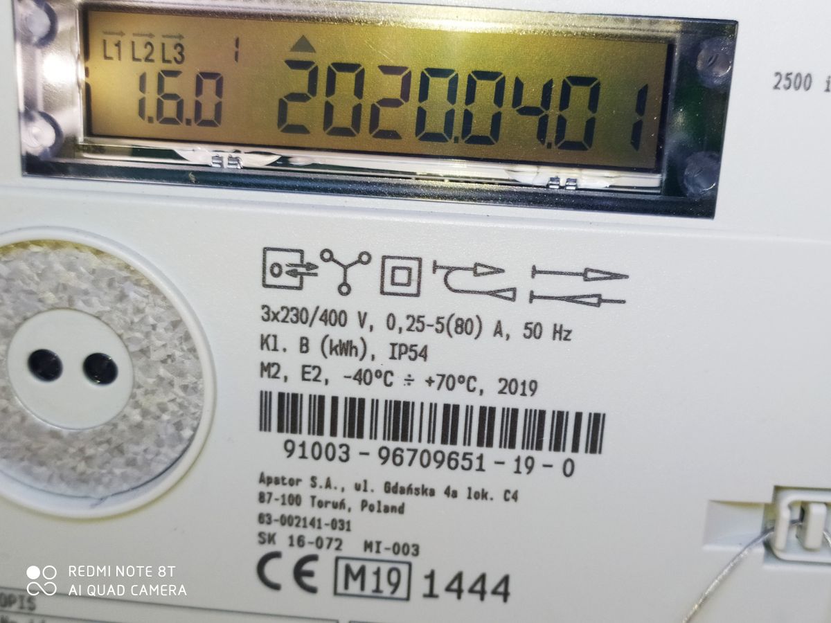

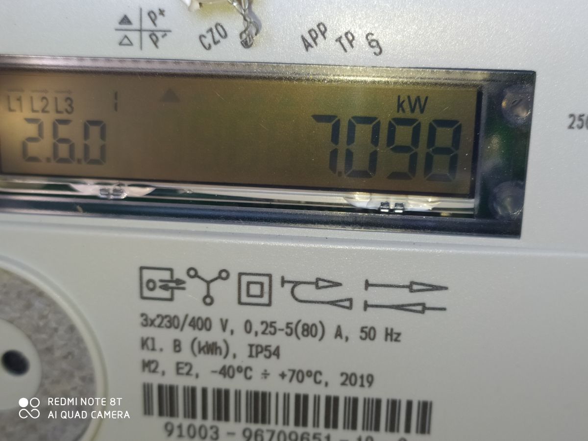

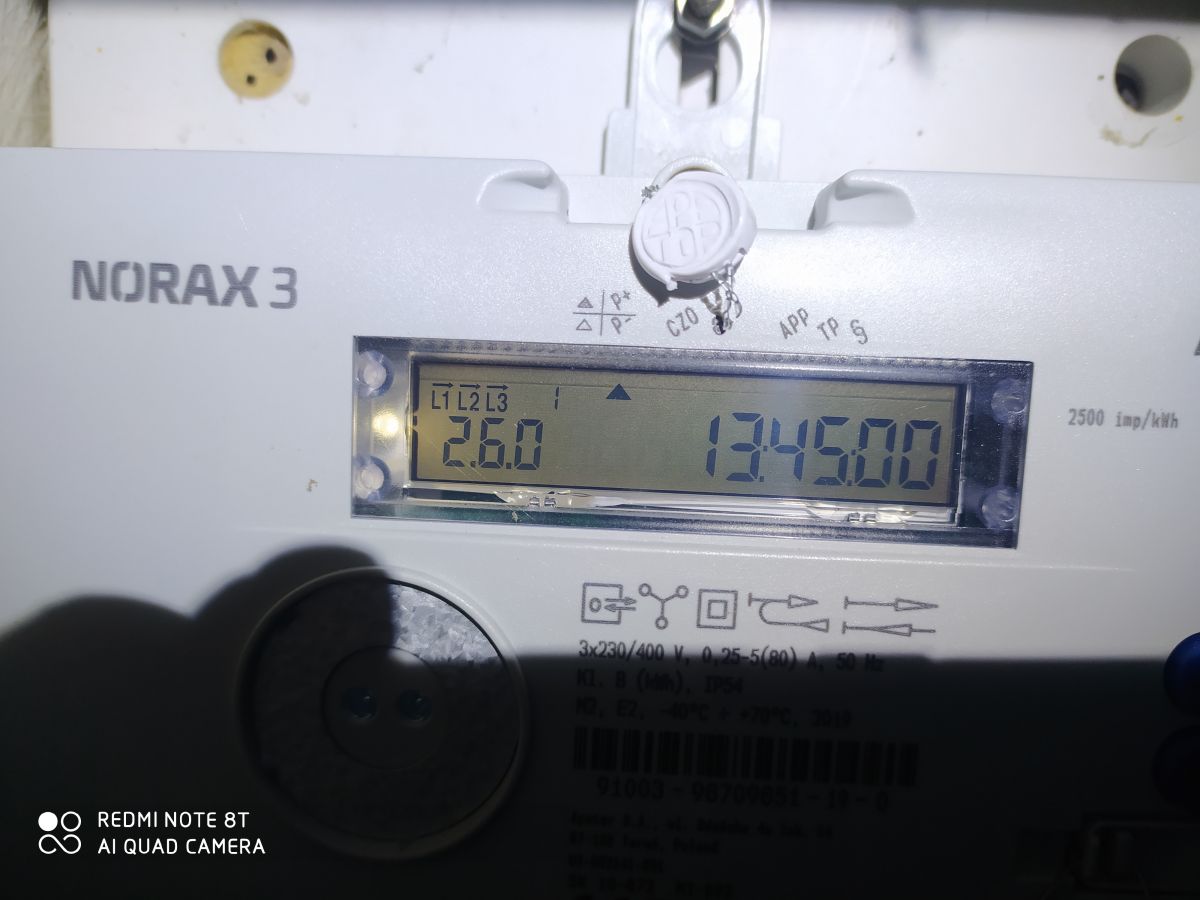

    Hello in November, I have a NORAX3 counter, I have strange readings that do not match the obis codes
    Code 2,6,0 shows me 7,032 Kw and the next 2,6,0 shows 13:45:00 how to read this
    And the second reading is 1.6.0 Kw 2020.04.01 that is the date and time 15.45.00
    My question is what is this code and why they have different values

    This is the instantaneous power consumed in 15-minute periods and the time when this event occurred. After that, the collector can see if you are definitely not exceeding the contractual capacity.
