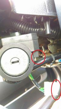

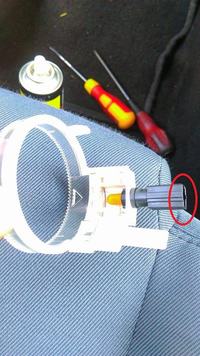

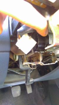

    Here we go:
    Following the advice of a colleague above, I carried out programming using the "6 phrases in 10 seconds" method, which I found on the internet. In general, the central lock functioned all the time. No direction blinks, no response to programming. I tried several times.
    1. I cleaned the masses under the hood, checked the fuses under the hood and in the cockpit - everything was ok
    2. In the pictures below, the ignition switch housing is dismantled. In the red circles I have marked the elements that have been cleared.
    Nissan Primera P12 1.8 Gasoline - Turns but does not start, the fans are working
    3. After assembling the cubes, I made the first attempt to fire, unfortunately zero reaction, even worse did not turn. In subsequent rehearsals he randomly spins / did not shoot, but did not fire.
    Suddenly something puffed under the hood like a relay and silence. Complete lack of response to the key. Even the control boards did not light up. I waited a second try again and began to spin. It does not start again.
    Tips on the clocks when shooting the starter were twitching. ABS indicator and one more but I do not remember, they were flashing.
    That directed me to a certain reflection.
    Some time ago I had the same problem in the b5 1.8 turbo pass. After replacing the cube, the ignition stopped.
    I will add that during the ignition, the fans are working like yesterday.
    Have you met someone with a damaged ankle of the ignition switch?
  • #8 16349436
    robokop
    Posts: 29412
    Help: 1763
    Rate: 6372
    The driver sees the engine revs during filming?
  • Ignition switch change ineffective; checking immobilizer and crank sensor
    #9 16349627
    AutoMotion
    Posts: 25
    Rate: 13
    Small update. I changed the ignition switch to another efficient one and, unfortunately, no effect.
    A small question: Is it going to be played after the same immo reader has been ejected about the antenna around the ignition? Do you need to encode something? Because it does not give me peace of mind that the board on the immo once glows once. Perhaps the problem lies in this loop
    As for the turnover, I did not check it.
    Could it be the question of the shaft position sensor?
  • Check engine parameters and immobilizer before replacing parts
    #10 16349705
    robokop
    Posts: 29412
    Help: 1763
    Rate: 6372
    Buddy, are you kidding yourself, do you just have too much money and you'll be exchanging things at random? Diagnostics consists in checking the vital parameters of the engine electronics system, without checking the errors. Looks at first whether the engine has everything he needs - that is, supplying all the systems, previews or sees the crankshaft rotation, finally if the lamp immobilizer lights up suspiciously, it works whether he sees and recognizes the key transponder, and then whether it allows the engine to start. Until then, I'm blocking the thread, because it's another stupid tapeworm, without any details or views of the positive finale.
