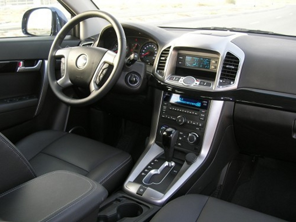

    I am looking for a wiring diagram, a factory-fitted air conditioning display, and a factory reversing camera in Chevrolet Captiva 2011.
    Chevrolet Captiva - Air conditioning display connection diagram Chevrolet Captiva - Air conditioning display connection diagram Chevrolet Captiva - Air conditioning display connection diagram
    I am interested in the differences in the "pinology" in the navigation display plugs and the normal temperature display, and the output (pin) of the factory reversing camera.
