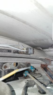

    Hello, in my Chevrolet Aveo 2009 hatchback the central locking is mounted, unfortunately I do not have a remote control for it. I bought a central locking controller with remote controls and found a video where a certain Lord connects the same in the same car. The movie is in Russian and I don't understand much of it. I am asking you to explain to me what is in the video made from 12:03 to 15:30. I know I should go to an electrician, but I don't have the opportunity right now. Thank you for your time.
    https://filmy.elektroda.pl/7_1525341169.mp4

    It assumes an additional servomotor in the driver's door which controls the factory one, in the door grommet you need to make 2 holes for the wires to the servomotor, finally connect the output to the directions under the emergency button.

    ok, and this extra cylinder is needed? Is it possible to connect straight to the factory actuator? I saw where he connected the mass, but what did he do with the plus?

    There is no factory actuator in the driver's door, unless you mount it from an Englishman.

    ZielonaWielkaStopa wrote:
    And if the remote control was able to open the whole car for me, do I have to add this servo?
    You should have it in the door or castle.
    And why can't you check what's in the door?
    Now the central one works with the key :?: , you don't have a remote control, so the remote control doesn't work.
    Did you find the lock central? Original or added? You could unplug it and connect the bought one in its place.
    Lanos like lanos, this one did not have an actuator, but as this auction is correctly described, with the cylinder you can see the plug.
    http://allegro.pl/zamek-przod-przedni-lewy-chevrolet-aveo-02-11-i7276607676.html
    Chevrolet Aveo 2009: Central Lock Controller Installation Guide (12:03-15:30) with Remote
    It's an actuator. As it has contacts inside, the actuator is integrated inside the lock. At least for me, because the color of the cables does not match.

    Yes, I need to open the car with the key. And when I open the driver's door, they all open and close. This is what my door looks like. These 3 cables go towards the lock.

    You don't have an actuator in the driver's door and there has never been a pilot-end / dot with this car

    Ok, I ordered this actuator, it should come in a week. I bought the car with a spare key, and I checked on the Internet that for this model in the main key there were buttons for closing and unlocking. And I also thought that if there is a central locking then there should be a pilot.

    And what difference does it have, three cables flying to the lock, where does the actuator come from? When the actuator sits, there are 5 cables.
