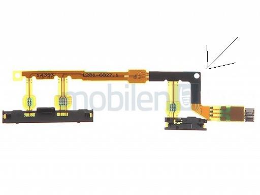

    Yesterday I replaced the screen with the housing in z3 by accident a little too much with a puller when I pulled out the motherboard and the vibrator tape broke. I ordered a new one immediately, but I wanted to check if the screen works and the backlight is lit but nothing on the screen is happening. When I connect the charger, the LED lights up red when I connect the phone to the computer, it detects it, but the screen still shows nothing. I have a question, could the trail hit me with the motherboard or could it be the fault of this tape?

  • #3 16351219
    leszczu211
    I am at work now and I have no way to take a picture but it is broken where I marked the arrow. When I am at home, I can send a photo of how it looks exactly Sony Xperia Z3: Screen Replacement, Black Screen Issues, Vibrator Tape Damage & Potential Causes

    Well, it's the Z3 compact or the Z3, because that's a big difference. As compact, this tape has nothing to do with the display.
  • #5 16351634
    leszczu211
    z3 compact. So I have to adjust to the damaged disc? Not good...

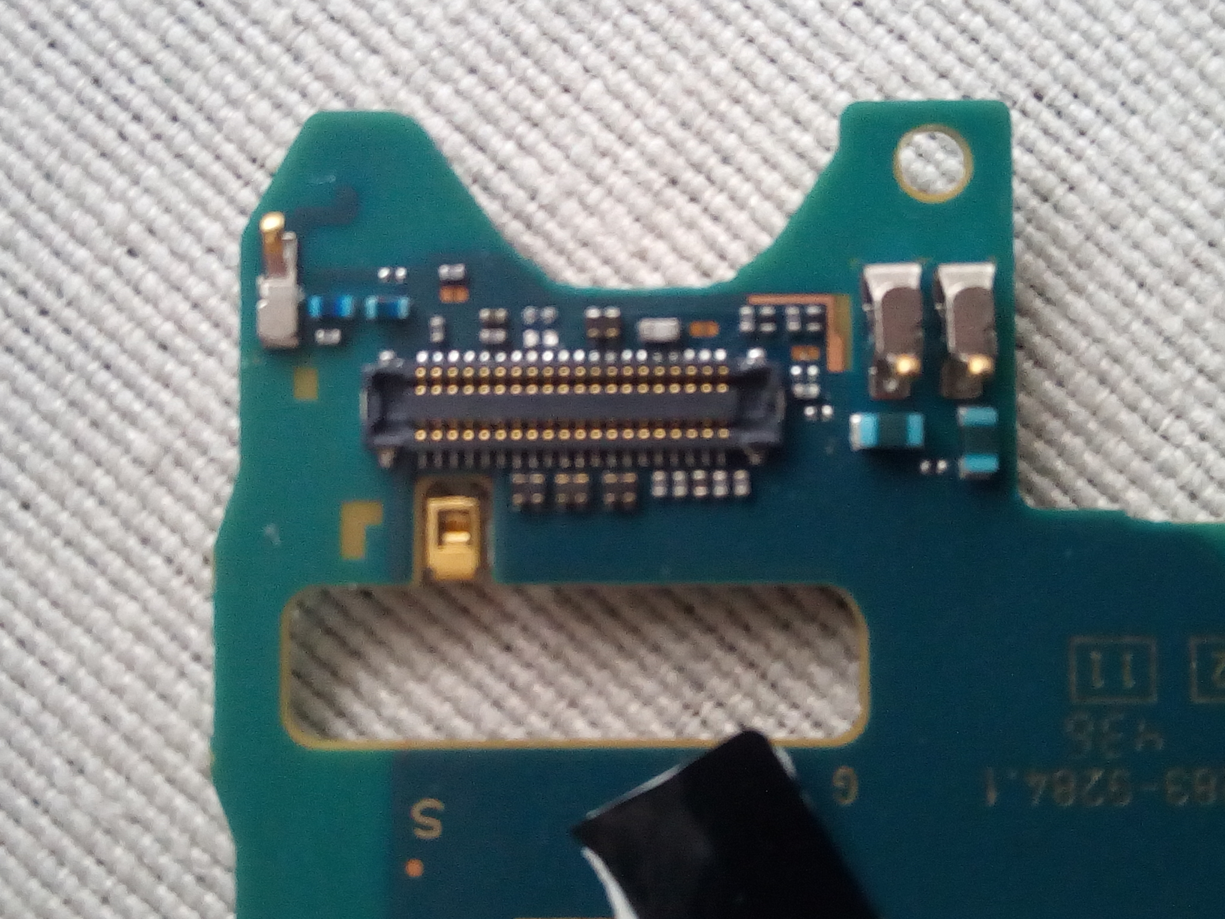

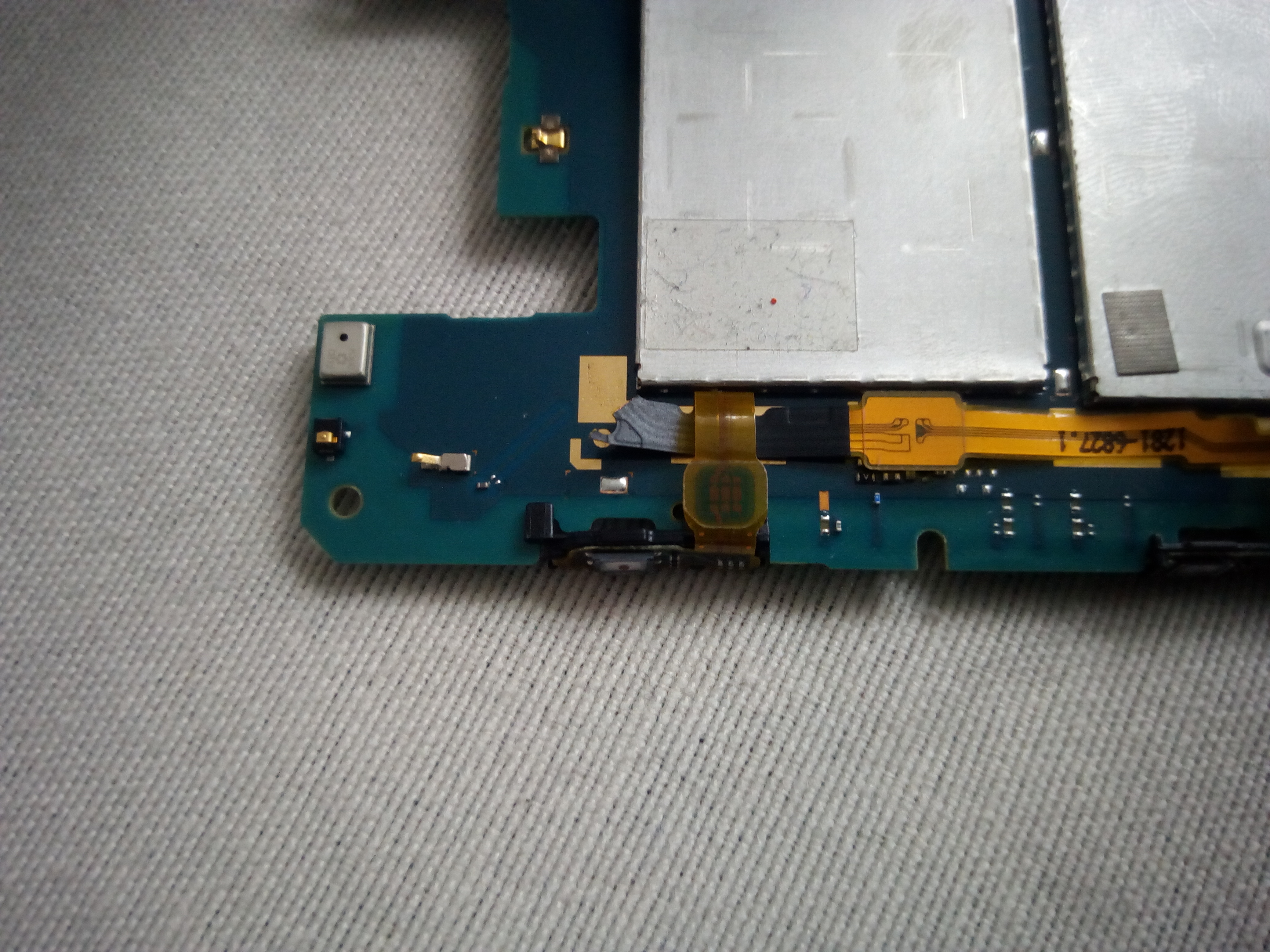

  • #7 16352244
    leszczu211
    As I wrote, these are photos of the socket and the torn tape. I read something about a damaged fuse, could it be it? So where do I find him? Sony Xperia Z3: Screen Replacement, Black Screen Issues, Vibrator Tape Damage & Potential Causes

  • #9 16352345
    leszczu211
    I have the impression that I didn't have one fuse there ... You think so too? Sony Xperia Z3: Screen Replacement, Black Screen Issues, Vibrator Tape Damage & Potential Causes
    #10 16352790
    Adrian4477
    Posts: 1464
    Help: 179
    Rate: 184
    Yes, you tore out one of the filters when you pried up the tape. A good service will deal with it (and if you don't find it, write PW - I'll help).
