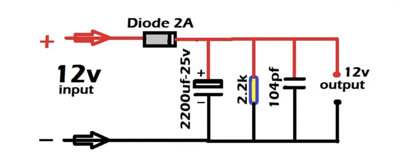

    Just make a filter on the camera power supply with:
    - 2200uF 25V capacitor
    - 104pF capacitor
    - 2.2k resistor
    - 2A diode
    Tested on a Peugeot 208 from 2013 with a similar case. Attached is a photo and diagram.
    • Rear View Camera Fails with Engine Running: Possible Voltage Issue? B9CFA0F2-5558-42EA-8C95-6BF0BFFDAC42.jpeg (1.27 MB) You must be logged in to download this attachment.
    • Rear View Camera Fails with Engine Running: Possible Voltage Issue? IMG_2768.jpeg (54.6 KB) You must be logged in to download this attachment.
    - 104pF capacitor
    - 2.2k resistor
    - 2A diode
    I would give 105pF ;)
    The electrical installation in cars is made for the designed receivers, i.e. lamps, engines, actuators. And not for sensitive audio and video signals. So, the camera ground should always come DIRECTLY from the radio (not from the bulbs or bodywork) and the power supply can come directly from the bulb (but not LED PWM), but it should be filtered using the signal ground from the radio. If someone doesn`t really understand what`s going on, take +12V from the radio connector. The camera can work all the time with the ignition on, it will be fine, even better because it won`t fog up. However, from the reversing lights you need to take a control signal informing the radio that the reverse light is on. And there is no point in trying anything else, unless there is also PWM in the power supply for the reverse lamp, it is not known why. But in new cars it is possible.
The discussion revolves around a rear view camera that functions correctly when the ignition is on but fails to display a video signal when the engine is started. Users suggest that the issue may be related to voltage fluctuations caused by the alternator. Solutions proposed include ensuring proper wiring, using a dedicated power supply from the fuse box instead of the rear light, and connecting the control signal from the reverse light. Several users report success after using a relay and recommend specific relay types and configurations. Additionally, filtering the power supply with capacitors and diodes is suggested to stabilize the camera's operation. The importance of grounding the camera directly to the radio rather than the body or bulbs is emphasized to avoid interference.
