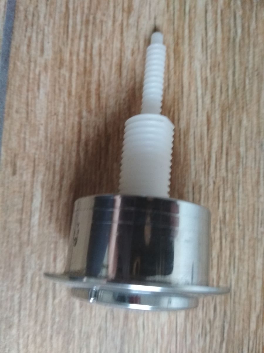

    I removed the cistern button and put a rubber disc about 2mm thick.
    We unscrew it from the tank -: - unscrew white nickel-plated housing (right-hand thread) -: - pull out white nickel-plated threads (are pressed in) -: - cut out something with a slightly larger hole than the spring -: - assembly. The pad will cause the "3-liter button" to have a smaller stroke.

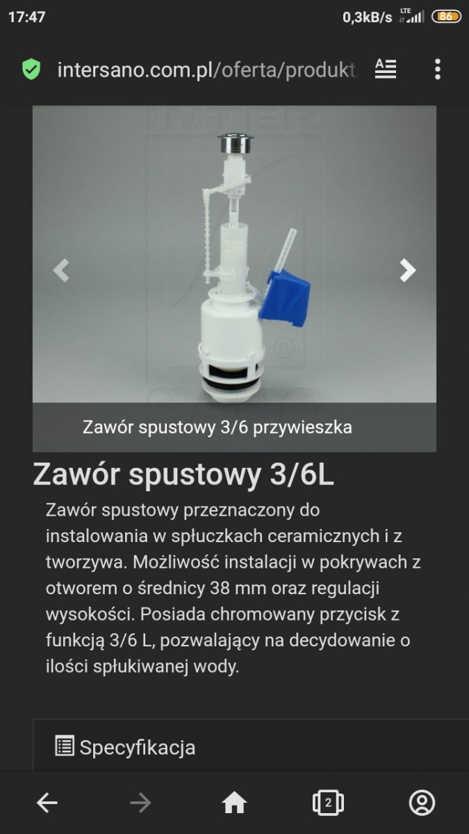

    I also had a problem with this valve.
    I was able to determine that:
    Cersanit K99-0014 is the same drain valve as Intersano's EAN 5903338303049.
    The manual can be downloaded from the manufacturer's website or below.
    The blue float is used to determine the amount of water for the small button.
    I hope it will be useful to some.

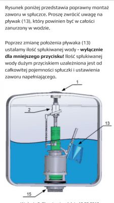

    The lever with a float on the cistern's trigger mechanism should be completely submerged in the water, then the option of lower water consumption works.
  • Adjusting the blue float for reduced flush volume

    avacon wrote:
    The lever with the float installed in the cistern drain mechanism should be completely submerged in water, then the option of lower water consumption works.
    The manual does not include basic information about adjusting the blue float. If we want to reduce the amount of drained water with a smaller button, do we raise or lower the float?

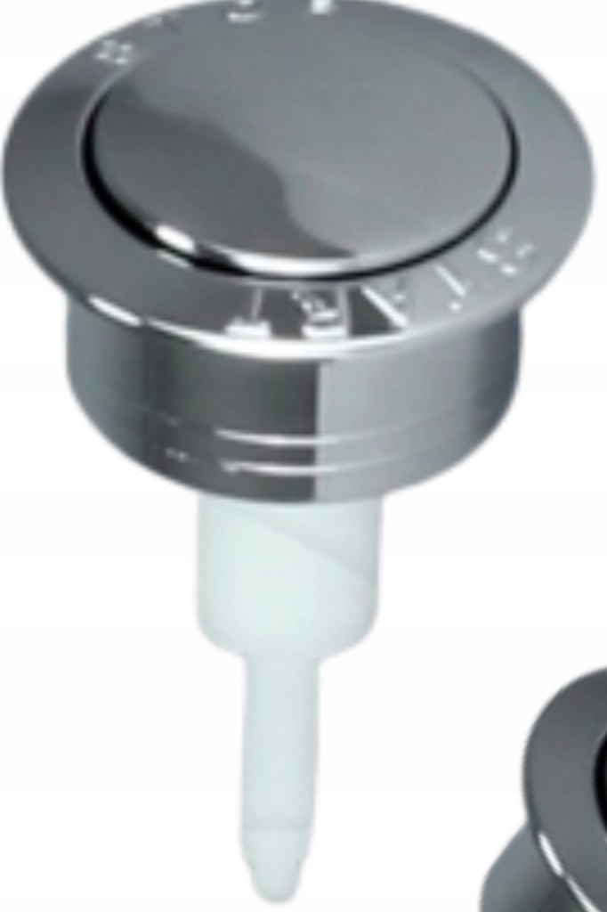

    I would like to inform everyone that the 3/6 L drain valve (Inter Sano EAN 5903338303049 or Cersanit K99-0014) also has a start-stop function. Even the manufacturer of the valve does not inform about this function on its website. The stop function works with the second press of the large button.

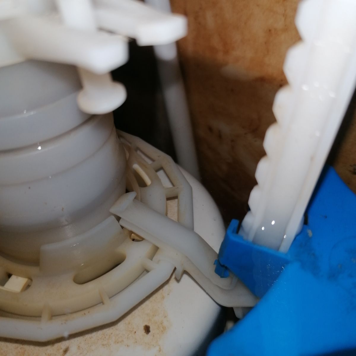

  • #18 21412296
    kay6
    As for the float adjustment not working, it was the same with me. The solution was to wash out the float with the lever and plug it in a little further on the crown. Previously, the lever was resting on a piece of plastic (in the photo to the left of the lever) which puts the adjustment option out of use.

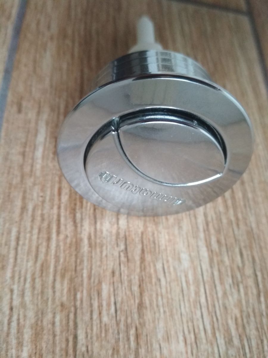

    I bought a start stop button and have control over the amount of water drained.
    Chrome start-stop button for a toilet flush. .
