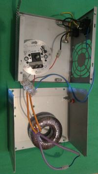

    I am looking for advice about the power supply for cutting foamed polystyrene.
    I have:
    - dimmer up to 300W with built-in fuse
    - 50Va toroidal transformer
    - kenthal resistance wire 0.3
    - some wires and plugs, crocodile clips, meter, on-off switches
    assumptions
    - a box for easy carrying
    - safe (not shocking)
    - for cutting foamed polystyrene (wire length ~ 1100mm)
    I started to turn the whole thing and here I have a question for you whether I am going in the right direction
    what to add (some fuses diode resistors ????)
    which is possibly wrong
    I will add that the photo shows a short-circuited transformer at the output for symbolic resistance wire. (purely illustrative.)
    Thank you in advance for any help.

    Is the dimmer adapted to control the transformer's inductance? If not (usually dimmers are controlled by incandescent lighting) there may be a problem with the transformer - it may either burn after a while, or you will not get control.
    Correct the first post - I understand that you gave the transformer power, not its voltage?

  • #14 16363609

    wenar
    Posts: 9
    RitterX wrote:
    Reduce the resistor, the value of the potentiometer, the RC system controlling the triac gate by the DB3 diac. Adjustment on the secondary side is not enough that it is better for trafo is even safer from the point of view of use. You don't have to worry about the maximum triac current. Usually triacs of the order of 8A and more are inserted ..
    The first part of the post was understood (removed from the quote).
    I don't understand the parts cited.
    I understand that the system has a built-in transformer, only the price is probably cosmic.
    And as for temperature control, for now I do not intend God knows what to do with this cut, the usual wing profiles. I have not yet grown up for assembling complex systems.
    Added 2 [hours] 22 [minutes]:
    This system connected to 230v burned the fuse into dimmers
    Fuse: F2AL250V.

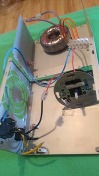

    • Power Supply for Cutting Foamed Polystyrene: Dimmer, 300W, 50Va Transformer, & Kanthal Wire 0.3 IMG_20170322_185103.jpg (3.07 MB) You must be logged in to download this attachment.
  • #16 16364251
  • #17 16368236
    wenar
    Posts: 9
    If he understands well.
    This:
    1. toroidal transformer connect directly to 230VA
    2. And this wall dimmer on one outlet cable
    Deffectly regulate the currents on the secondary and not primary. (I was thinking about it with computer power supplies but it was discouraged because of other frequencies)
    No more fuse for the dimmer, nothing else will test today. I will buy this fuse tomorrow.
    Unless there is another option to play resistance wire safely.
    Added after 4 [minutes]:
    My woman just asked me the question, would you like yellow wires to enter the trafo? All in all, I doubted myself ...
    Added after 26 [minutes]:
    In the attachment the diagram I used.
    • Power Supply for Cutting Foamed Polystyrene: Dimmer, 300W, 50Va Transformer, & Kanthal Wire 0.3 wycstr12.jpg (20.18 KB) You must be logged in to download this attachment.
