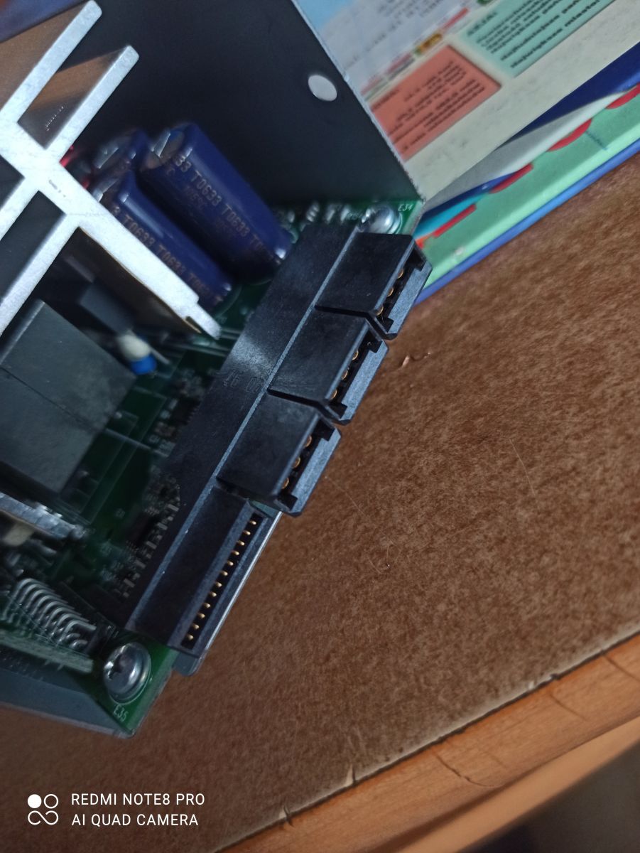

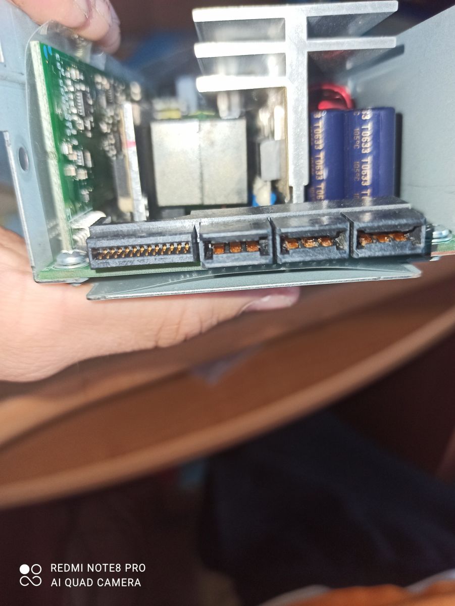

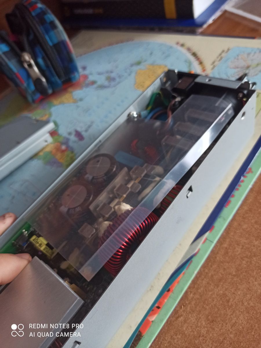

    Hello. I bought this artesyn 7001138 power supply (see photo) and the first thing I did was take off the cover to see what was inside. I noticed this plastic foil (see photo) and I don`t know what to do with it, should I leave it, unscrew the power supply and take it out or what?
    Second question,
    I would like to connect it, but I see that on the side where the pins are located, etc. (where the boards and the place with the pins are) it is made of plastic (see photo). I don`t know if I should download it somehow or should I buy a board with a male input, solder it and insert it into the power supply? (There is a female entrance, see photo)
    Third question,
    To start it, simply connect the power supply cable from the fan side to the mains. Solder pin 3 to 4? Anything else?
    And next to the field with pins, there are three more fields to which you should solder the plus cable and which to the minus one?
    I would really like to ask for help.

    (Here in the photo, you can see that there is also this foil under the tile, a transparent plastic one)
    Leave it and don`t even think about removing it.

    Leave it and don`t even think about removing it.[/quote]
    Ok, I`ll leave it and it won`t melt or something?

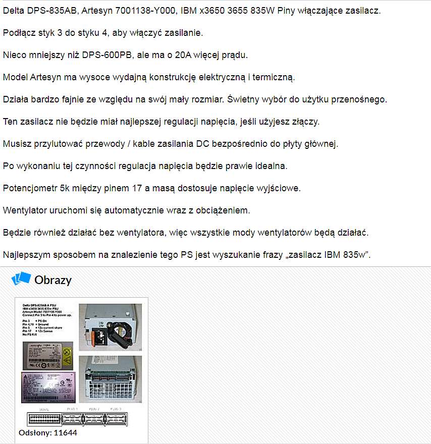

    If you feel up to it, here is a description of how to modify this wonder:
    https://kamboti.unpatti.ac.id/2015/11/19/modi...syn-7001138-for-a-13-5-vdc-69-a-power-supply/
    I still don`t know how to run it on 12v
    • Artesyn 7001138 power supply, foil inside the power supply, connection, a few questions Delta DPS-835AB IBM 835w.jpg (215.12 KB) You must be logged in to download this attachment.

    Thank you. So, solder a wire to pin 3 that I will connect to the switch, and solder the wire from the switch to pin 4? If I understood correctly?

    One more thing, how to remove the plastic housing for the pins and the 3 fields next to it?
  • #8 18955185
    gumisie
    Posts: 17940
    Help: 1667
    Rate: 2486
    These are not "housings", but sockets and appropriate plugs must be used.
    So to get to the tiles I would have to break the plastic? Can`t you download it somehow?
    I still don’t know how to run it on 12V
    So I connect pin 3 to pin 4, but what does pin 5 (ā€˜current share’) mean? If I connect it to earth via a potentiometer, can I adjust the output current? And what does pin 17 (ā€˜sense’) mean?
