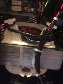

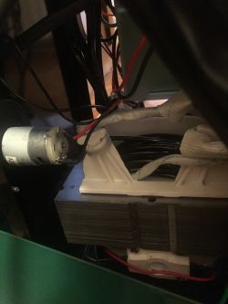

    on a similar sherman mig 130f device, I was able to do it without any problems, in terms of temperature I have already made a fan that turns on immediately after connecting to electricity.
    below photo transformer ;)
    I will give two switches, one = the trigger button on the burner, the other switch off the wire feeder. Otherwise I do not see it somehow ...

    This can be done with one double changeover switch.
